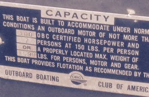

I just got a 1960's Slickcraft SS160 (the Mercury 1000 has a 1965 serial number) and am looking for a Hull Identification Number to register it here in Michigan.
I looked in the normal places (transom / under the water line / on the rear data tag / etc) but can't seem to find anything. The boat has a fiberglass floor with carpet glued down to it (looks original - the boat is 95% complete and all original) so I can't easily see if it is on a stringer or not.
There is a capacity tag rivetted on the boat from the outboard boating club of america but it only lists: max hp / person-weight capacity.
Anyone have luck finding a HIN on the early Slickcrafts?

There were no HINs on recreational boats until 1972. Some makers assigned serial numbers but by no means all. You are fortunate to have one with the old OBC label. Very few manufacturers were members of OBC back then. This will actually save you some grief in some states that want to see a cap label. I don't know if Mich is one of those but having lived there for a short time I wouldn't be surprised.
