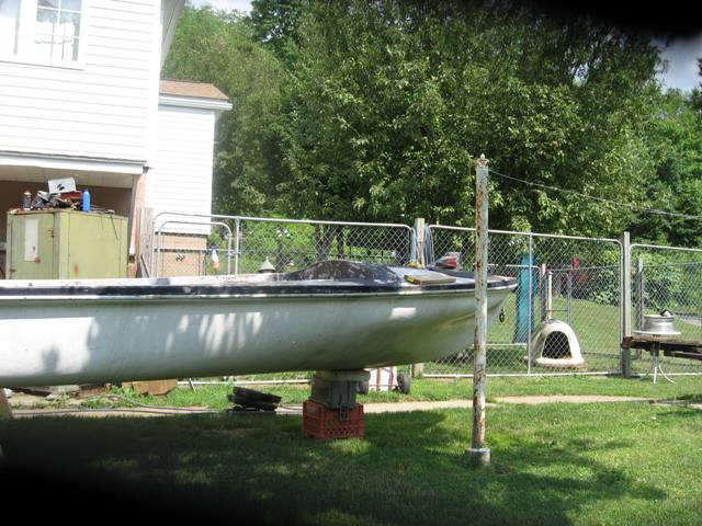

I'm not trying to be funny here, but my boat stand is two towers of concrete blocks with wood on top to support the stern, and another set of blocks with wood to support the keel. Inexpensive, but effective. I used the sawhorses just for stability.
Frank

I lower the front of the trailer to the ground, then build block under the stern. I use a 2X4 to leverage the stern up enough to get wood under in a tight fit. Then I raise the front of the trailer to make sure I have space between the wood on the blocks and the rear bunks. Then out comes my engine hoist that I place perpendicular to the trailer at the front bow winch ring. At this stage, the engine hoist legs are under the trailer. I hook to the ring and lift the boat clear of the trailer such that it is sitting somewhat bow up, so it drains well. I pull the trailer out till it hits the engine hoist leg, and put a set of blocks and wood under the keel. If I need more stability I use sawhorse on the sides in the front as you can see in the pic I posted above.

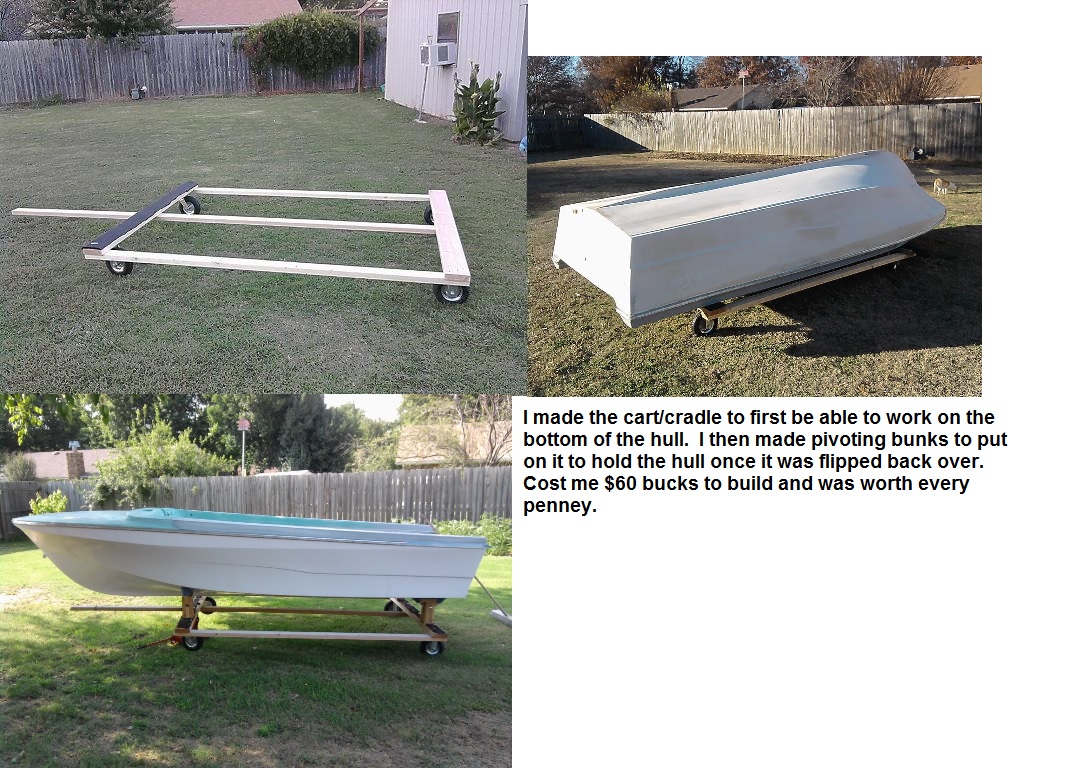

Re:How to build a boat stand? 10 years 2 months ago #124524
Here's the one I made and used...
Click the Pic to Enlarge.
