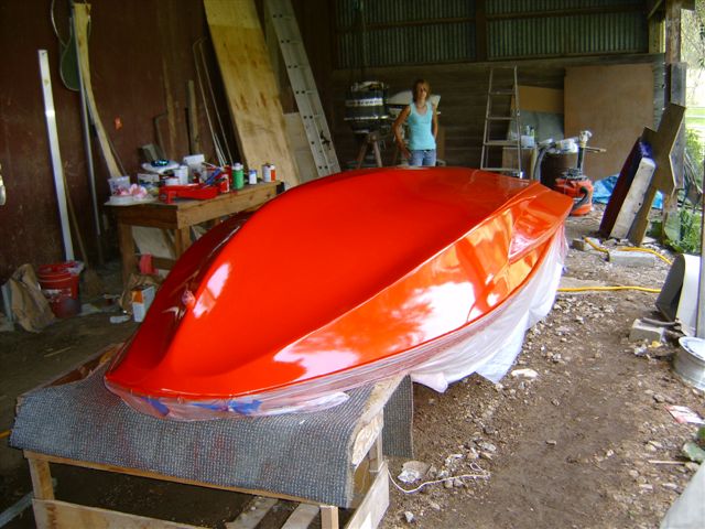

:ohmy: So, I've picked up a 1960 14' Spitfire, dremeled, gouged, scraped, filled and sanded FOREVER, am ready to prime and paint...top and bottom, 2 coats each primer and finish, $913.00 !! wow, I'll never tell her. However, as an ambitious amateur, I need to know, too much?

Have you looked at iboats marine paint? awlgrip isnt that expensive, I use interlux brightside,7 years and I had to buff the top this year,red is a hard color to keep red, even gelcoat fades in red. My G3 cost me about 125.00 2 qts of primer and 2 of the red,some special 333 brushing ajent and some 216 thinner. all in all under 200.00
Re:Su-Preme Spitfire paint costs..yikes! 16 years 3 months ago #12423
Oh ya and I used a 4" foam roller.....no spray gun....over spray. looks incredible
