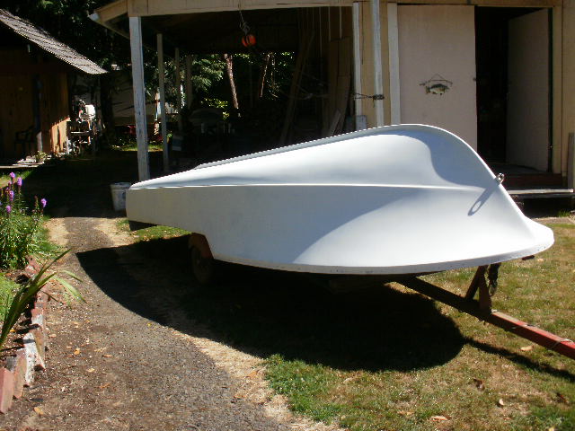

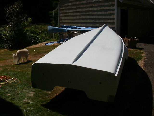

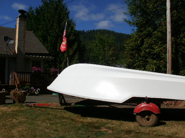

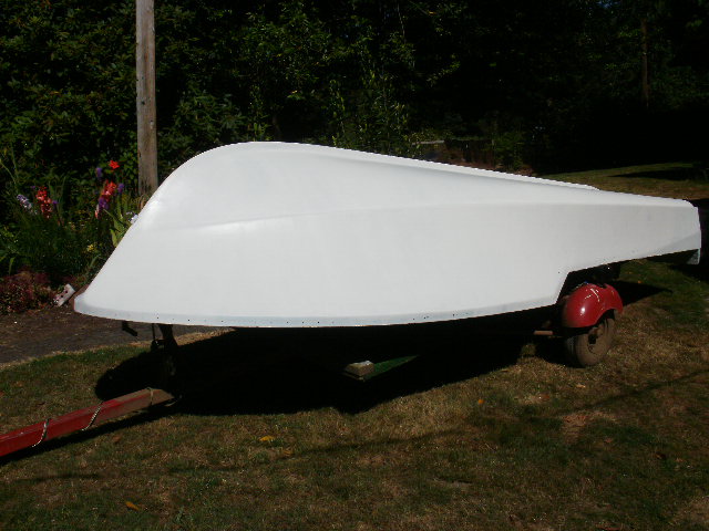

Only two small pinholes showed up with two coats of pre-kote. Now lots of sanding with 320 and she will be ready for final color. Blu-go white Interlux Brightsides. Should have perfect morning weather to do it as it is slightly overcast in the morning and not humid. I'm not even going to consider final till I'm satisfied with the prep of the undercoat. Nice way to recover from surgery. Little by slow she is coming along. Mike in Oregon

That boat of yours is sure gonna be beautiful.

Beautiful Mike!
