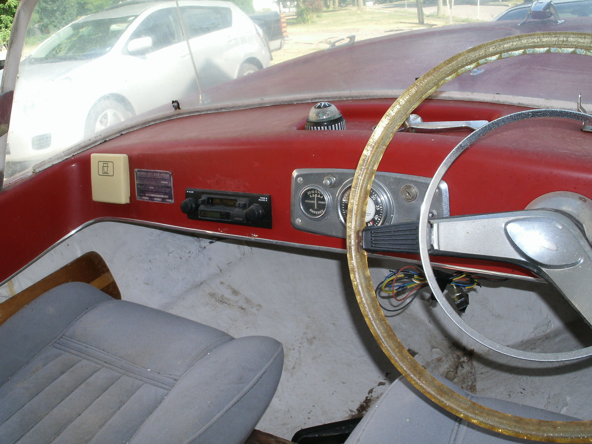

It's been so long since I bought a boat battery that it was before they made marine specific ones. I have no idea how much juice a 1960 Evinrude 40HP can put out but the boat is wired for everything including sound and rear and front cigarette lighters. She has all kinds of extra gadgets that suck power so I'd like to run a dual battery set-up. Any suggestions as to types or makes of batteries that would be best and would an RV voltage regulator system work ?
