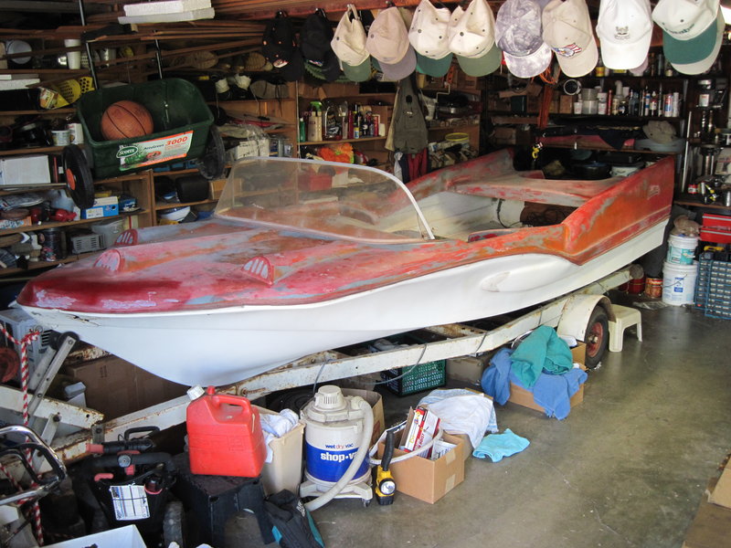

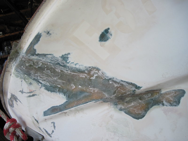

Here are pictures of my RFS Capri #3467. I had to repair a gash in the hull, and this side is now painted.

I can't get the pictures loaded. Wish I had the hard top, would look good with my 58 Ford Skyliner.

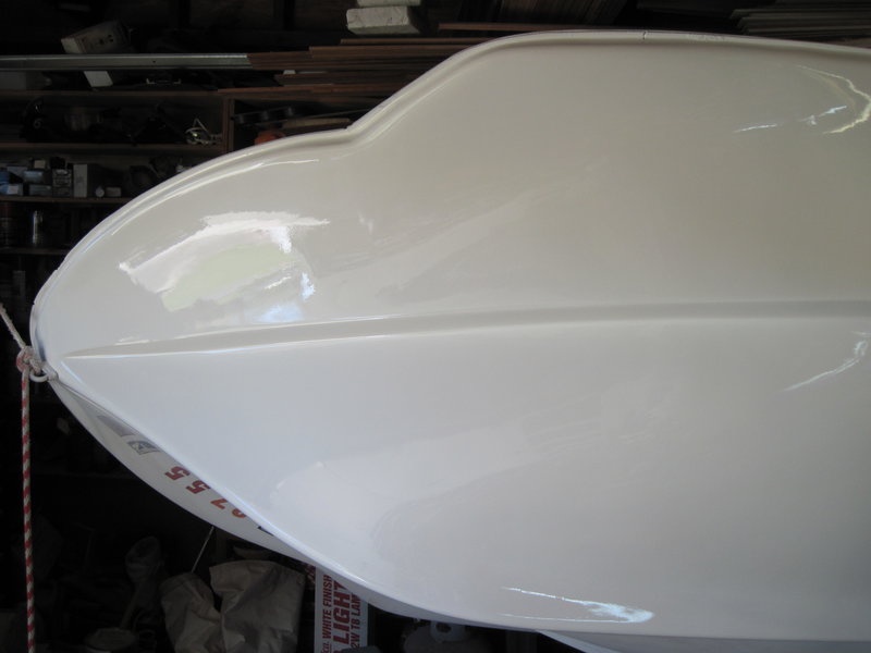

Trying to get pictures on here. Gash repaired and half of hull painted.

Nice looking paint job Tim, if you don't mind sharing what did you use for paint? I'm in the process of restoring my G3 and my Shark.

I used an epoxy primer and paint called K&B SUPER POXY, marketed for the R/C model hobby trade. Unfortunately, it no longer available, but I had just enough on hand to do the hull. There is a product called KLASS KOTE that I understand is similar. They have a good web site for information. My paint job looks just like gel coat, great stuff, easy to spray, no need to rub out.

Thanks I will take a look. Have shot gel coat as well as most single stage and Bas Clears but your job looks like it was a really nice product, of course it may not be legal in CA.

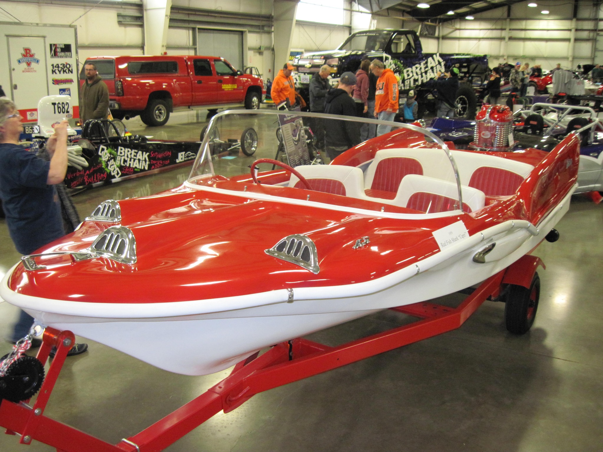

My Red Fish is now finished. Won King of the car show.

Very nice! Having that hardtop convertible Fairlane for a tow car didn't hurt ya none!

How much white & red did you use? How many coats?

Almost a quart each of red and white for two coats each, and 2 quarts of clear for 3 coats, all plus catalyst.

Thank you, looks great! And you've had it out in the sun and water? Is the shine holding up? I'm working on a 14' lake n sea and looking for a finish that I can easily apply myself. I have roll & tipped plenty of varnish, never used a HVLP gun just cans and air brush but It looks easy with some practice. I see Klass Kote has a filler primer and will custom mix colors. thanks,

I just finished it in Jan, and it has not seen much sun and no water yet. Oh, I did tow it for 30 miles in rain from a car show in Feb and it was fine. For the hull i used the white Klass Kote type paint, but used red auto base/clear coat for the deck to match our clasisic Ford.

I know this is old but can you tell me what you did for the rub rail? I'm assuming from the pictures it was replaced
