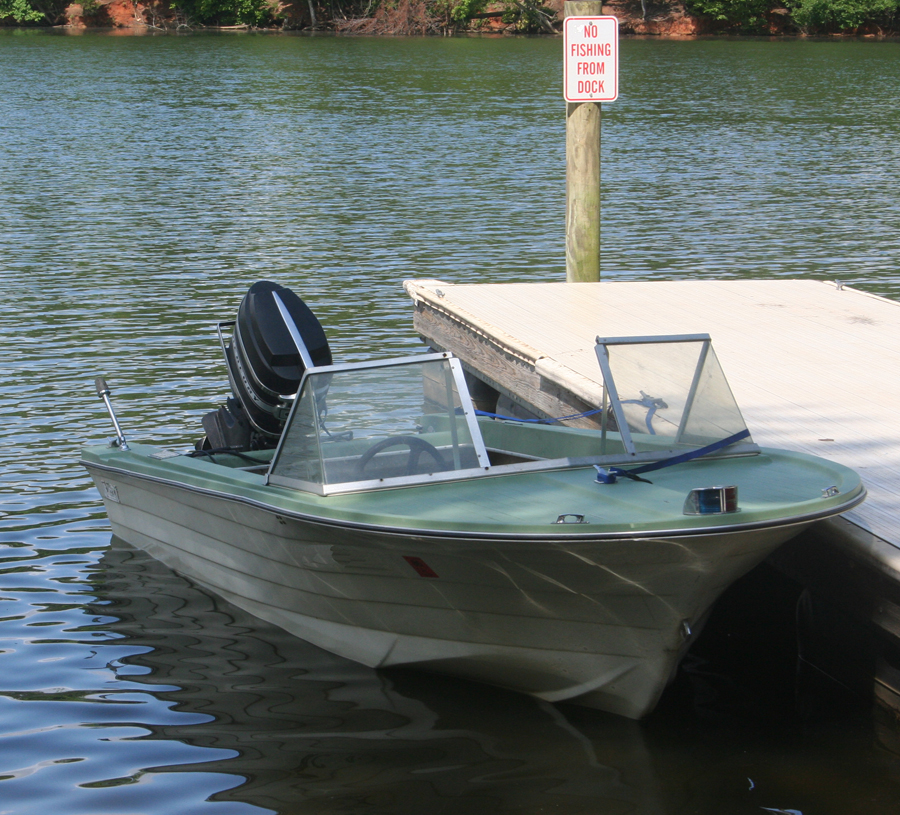

I had 2 5 gal cans cans that came with the boat, but now I need to replace as someone has "stolen 3 gas cans and my dead battery"
I would like to put a 15 gal can - low profile in the back, but is that too big for my 15' Wellcraft?
Since I am unfamiliar with the fuel efficiency, just need suggestions.

Wellcrafted1,
For a small outboard runabout like yours, small tanks are by far, the best way to go. Here are some reasons on this thinking.
Small tanks are portable & can be removed from the boat when it is not in use. This is for theft prevention, and to keep the fuel (a potential hazard) out of the boat when it is stored. If theft is a problem, get a vinyl covered cable & lock (the kind used on bicycles) and string the cable through all the tank handles then lock it. You can also mount a cable eye to the hull to lock the tanks to. When some creep sees that, they will move on to an easier target. But remember, don't store your boat with the tanks in there - it's just not a good idea.
Small tanks make fueling up easier. The best practice is to use all the gas in the tank before re filling them. That way, you know how much gas you put in the can, so you can pour in the correct ratio of oil. It is very difficult to do that with an onboard tank.
If the large tank doesn't have a fuel gauge on it - that doesn't do you much good.
Use plastic tanks, not metal. Metal tanks may look cool and vintage, but they condense water, they rust, and they tear up the floor of your boat. Plastic tanks also allow you to glance at them in the sunlight, & you can see the fuel level making a slight shadow through the plastic. Replacements don't cost much.
I like to use 3 outboard tanks. Two of them are 6 gallon, and one is a 3 gallon. 2 six gallon tanks will run most outboards around for a few hours. Experience will show you how much your engine consumes for a given load & speed. I never plan on using the 3 gallon, I just have it there as backup. Once a year, I hook up the 3 gallon and run it dry to keep the fuel from getting too old. I have never run out of gas doing it this way (knock on wood)

Re: What size Gas Tank? 16 years 3 months ago #12419
Bruce Gerard wrote:
Wellcrafted1,
Sound advice!!
After switching to plastic tanks last year, i wont run anything else. They dont dent, rust or beat the insides of your boat up...easier to carry, easier to see how much fuel you have. Two 6 gallon tanks would be enough for a solid days worth of boating...looks like thats a 65 or 85ish HP Merc?? You could always add a third tank if needed. Walmart sells the stackable Atwood ones for about 25-30 bucks each and they work fantastic.
