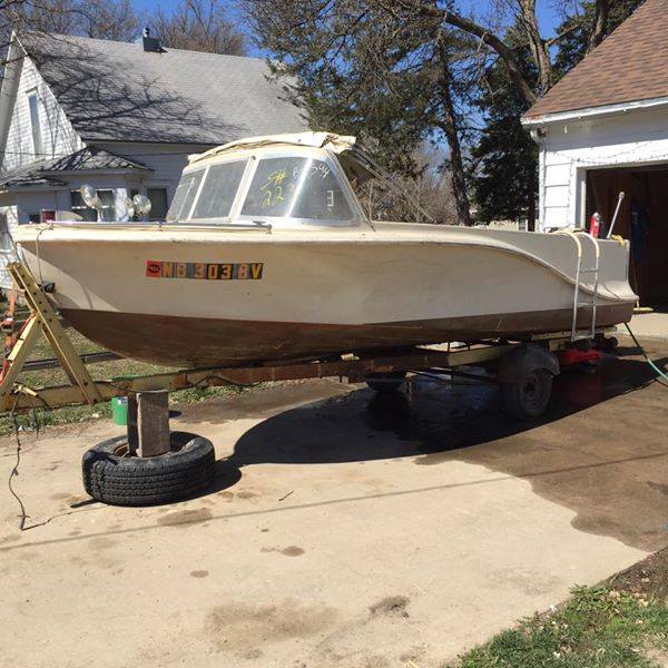

Just wanted to say hey, and introduce myself, and my new project A 1960 Larson Sea lion!
OK, She has some issues. Issues with the motor, and boat itself too.
Time to put the thinking cap on, and take ourselves to school on how to diagnose the issues, and fix them. She is a classic. She wants to run, play, fish, and turn heads too! When we are done, She will be just as, if not stronger, than new and just as pretty, maybe better!
A truly classy lady doesn't need to be flashy to be drop dead gorgeous! (If she can run with the boys, and fish just as hard, that's a bonus!)
My wife and I are committed to giving her a new lease on life!
Photo shoot coming up, I want before, during, and after pictures of the restoration!
“Rose” will float again, and she will be the lady she once was, and wants to be again! Classy,,, a little “Sassy”,,, and full of life!
We are the right folks to help her on this transformation!
Picture here is from the sale add. I'll add some of our own ASAP!

Re:New to thi forum, new project-1960 Larson Sea Lion 10 years 4 months ago #123151
Really hard to tell from the one picture but is that a seam between the upper and lower half? If you have to separate the two halves which I would do make sure you keep it on the trailer and put some type of minimal cross bracing between port and starboard. Some boats will widen out when the top is removed especially if the floor is part of the hull support. Take accurate measurements across at several points and keep a log book. Make sure when replacing the floor that the measurements are the same as when you started because even an inch wider will really screw up putting the egg back together. this I know from experience :angry:
Good luck and take lots of reference pictures.

Really hard to tell from the one picture but is that a seam between the upper and lower half? quote]
I don't know yet. It is a rub rail. I have no plan to pull the upper half at this point! I want to keep her as intact as I can, while I do this. The transom will require some cutting of the splash well to gain access. I'll need help when we get that far! :unsure:

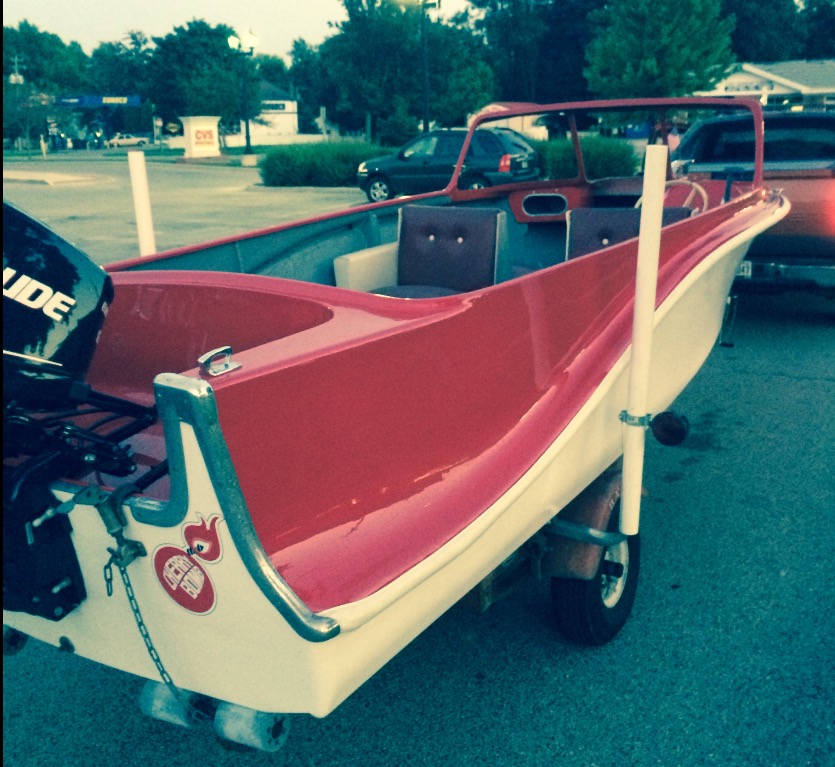

Re:New to thi forum, new project-1960 Larson Sea Lion 10 years 1 month ago #126739
My 61 SeaLion restoration still underway

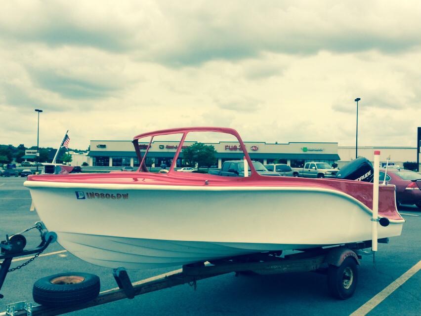

Re:New to thi forum, new project-1960 Larson Sea Lion 10 years 1 month ago #126740
Cherry Bomb

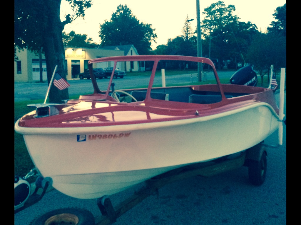

Re:New to thi forum, new project-1960 Larson Sea Lion 10 years 1 month ago #126742
Another pic of my baby

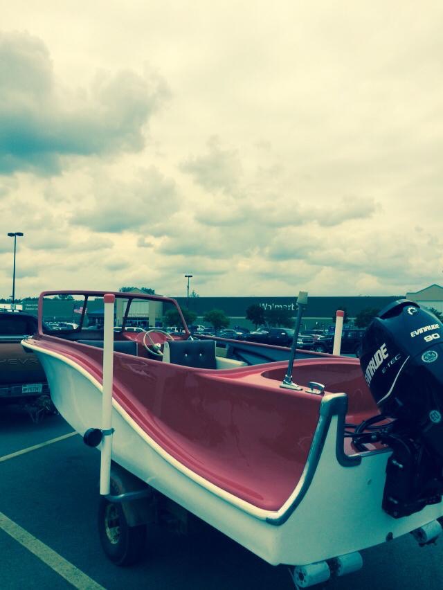

Re:New to thi forum, new project-1960 Larson Sea Lion 10 years 1 month ago #126743
Modern E-tec upgrade from original StarflightII has been a pretty good fit!
