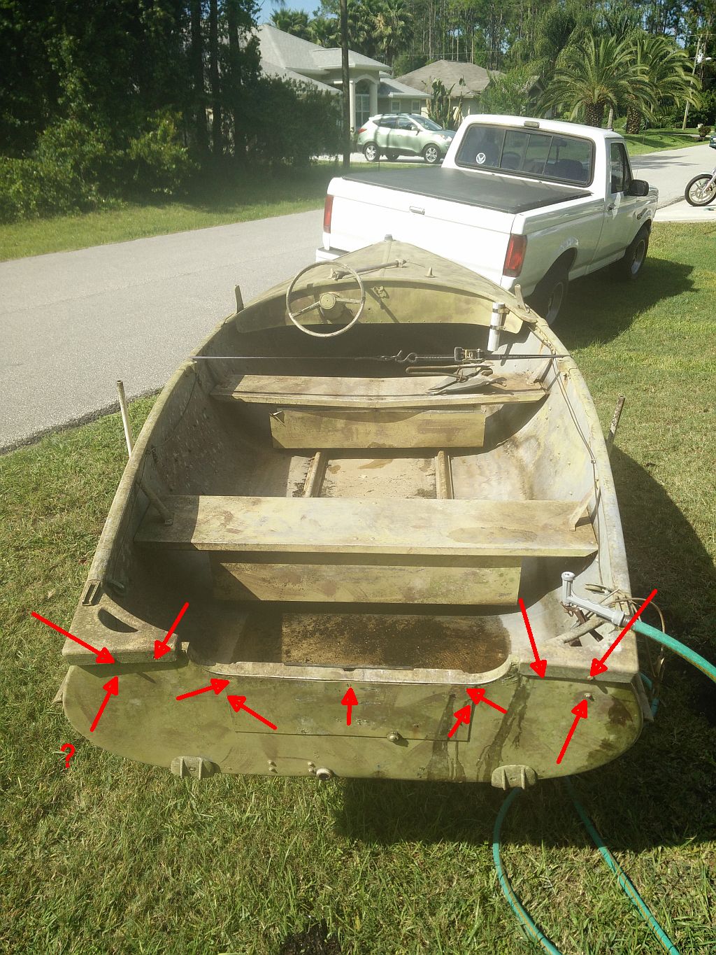

I've been plugging away at the problems on it. I need to rebuild the front seat, rerun the steering cables, replace the steering wheel, and start scrubbing off the bad camo job on it, then finally I'll start repairing the few small holes in the fiberglass.
I'll have to do a little bit of casting for the front seat's repair. Previous previous owner bolted some pressure treated wood into the seat, then allowed it to stay wet. Completely ate away much of the sheet metal of the seat and the bracket itself.
I'm trying to find out the capabilities of the boat. HP rating, load of the boat, how many people it can handle, etc etc. If anyone has that info I'd appreciate it.

From your pics it doesn't look like you have the aluminum transom knee brace. The 1956 and 57 Flying Fish had the knee brace, but it was removed from all models from 1958 on. That looked like a mistake on Herters part to me.

I was planning on pulling the transom off of the boat and inspecting it for cracks, do you know if they were glued on at all?

2. Your boat doesn't look like it had hard use. First check the transom for PO modifications. Then use a straight edge to see if you have less that 1/4 in. bow in it. Finally, check it for cracks. Any cracks should be visible from the inside of the boat. No mods, minimal bow, and no cracks and you are good to go.
3. If you decide to remove the transom I have taken your transom pic and indicated where the aluminum 1/4 in. fasteners are located.

I can't see any modifications on the transom at all, there is an aluminum plate that looks like .063" thick that doesn't necessarily look stock.
The transom definitely doesn't look bowed. My straight edge is fairly old (Grandpop's 24x16 Rafter Square) but I checked it against other items that I know were fairly straight and it came out good.
