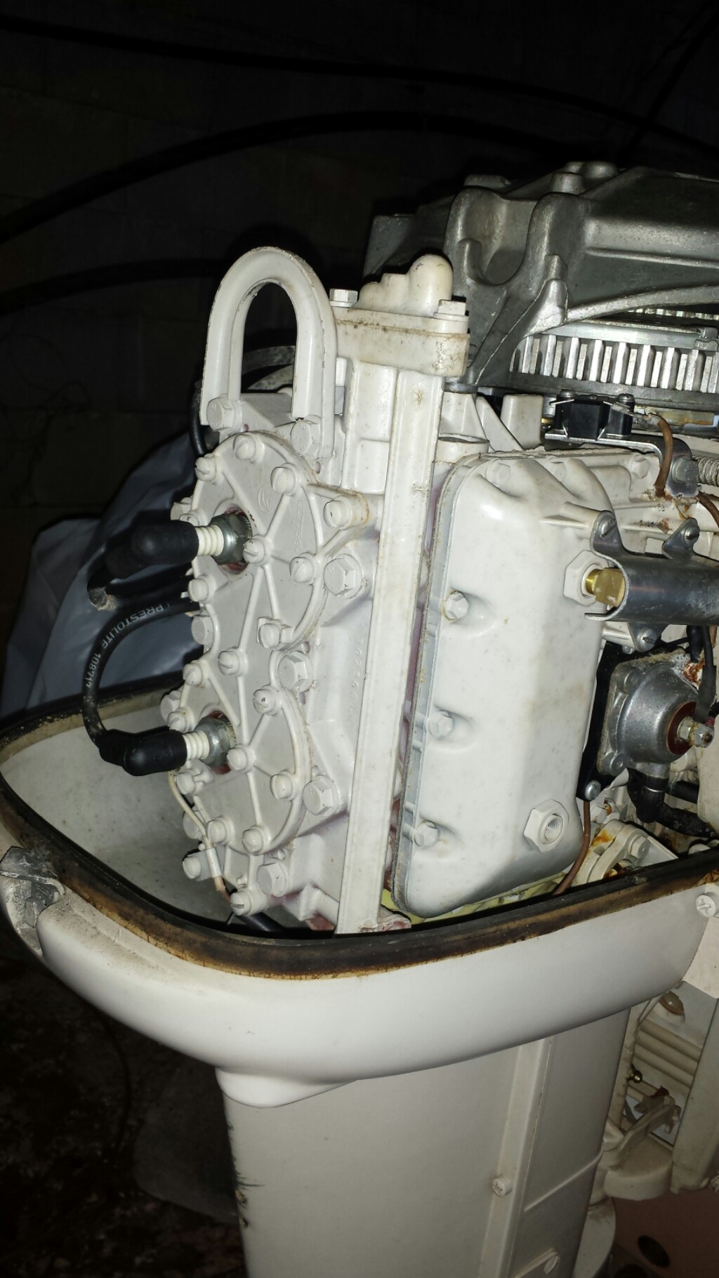

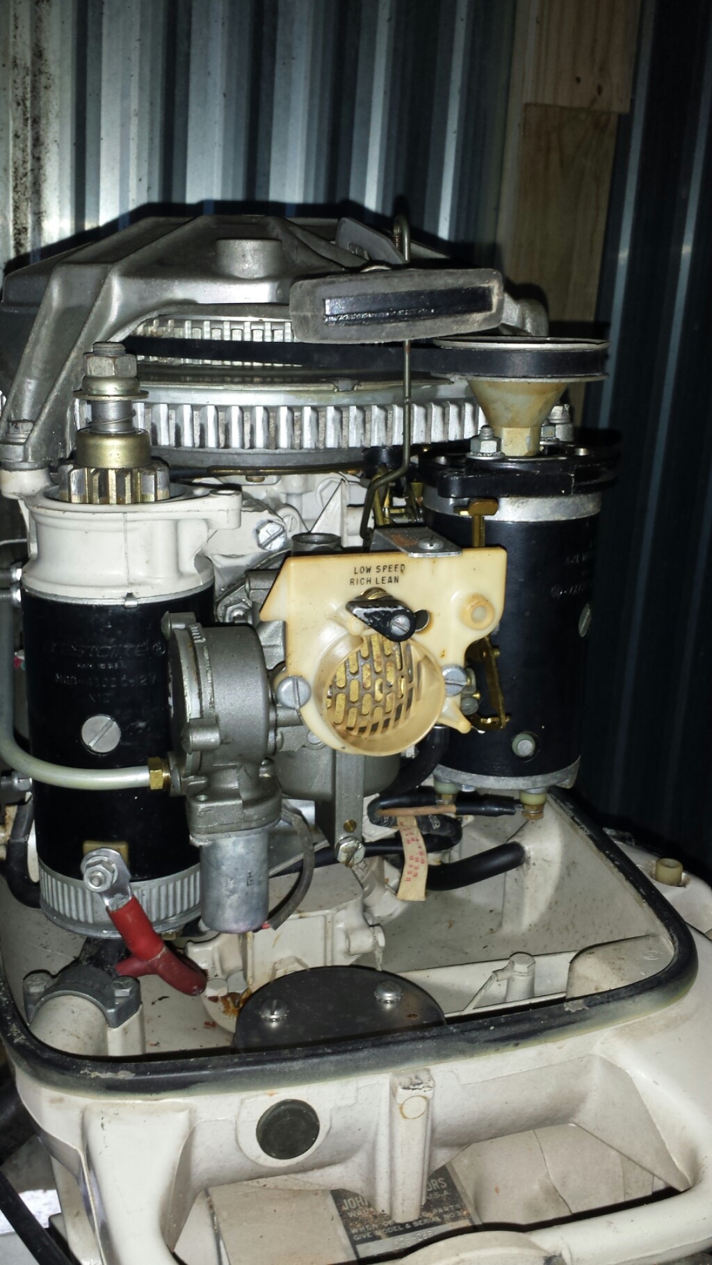

Removed Motor Cover Today, Been 30+ Years!!! 10 years 4 months ago #122286

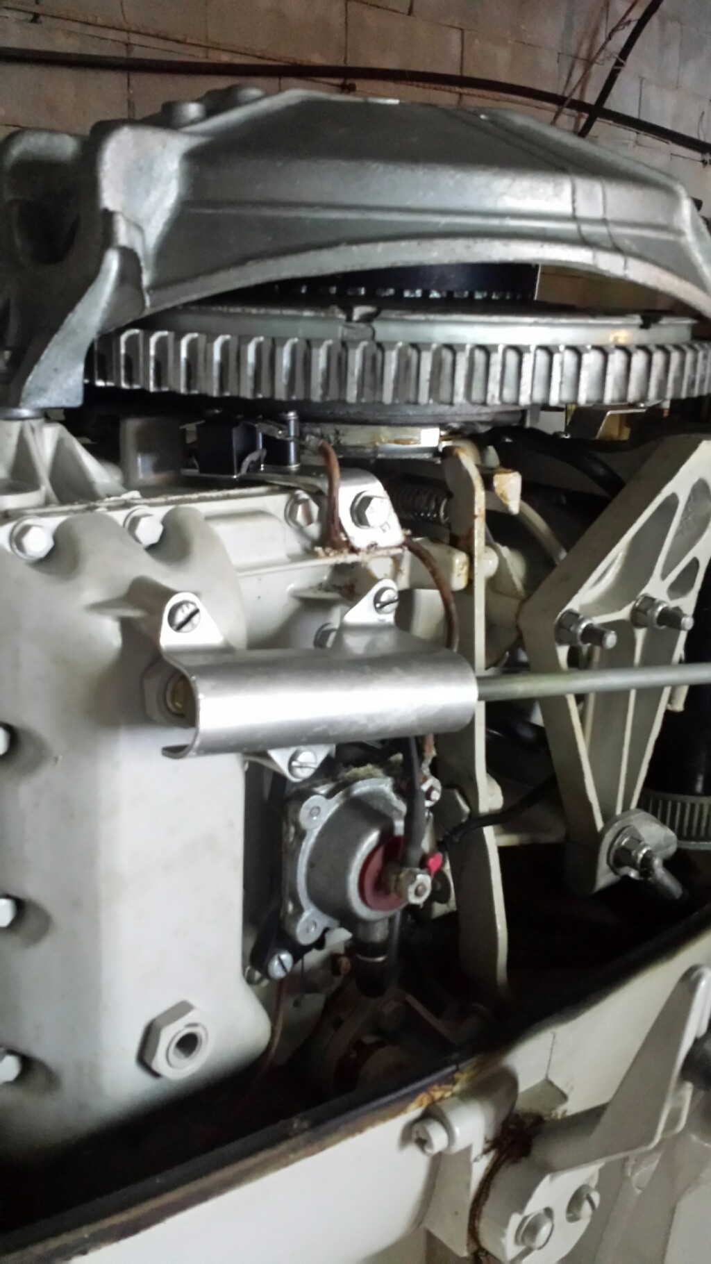

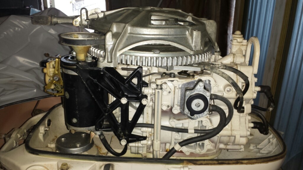

Today I was at the cabin and had a little time to fiddle around with the boat finally. I removed the motor cover for the first time in over 30 years. This is the first time I have ever had the cover off and I can say that I was pleasantly surprised and how clean the motor looked. After taking a few pictures, I got in there, said a little prayer and grabbed the flywheel and gave it a turn and was astounded when it turned and was not seized. I could feel the compression from the motor!!!!! I had so many people tell me that after sitting for so many years, the motor was probably seized up, so you can imagine how happy I am to now know that the motor is fine!!! Now on to the next steps. Haven't pulled the plugs yet to check their condition, will do that in the near future. So, now I need some pointers on what to do next. Change lower unit oil? Clean the carburetor? Step by step, hopefully not long until I get to hear the motor run!!!! Here are a few pics.
I tried to upload a video of turning the flywheel and turning the motor with the pull start but I can't seem to get the video to load.

Re:Removed Motor Cover Today, Been 30+ Years!!! 10 years 4 months ago #122289

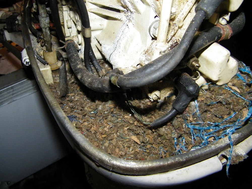

Beautiful
Every old boat I get with outboard motor has the motor hood FULL of smelly, yucky mouse nests. Every single one!

Re:Removed Motor Cover Today, Been 30+ Years!!! 10 years 4 months ago #122294
Andreas, you stole my line...but I did have one over the years that just had the wires chewed sans the seasonal bedding.
Re:Removed Motor Cover Today, Been 30+ Years!!! 10 years 4 months ago #122308
Wow!!!! When I got the cover off, I couldn't believe it. I had never even had the cover off before and the boat has been sitting for over 30 years in the boathouse. Hope it doesn't take much to get her to sing again.

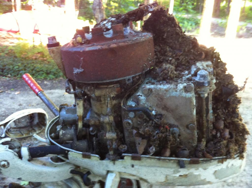

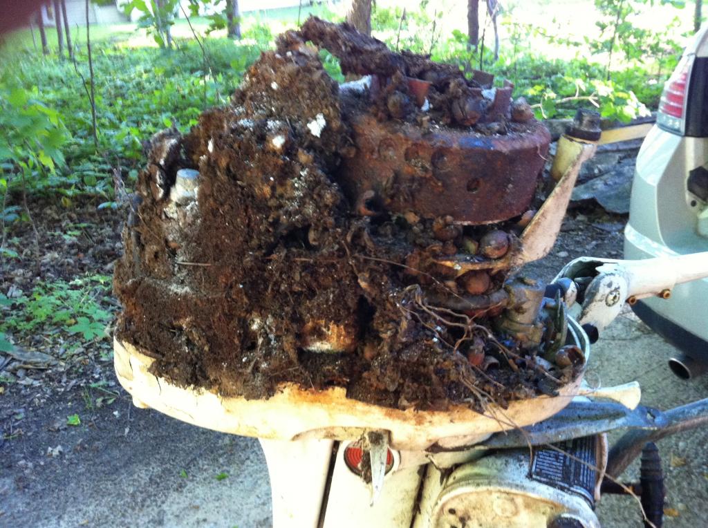

Have to admit thats pretty amazing! Could have looked like this one!
Re:Removed Motor Cover Today, Been 30+ Years!!! 10 years 4 months ago #122336
That looks like a brand new motor! Mine wasn't horrid, but it had definitely hosted a few mice.

I finally got the cover off of my 1964 big twin it was in a barn for over 35 years, the lock broke even after soaking it for a week. the insides looked like cal.s motor, but it is not stuck, it is just a parts motor. greg
Re:Removed Motor Cover Today, Been 30+ Years!!! 10 years 4 months ago #122354
Yeah, I'm feeling very fortunate right now especially after seeing those pictures of those other motors. I didn't know what to expect when I removed the cover. I have no idea if my Pawpaw had possibly prepared the motor for being in storage or if it was just shut off after a boat ride and was going to be used again shortly after. All I know is that he must've really taken care of the motor just like he did all of his things. Cannot wait to move on to the next step in getting the motor running!!! Hard to believe this motor is 50 years old!!!!

Re:Removed Motor Cover Today, Been 30+ Years!!! 10 years 4 months ago #122377
  • Kerry
  • Posts: 675
  • Karma: 51
You asked for input on what to do next, so I'll start, others will chime in. First, before you spin the motor over any more, please order a new water pump impeller and install it. Not a hard job. The current impeller may be brittle enough to break off in pieces which can block passages and overheat the motor. Second, put a pan under the gearcase and crack the fill screw open enough to drip a bit out. If it looks like fresh oil, all ok. Any water or discoloration, change it. Third, get a can of fogging oil. After changing the impeller, remove the spark plugs and spray a generous amount in each cylinder. If you check the starter, spray into the carb as you crank it over. Checking the carb and ignition system will be next in line, just get these basics first. Very important. Best of luck, keep us informed.
Re:Removed Motor Cover Today, Been 30+ Years!!! 10 years 4 months ago #122393
Thanks so much for the advice, input and direction. I will check that impeller first for sure. Some years ago, I had asked my Grandmother about the boat and all she said was that it needed a water pump, but I didn't ask anything more about it. I got the feeling that she didn't really want anyone messing around with the boat. Anyway, I will check it all out beginning with that impeller first for sure. Thanks again and any advice is welcome for sure.
Question: what would be the correct gear case oil and where might I get this and also, what is "fogging oil" and where would I get this also, any particular brand name for each? Thank you. :)

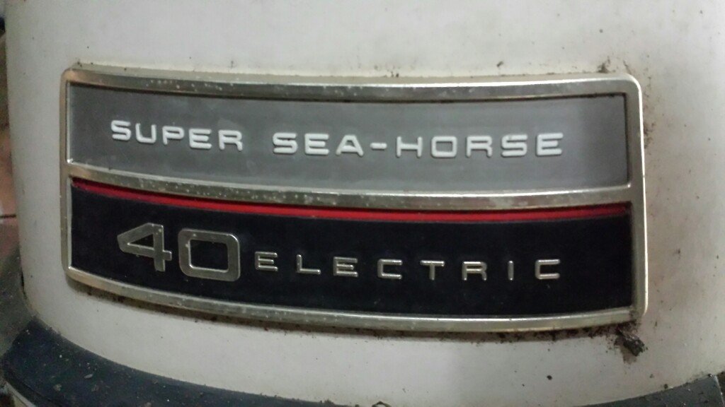

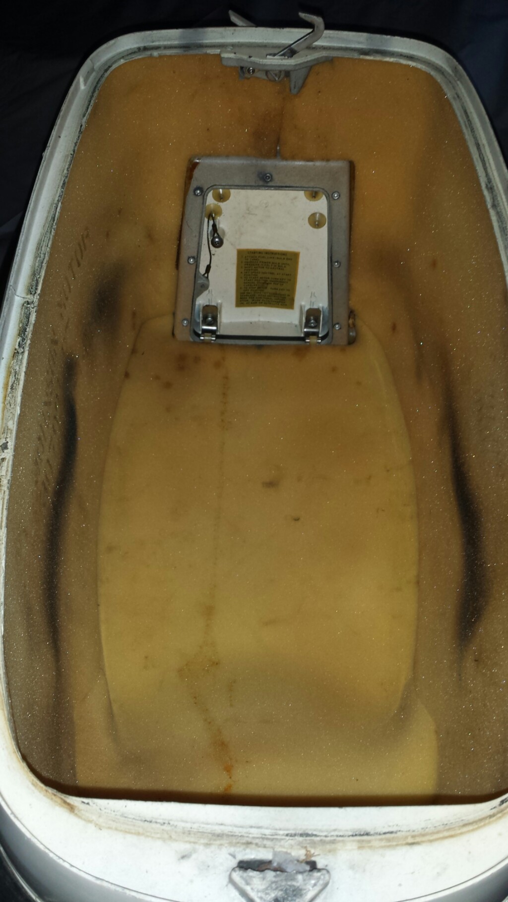

Be sure you use Type C oil in the lower unit. Read the tag inside the hood. The 1965 40 Johnson on my Custom Craft looked very similar when I told the cover off. Is it electric or manual shift?

Re:Removed Motor Cover Today, Been 30+ Years!!! 10 years 4 months ago #122558

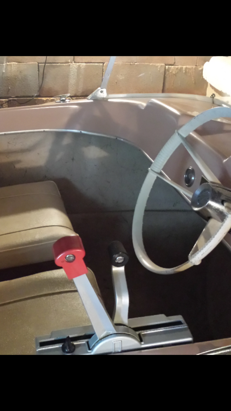

That motor has the manual shift lower unit and does not need Type C which is only used in the electric shift models. Like I said above any good Hypoid 80/90 is fine for this motor.
Re:Removed Motor Cover Today, Been 30+ Years!!! 10 years 4 months ago #122586

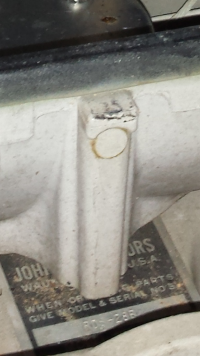

Yes, I would assume it is a manual shift being that there is a cable running to it. It does say electric on the cover, but I assume also that is because of the starter perhaps? It is a 1966 Super Sea Horse and I do have the original manual for this motor, I read it cover to cover, but I will check it all out again.
Question: where would I find a water pump impeller for this motor?
I just looked at a picture that shows the model number or serial number and it says, "RDS-28B"

Re:Removed Motor Cover Today, Been 30+ Years!!! 10 years 4 months ago #122590
Here ya go. Upstanding company you can't go wrong less than $25.
chttp://www.marineengine.com/parts/johnson-evinrude-parts.php?year=1966&hp=40&model=RDS-28&manufacturer=Johnson§ion=Gearcase+Group

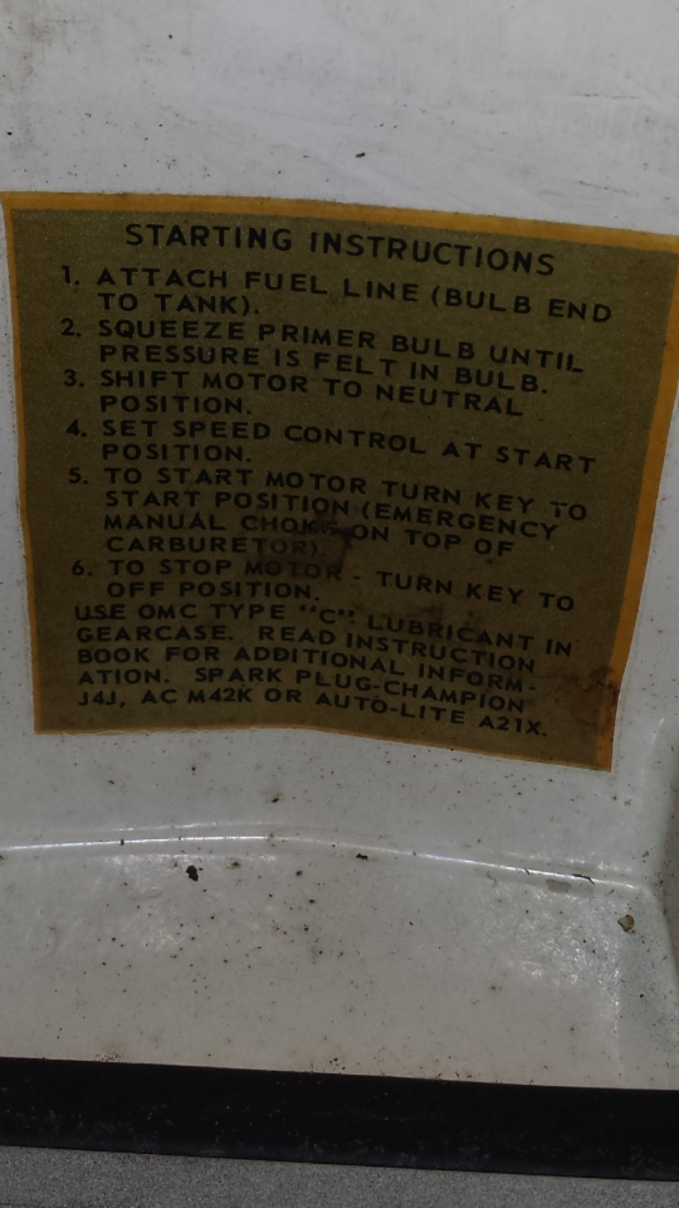

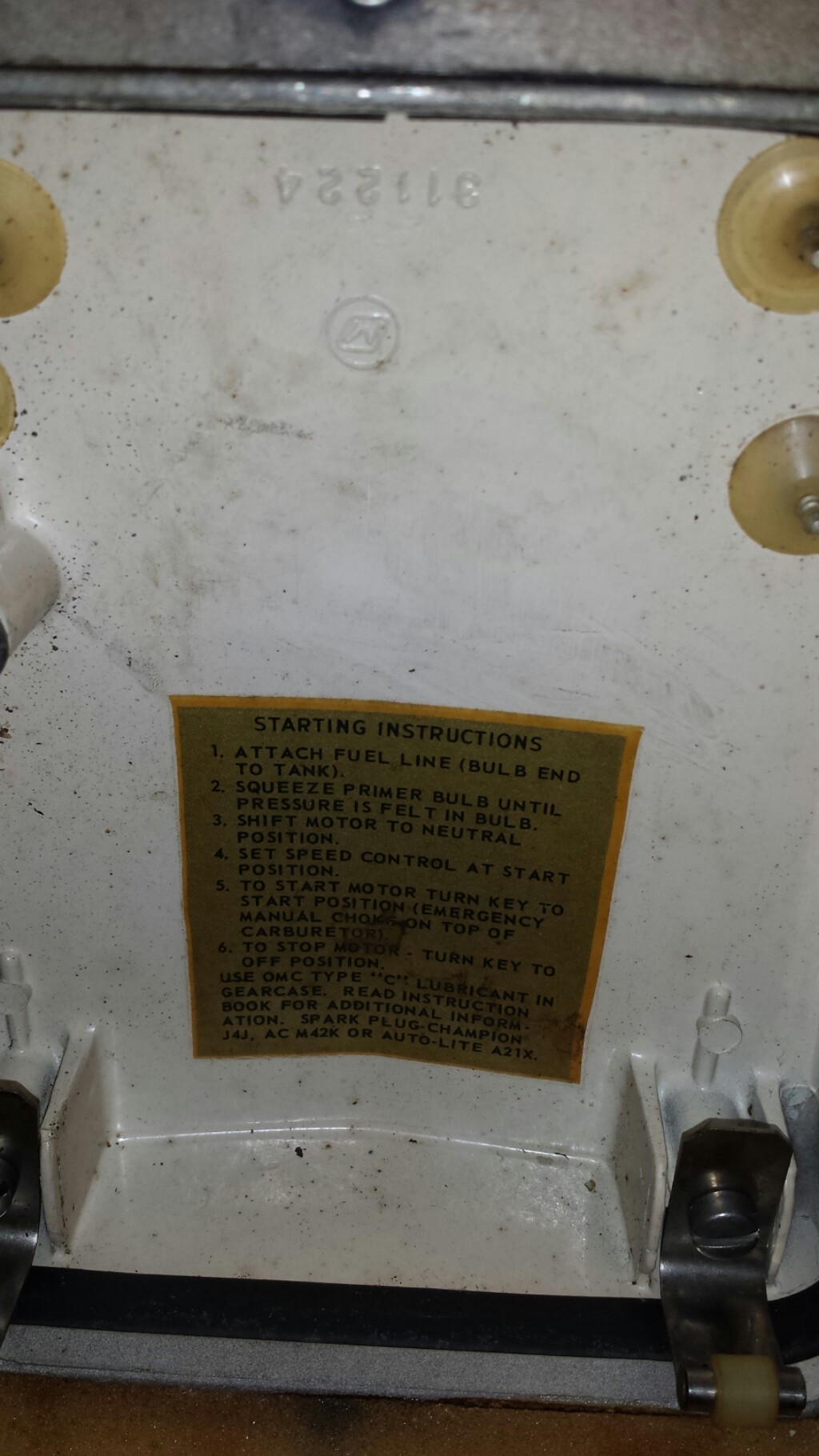

The tag under the motor hood does say use Type C
Todd (aka thetudor)
1964 Custom Craft Aqua Ray
1959 Glastron Seaflite
1959 Tomahawk Spirit
Re:Removed Motor Cover Today, Been 30+ Years!!! 10 years 4 months ago #122673
Yep, you are correct, it does say to use type "c". What exactly is type "c"?

Re:Removed Motor Cover Today, Been 30+ Years!!! 10 years 4 months ago #122676
  • ed-mc
  • Posts: 1472
  • Karma: 235
  • Thank you received: 130
Pawpaws Boat wrote:
Yep, you are correct, it does say to use to use type "c". What exactly is type "c"?
The tag under the hood is wrong. Or maybe it's a hood from an electric-shift motor.
The gear oil recommended by outboard mfrs for older manual-shift lower units is commonly known as "Hi-Vis" or "Marine Grade".
This lube has special additives to promote mixing of any water that might find its way into the gear oil via leaky seal, etc. It also has corrosion-inhibitors for that purpose.
And yes, you could use standard 90W hypoid gear oil in a pinch. But automotive oil doesn't have the additives and if you were to run for a long time with water in the L/U, there's no extra layer of protection. That being said, in a L/U that's not getting water in it, it'd be perfectly safe to run automotive gear oil.
Hi-Vis is better for marine use, and not that $pendy if you pick up some in the Marine section at Walmart or most auto parts stores. NAPA typically will carry Sta-Lube or some other aftermarket brand of Hi-Vis.
Johnson/Evinrude "Premium Blend Gearcase Lube" would be the current oil that is recommended for electric-shift L/U's, BTW. J/E sells a "Hi-Vis" lube as well.
If you pick up a quart bottle of lube, it'll be more than you'll need. In the same display you'll probably find a small hand pump that screws into the quart bottle, highly recommended! Much better than "tube of lube", which is a miserable way to try and fill a larger L/U with gear oil.
www.walmart.com/ip/Super-Tech-80W-90-Marine-Gear-Lube-1-Qt/16928007#about
www.walmart.com/ip/Shoreline-Marine-Lower-Unit-Lube-Pump/35259578
HTH..........ed
Re:Removed Motor Cover Today, Been 30+ Years!!! 10 years 4 months ago #122712
Well, all I know is that this motor was bought new so the hood is original to the motor.

Re:Removed Motor Cover Today, Been 30+ Years!!! 10 years 4 months ago #122943
Post a picture of the hood and the controls. Also, there is a model number of the tag. Post that as well. Let's answer this once and for all.

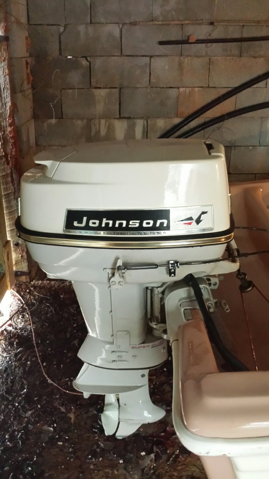

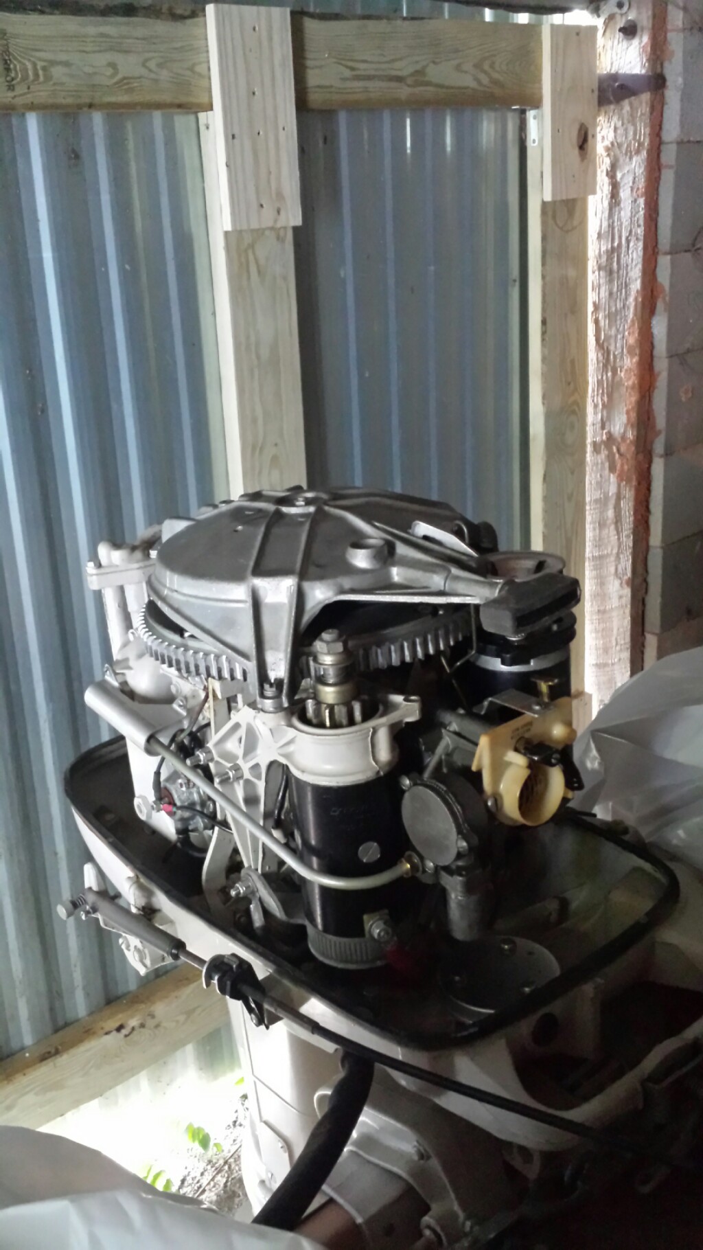

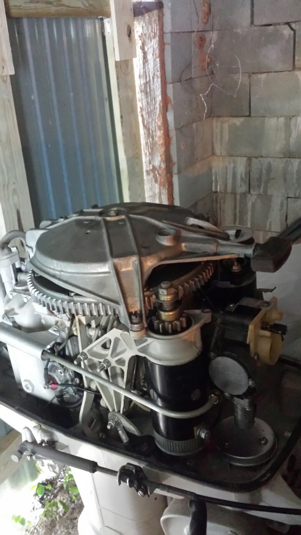

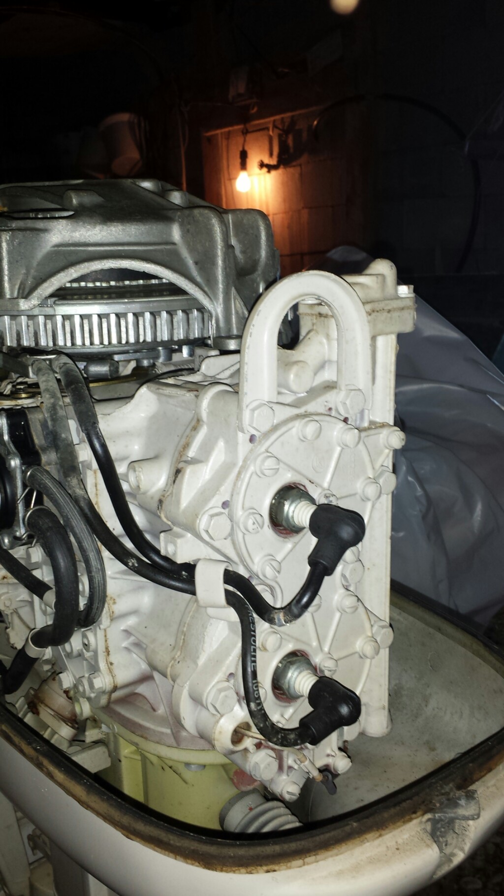

Re:Removed Motor Cover Today, Been 30+ Years!!! 10 years 3 months ago #123277
Okay sorry I haven't been on here in a while, been tied up with work, beach trip to Destin, Fl, and a family member's wedding. Fun stuff except for the last in the list, real circus there. Anyway, here are some pictures of the hood from the motor. Also, pictures of the Johnson Ship Master controls. Here is also a picture of a tag that is on the front bottom of the motor under the hood, it reads RDS-28B. The motor was purchased from a dealer brand new in 1966 and that is really all I know about it. I also have the manual that came with the motor.
Marty
Keeper of Pawpaws Boat
1962 Span America
Re:Removed Motor Cover Today, Been 30+ Years!!! 10 years 3 months ago #123283
  • ed-mc
  • Posts: 1472
  • Karma: 235
Looks like it just came off the showroom! Still takes "Hi-Vis" gear lube in the lower unit.
Since it's all-original, I can only conclude that the wrong tag on the inside of the hood was installed at the factory.
Bottom line, manual-shift gearboxes do not require Type "C" gear lube. HTH.........ed
