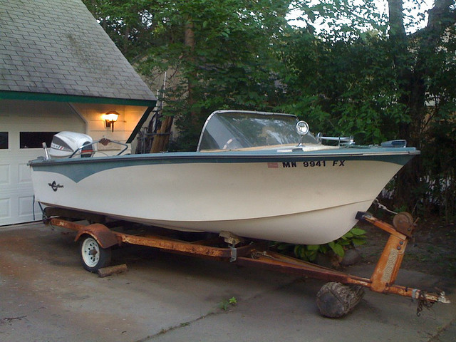

Hello all,
I am jumping into a restoration of a boat. I know very little about fiberglass work in general and the same goes for working on boats.
I am planning on doing a total restoration, and would like some advice about the process. The gel coat has plenty of cracks all over the hull the top deck is plenty faded and cracked. Should I just start sanding away, until the entire hull is smooth, and then paint? Is there a special way to address the cracks? Do you all think that I would need to separate the upper deck from the hull? Or could I get away with just removing the metal band that is covering the seam? How does one go about removing the metal band? Is seems to be riveted in.

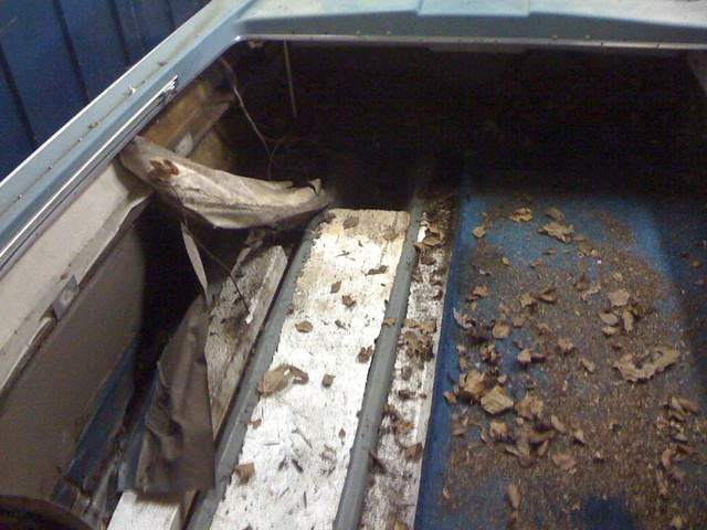

Heres a question for those who know what the stringers are supposed to look like. This is what I found under the rotted flooring. My question is, when I put new flooring down should I just put it on top of these fiberglass stringers as is? Or should there be some wooden support beams in there somewhere?

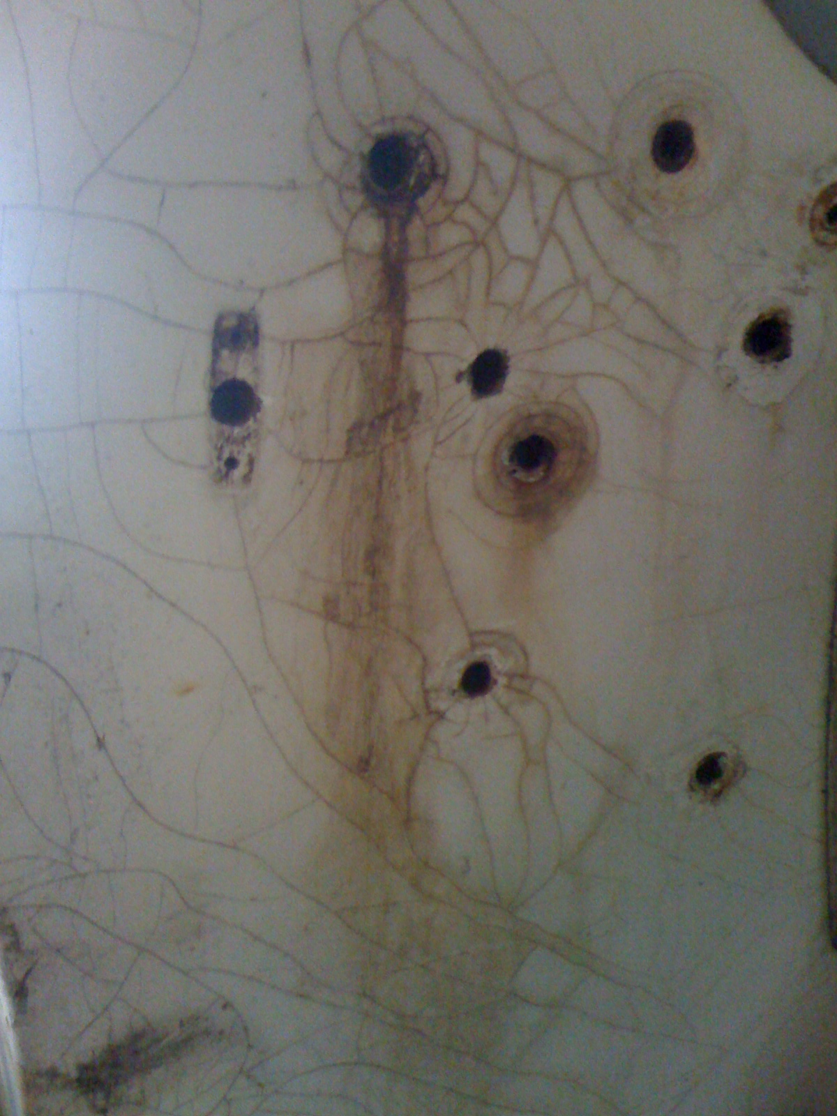

Ok so I have done a lot of reading around here, and I am going to crave out some time to work on the boat.
I want to get to work on the gel coat. It is cracked all over. I want to be sure I am going to be going about this the right way. Based on what I have read. It sounds like I should be going over every single crack with a small cone shaped grinder, then filling with 3M marine filler? Here are a few examples of the cracks I am talking about. Obviously the big ones need the grinder treatment, but should the smaller crack get the same intensive treatment? or can I sand those ones out?

Re:Crestliner Del Rio restoration underway 16 years 1 month ago #16833
what's the word on the cracks? are those smaller cracks what is known as "crazing"?
Re:Crestliner Del Rio restoration underway 16 years 1 month ago #16836
The big ones are stress cracks and will require grinding out and re-laminating with glass- preferably from BOTH sides.
The small ones are just crazing and only need to be sanded (80 grit), the areas completely coated with epoxy spot-putty, and primed with a high-build primer.
