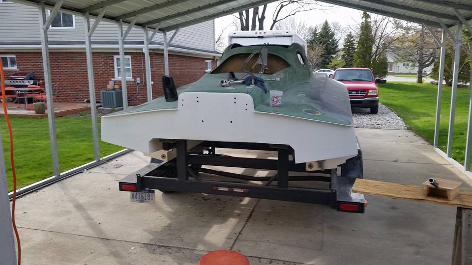

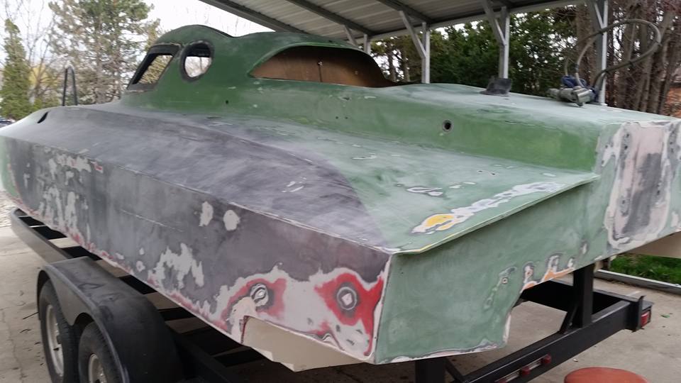

Re:Painting a race boat (Roll & Tipping) questions 10 years 5 months ago #121744
The boat has been sanded, body worked and almost ready for paint.
As you can see from the picture she has been painted more then a few times by the previous owner.
I'll test paint the transom first, its a transom so if it turns out poorly I wont lose much sleep.
Step 1: Primer
* surface has been sanded 180 then 320
* cleaned with a 50/50 mix of Mineral Spirits/Acetone.
* Primer Coat will be Rustoleum "clean Metal Primer" in white.
* I'll roll on the first coat, straight Rust-oleum primer with a
High Density 4" or 6" Foam Rollers.
* Sand gently with 320 grit.
* Primer coat 2 - foam roller
* Sand gently with 320 and address any issues that need body work.

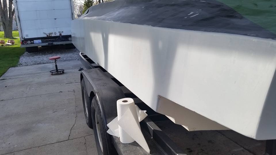

Re:Painting a race boat (Roll & Tipping) questions 10 years 5 months ago #121769

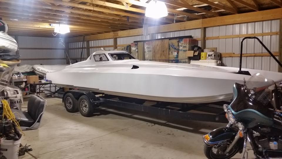

I tested the primer on the transom and got a little carried away, but its all good. The paint laid down as nice as some spray primer I have seen.
I just made sure to roll down never up, than a very light roll to remove any lines. After the paint dried I lightly hand sanded the transom with 320 on a rubber block. I'm really impressed how smooth it looks,
The paint is going to be a gloss, I just linked to the wrong one at lowes.
Majic Catalyst Hardner from TSC

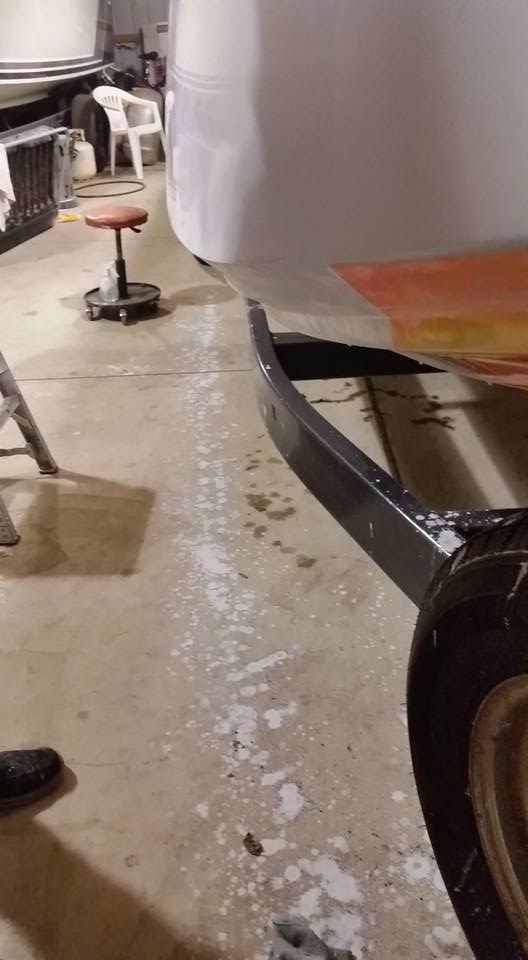

Side picture.. problem is the weather right now. all I need is one 70 degree day and I'll have her primered with two coats and maybe even 1 painted coat...

The weather has been affecting us quite a bit. Looks like you're getting some rain again. I've been holding off on a paint job for over a week now because of low temps. Looks like better days are coming next week.
Looks like a nice job with the primer. Going to be one classiy looking speeder.

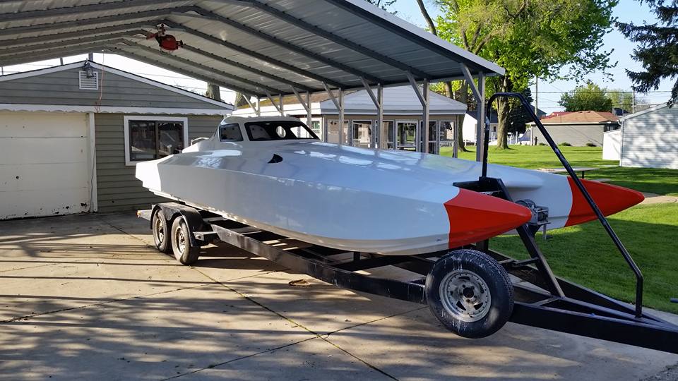

Re:Painting a race boat (Roll & Tipping) questions 10 years 5 months ago #121780
It's YUKA Speedster That I bought last year from the owner of Yuka. It was his personal race boat. I would have painted it last year but US customs really screwed me over with shipping and by the time she arrived the race season already started.
I did run her last summer with the decals and colors that she was raced under in Dubai and Turkey.
Shes 25ft long, race weight is a little under 2400lbs and powered but a Mercury 200xs ROS engine. My best speed was running with my wife in the boat at 105mph and some change. I might have gotten a little better, but I did not want to get to crazy. Normally we race/run with a driver and throttle man. I was doing both.. to much can happen at those speeds so I did not push it.

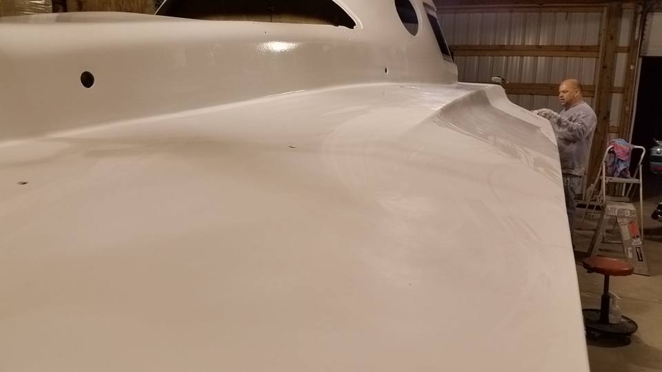

Re:Painting a race boat (Roll & Tipping) questions 10 years 5 months ago #121929

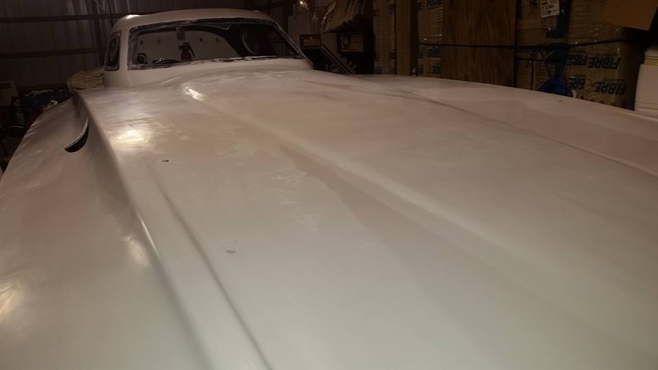

Well so far so good. I did the first primer coat with really nice results. I sanded it with 220 and did a little body work thst was missed.
The 2nd primer coat covered almost 100%. We sanded it lightly with 320. The prime looks great, I don't think anyone could tell it's roller painted.

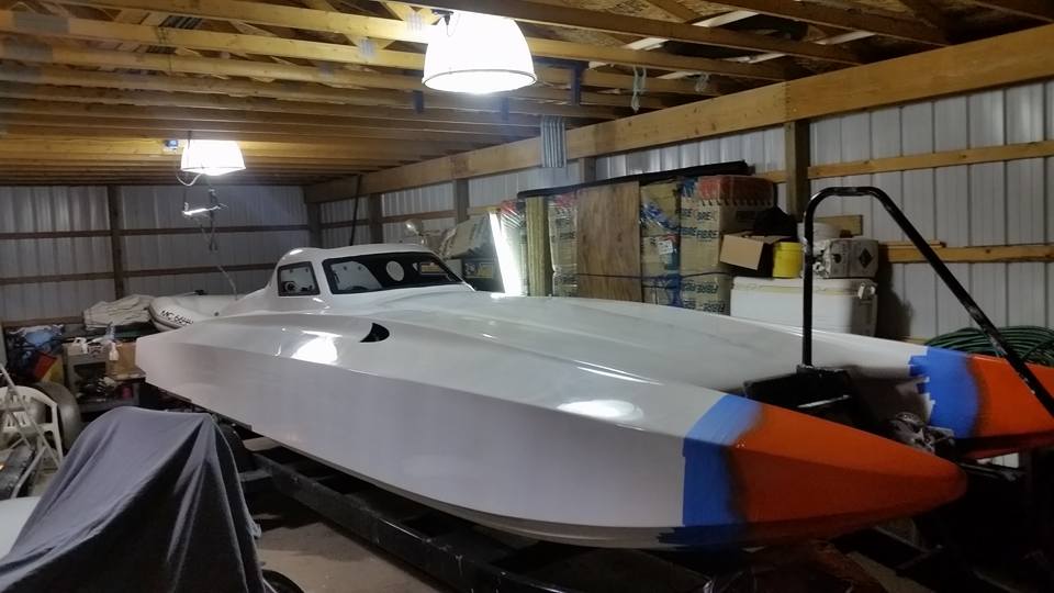

Re:Painting a race boat (Roll & Tipping) questions 10 years 5 months ago #122021
*not the best picture with the lights..
Ok, I tried the rolling and "tip" method with marginal successes. I found it was better to incres the reducer a few % and roll on with a high density foam roller till coverage was good, than roll back over it really soft and slow.
With the roll/tip method I rolled on the paint nice and thing, and would lightly tip it in one direction with the brush like all the videos showed. The brush marks would lay down, but nothing great..
I tried different mixtures, 5 different style brushes (wasted 55$ on) , cheap foam brush and all in between.. The slow roll just worked with this mix/temp I was in I guess..
The "orange" peal is no worse than a rushed spray job..
ended up with 3 coats yesterday. Started early at 8:00am and last coat was finished up around 9:30pm

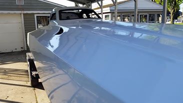

Re:Painting a race boat (Roll & Tipping) questions 10 years 5 months ago #122137

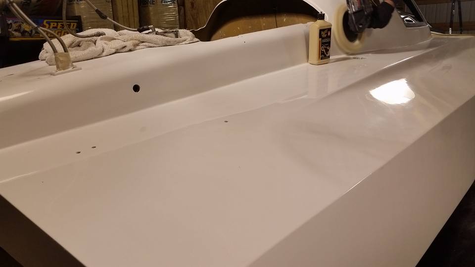

wet sanding is a messy job, but using 1000 grit its turning out pretty nice with minimal effort.
Re:Painting a race boat (Roll & Tipping) questions 10 years 5 months ago #122138
it's difficult to see, but with a little polish it should turn out pretty good.

Re:Painting a race boat (Roll & Tipping) questions 10 years 5 months ago #122190

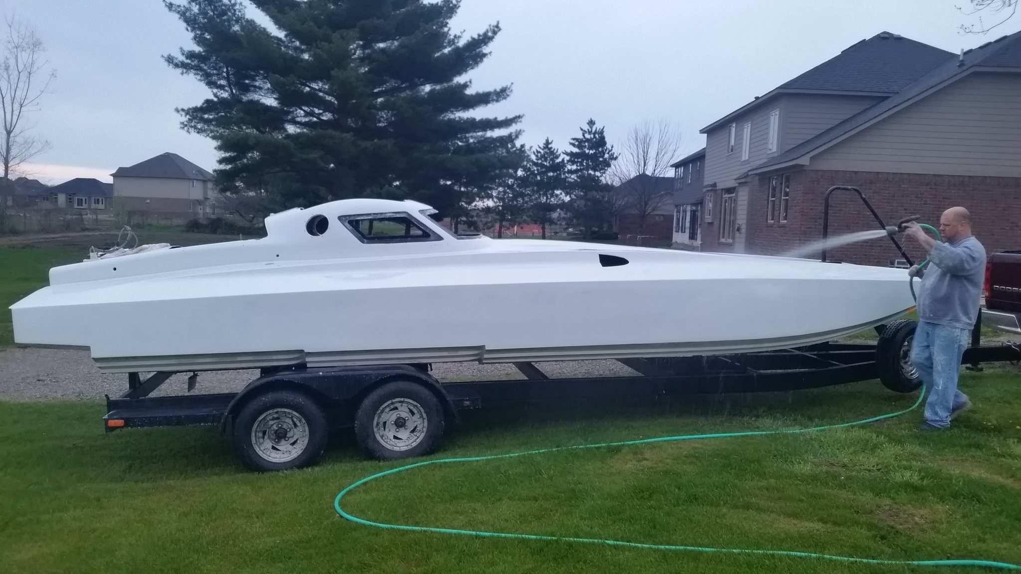

Pretty much finished up the sanding yesterday..
- Started with 320 wet and a foam block (very light)
This removed all the orange peal, bugs and what not. I found talking and sanding will result in a burn through.
- Next was a 600 wet and foam
This cleaned up the small areas left from the 320
- Finial was a 1000 wet with a block
After this step is pretty much done and ready.. I will buff it later next week but over all the roller paint job is a solid 7/10 and for a race boat that pretty good.
- I might try 2000 wet tonight, not really sure its needed..
The paints pretty durable, I did drop a large hose nozzle on the deck that left a dent, but no chipping.
* hard to tell from this pic's but so far so good.

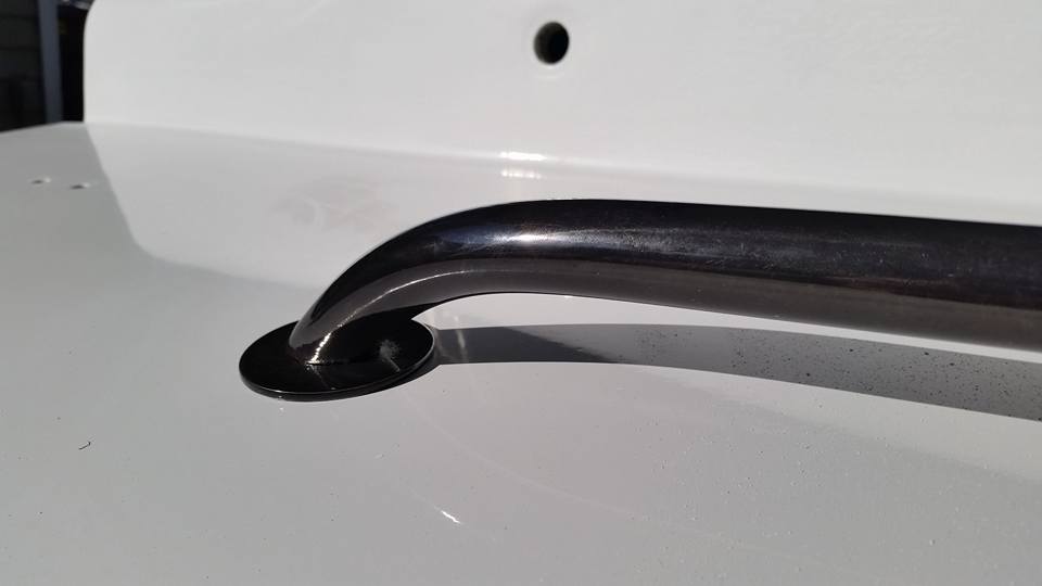

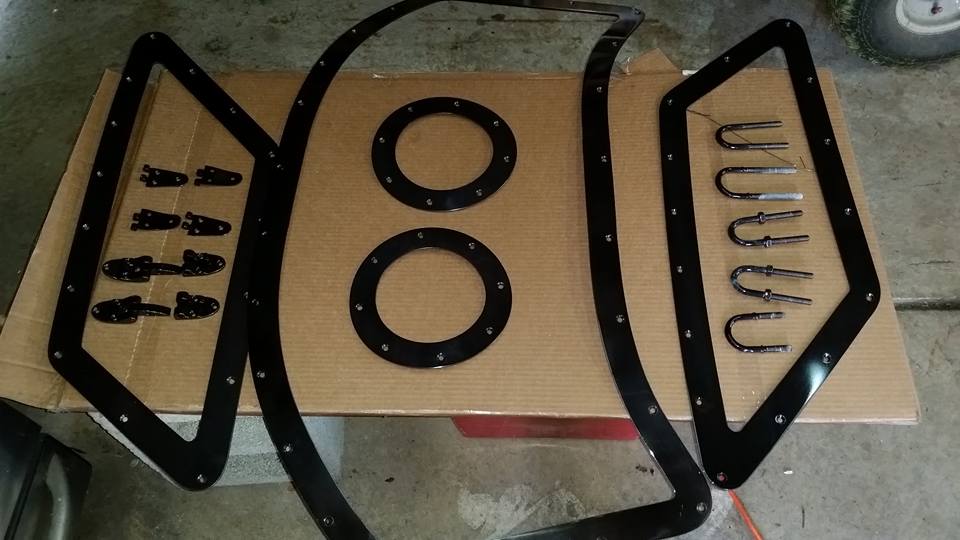

I'll add a couple things.. I had all the Stainless steel rails, hinges, hooks, window rings and other small parts polished out and "Black Chromed"
Hard to see from the pictures, but should look nice later on. I'll be back and post a couple "finished" pictures if anyone is interested.
