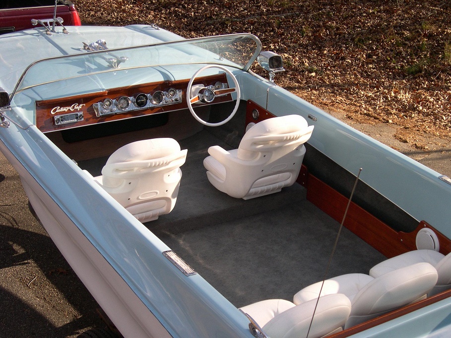

Cal...You might also find this useful. I choose my colors by looking at cars, especially older cars from the 1950s and 60s. If you know the year and the make, you can get the exact match by using this:
www.autocolorlibrary.com/aclchip.aspx?image=1956-Lincoln-pg01.jpg
It's the PPG automotive paint library, which is what I use when deciding colors. Just follow the directions and plug in the name of the color (or any name actually), scroll down to the bottom of the page and you'll see the chip chart for the specific year and model car you plugged in.
I've used Corvette Honduras Maroon, 1965 Buick Riviera maroon, 1956 Chevy Tropical Turquoise, 1984 Maserati white, etc. One of my all-time favorites is 1976 Chrysler (Dodge, Plymouth) Powder Blue. (see photo) Virtually everything I paint is done using PPG automotive acrylic enamel. If it's good enough for fiberglass Corvettes, it's good enough for fiberglass boats.

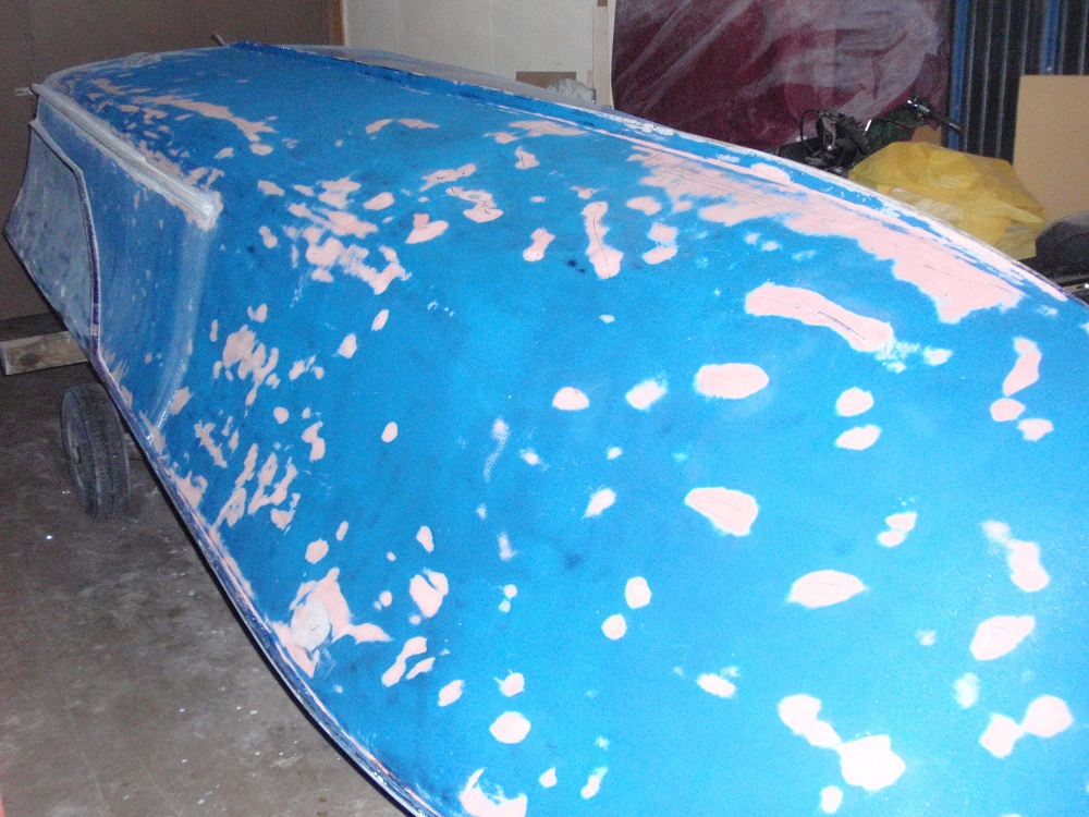

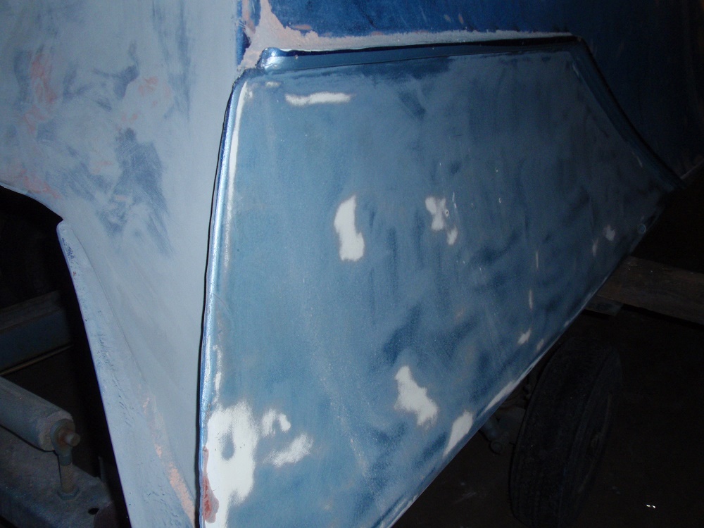

Thought about reversing the colors and putting the coral on top but then decided to keep it original in the sense. Seems like most of the boat manufacturers always put the white on the bottom, gets boring after awhile. Take a walk on the wild side, turn 'em upside down. Maybe that's why Tomahawk didn't sell that many with that color :laugh:
Couple of pics of where I'm sanding, the coral looks more pink in the pictures but it really is a darker shade. You can see the white coming through on the fin area also. Don't try to turn you screen upside down. The boat is flipped.
And yes, I did glass the white oak splash rails you can see in the pics.

Looking great!
I did a 50 Nash in a Coral very close to your choice and used a Ford Wimbleton white on the roof looked perfect together.

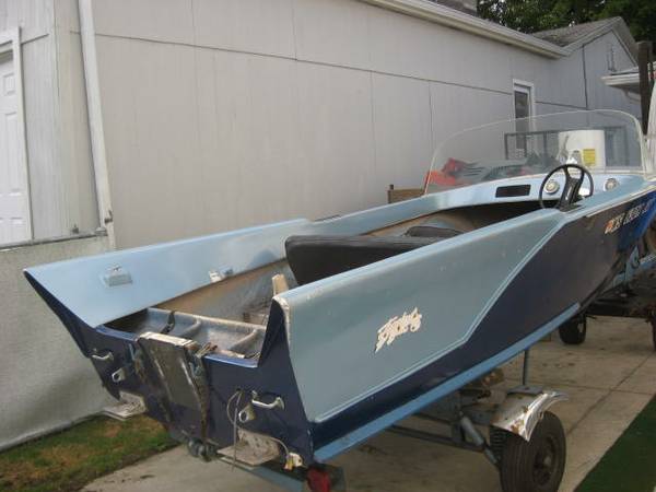

Mr.Cal ,great thread, you really do great work. I'm about to start on my 58 Tomahawk , so lots of great info here. Did you leave the aluminum rub rail on ? If so how do you plan to "shine" it up ? Before or after you paint? Keep pics coming and all info. Also talked with Greg Anderson lots of info there too !!!

Mad, Aluminum rub rail???? what's that? :laugh: I suspected this boat had something on it at one time because there are screw holes in the joining sections. The picture shows how it was on Craigslist, no trim. There was a stick on trim around the bow area, that was a devil to remove, I just might replace with the same type of trim. On aluminum trim that I have shined up seems like Mothers aluminum polish works out the best and easiest.

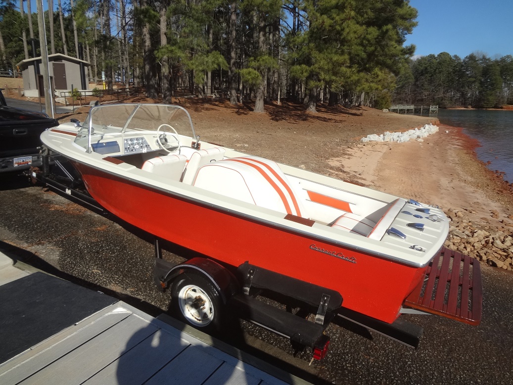

Cal:
Here's a photo of the Correct Craft Barracuda I finished last year. If you squint your eyes a little, you can imagine that the orange is coral and it might give you an idea of what your boat would look like with a coral hull. Also, just about any color other than white will noticeably fade in the sun and be hotter to the touch.
If it were mine, I'd change the coral to peach and do a "peaches and cream" paint job. Chicks will dig it and an ugly guy like you needs all the help he can get in that department. Just trying to be helpful.

Ah HA, You confirmed my suspicions. There had to be some type of rail there. Thanks for the picture. Nice looking '58. What size motor and top end? I'm trading my 135hp rude for a 65hp with Gene to put on there.

What are those seats? I have seen them somewhere but can't place them. Like'm a lot!

Thank you Sir. Really like the look.
