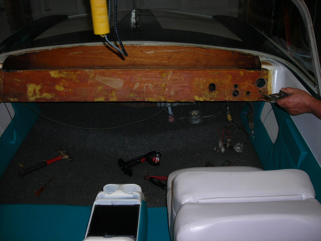

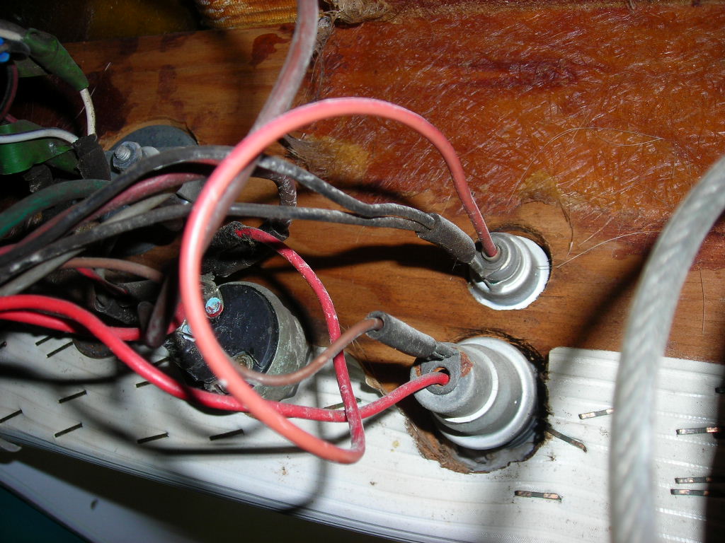

I have a 1969 MFG 170 sprint with a Evinrude 1969 115 115983e I had to undo a bad mess of wires under the dash and now i have not an idea where they go to the ignition and stuff like that I have tach speedo voltmeter fuel guage electric choke the harness has some wires coming from it but not a clue where they go. I could really use some help though. Thanks

floater for your future reference ,i take pics of the area im working on 1st,so its easier to put back together,i usually number the wires too,if 2 wires go together they get the same # on masking tape,if they attach to a switch or other conecction,i also put a number on it too.
also i try to keep them as together as i can,like with the dash im doing now ,as soon as i pull the switch ,or tach,i put the wires right back on ,and let them hang,i do all this without the battery attached .

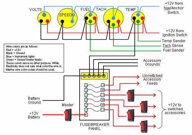

Here is a simple dash gage layout.
Mike aka pathfinderz1
