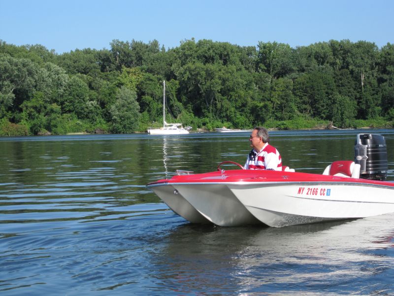

Guess what made the difference? Dave Cummings told me to getting rid of the OMC 5/16 fuel connectors and go to 3/8 connectors and line. Got up to 4800 rpm on a 3 blade 19P aluminum prop going downstream in the Hudson River, but against an incoming tide. Trim tabs were off. Was by myself, but could not duplicate the run with my wife aboard. She's not much into WOT, so for the most part we took it easy. Still couldn't trim out at anything below that WOT run in the video without porpoising. We went about 20 miles all together on about 6 gallons of gas, but plowing water most the time. Thought I had left the gps at home, discovered it in the boat when we got back to the launch, so no mph stuff, but I was going faster than before, no question about it.
Next trip, a 17P prop, and trim tabs.
This is the closest I've gotten, and man o man, what a feeling for a minute or two! More to come.
Frank
Big test. Serious enough?
Getting ready for the run...
The run -

Nice run, Frank! Obviously more speed is the ticket to getting rid of the porpoising. Still more "up" trim than you should need, but getting closer. Might want to think about a setback plate over the winter. Moving the motor away from the leverage point makes trim more effective and responsive to small changes. Ideal trim is bow slightly up with motor at or slightly above level.

Kerry, I've always driven boats with trim by feel. This was my first successful attempt, and I didn't know where the motor was till I saw the video Gail took. I'll be switching props and testing more and will keep y'all posted.
