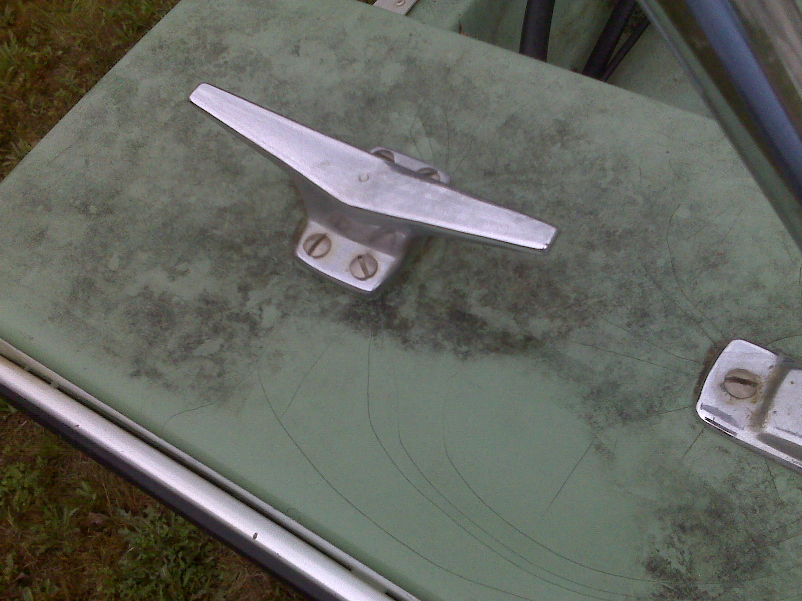

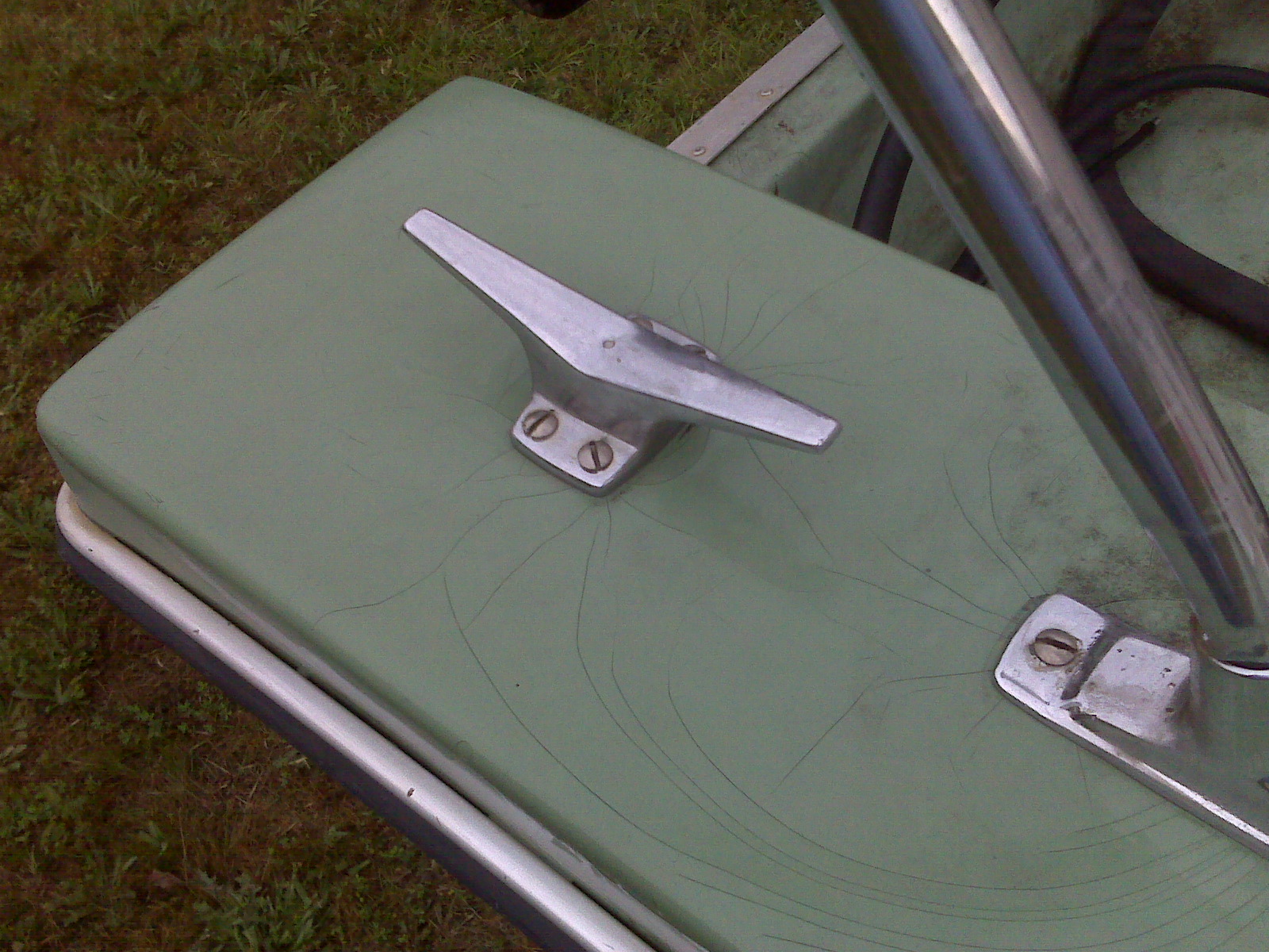

I have cleaned the top, has a few, OK (alot) of fine cracks from years of neglect. I have wet sanded by hand, and need to know whats the next best step.
I still have cracks but does it need to go all the way down to the fiberglass? Or can I sand very well, then use a filler, sand then clean, wipe down? It should be ready for paint then. Right?
I am just preparing to enjoy the labor, as I can visualize this Wellcraft in the water.
Thanks for any advice.
Re:Preping for paint...... 16 years 3 months ago #11854
You will have to grind the cracks down to the fiberglass with a gringer or a dremal tool. Then lay a little fiberglass resin/mat in the grooves and smooth them out and prime before sanding. If you putty over the cracks they will come right back as the boat flexes on the water. It's a time consuming job and a lot of effort, especially if the boat is loaded with cracks, so make sure it's a boat you really want. lol
Re:Preping for paint...... 16 years 3 months ago #11866
What Doug said is so. If you don't grind the cracks - which are in the gelcoat - down to the top of the resin/mat that's below the gelcoat they'll just come right back.
Another thing you can do is sand the gelcoat down to remove any soft spots or loose material, then apply a layer of thin cloth - 1.5 oz for example - over the top of it. You then sand the rough spots off that layer of fiberglass and resin - apply filler primer to bring up the level and cover the new cloth - then fair and paint.
That pretty much eliminates the chance of cracks re-appearing anytime soon.
