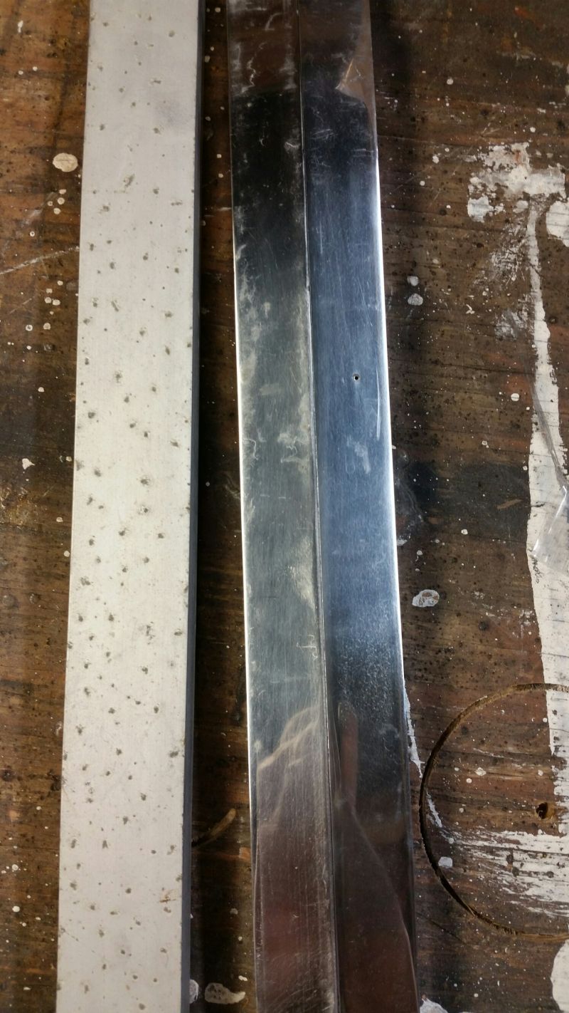

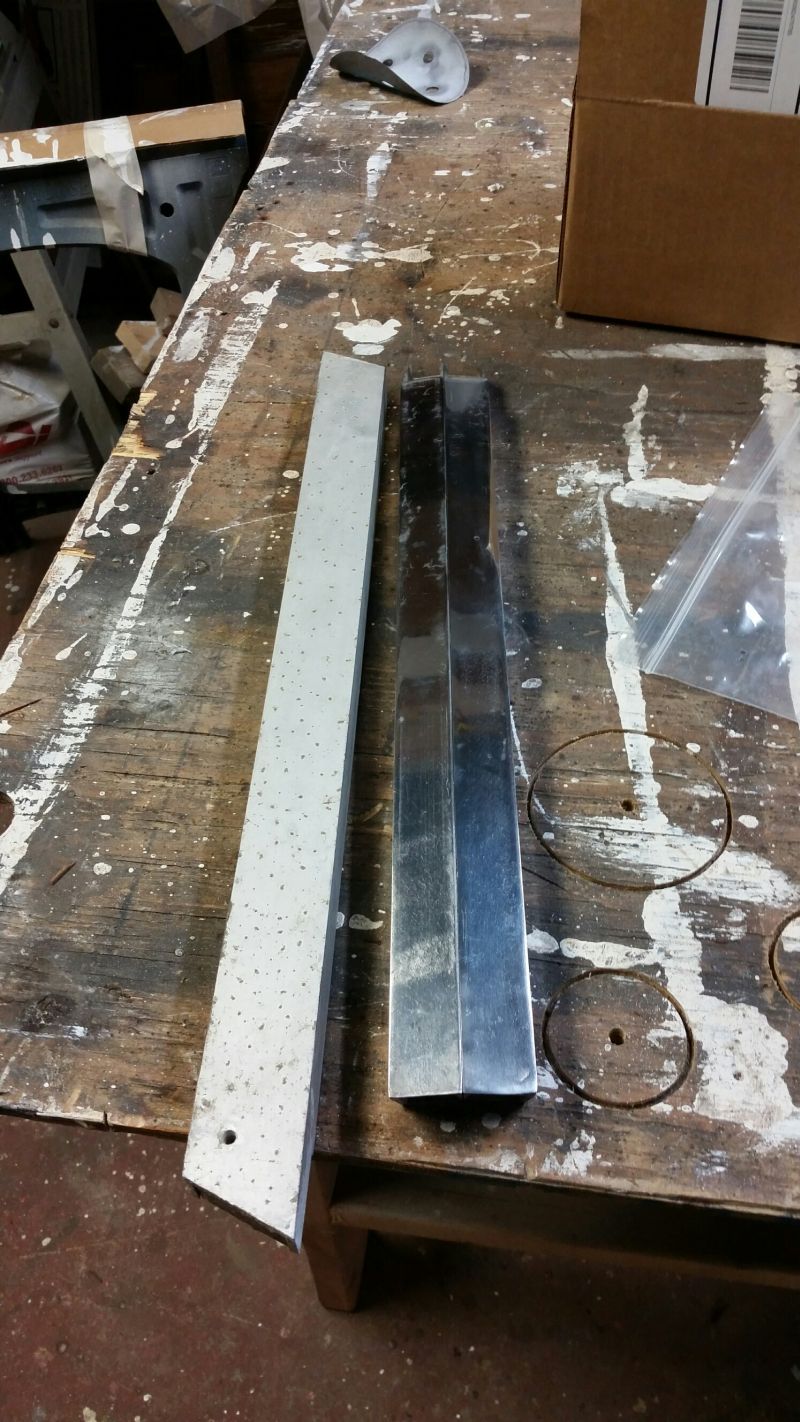

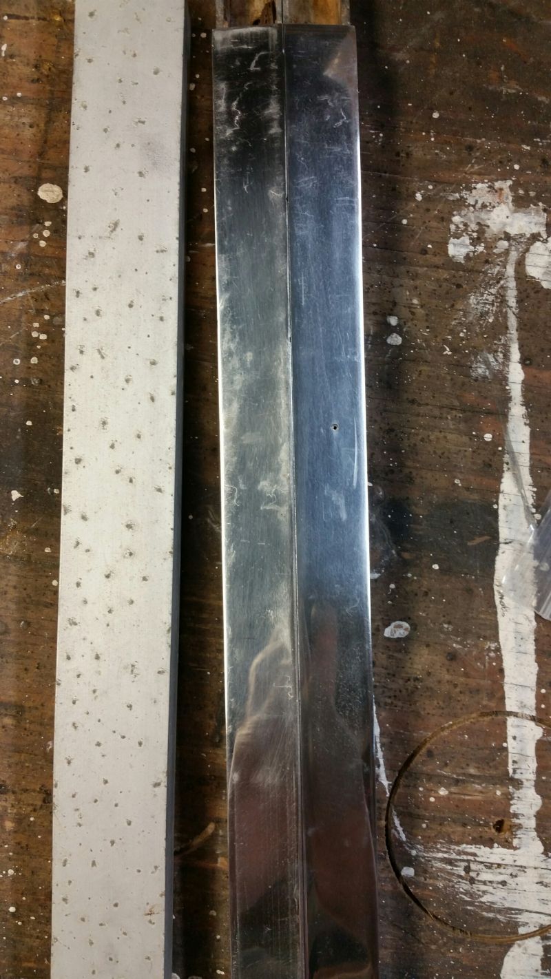

ok thanks, I purched a buffer and buffed for seveal hours on one small piece, not great resuls but im just a novice at this I used Black, then white maybey Im missing something? i bought the buffer at harbor fright, any advice if i should by a better one? or try a different color for the buffing wheels. I may just sand and paint as this would take me forever.
Thanks for any advice.
Re:Trim aluminum 10 years 2 months ago #125541
hi i can comment on this because i got the t shirt. i bought the 1/2 hp buffer and the buffing kit with all the compounds for my aluminum trim and window frames . you start off with maybe 320 or 400 grit paper then gradually work up from there as you do you can start to see the mirror come in i got 400 600 800 1000 1200 1500 and 2000 grit as i got to the 1500 i had a gloss then 2000 finished it off i used the emery (red) ad then the white Tripoli
and i am very happy with the finish eastwood has a clear coat after you finish mine was oxidized very bad and now it looks new. they make a paste compound i didnt get it but i sanded everything down and then buffed what was left. i couldnt get the result i wanted with buffing alone.

Ok I spent some more time on sanding so thank you for the tips, Im learning that by sanding up to 1500 grit I dont need to buff as long, I was just not sanding enough. I still have a long ways to go takes me several hours to get a six foot piece done.
Im not to sure if i should clear coat after all this buffing as I think I can just polish every so often to keep the shine?
Thanks again for any input.
