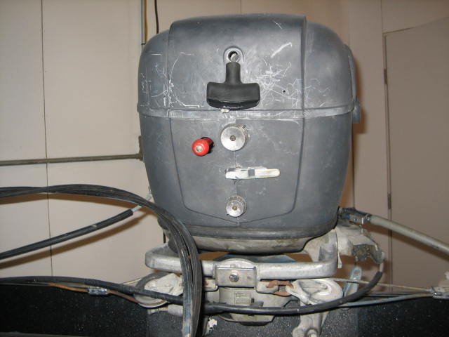

i need some help. this motor came with a boat i just bought, and it runs, but i need to adjust the knobs on the back to keep it running. i think its a 1958 sea king. model# GG8985A
Serial# 85X723905. is that right? anyway i can't find any info on it. what are the knobs for?
thanks!!

Sea King GG8985A is a 1958 Gale outboard motor, rated at 25 HP.

Are the knobs moving on their own? If so, they have a packing nut at the base of the needle shaft that might need to be tightened a bit. The knobs should move snugly, but not too snug that you can't adjust them.
The knobs are on the ends of the needle valves. Upper is the slow speed adjustment - usually start at about 1.5 turns from closed. Lower is high speed adjustment - usually start at 1 turn from closed. Adjust from there - usually inwards, until the motor starts to lose power or sneeze, then back out about 1/8 turn. Do the high speed one first.
