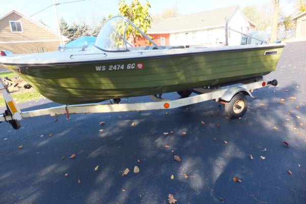

I think I may have a problem. I bought another boat today. As some may know, my daughter Alaina and I are in the middle of a restoration, and just bought a "practice" boat for her.
Now her friend (also named Alaina!) wants an old boat too!

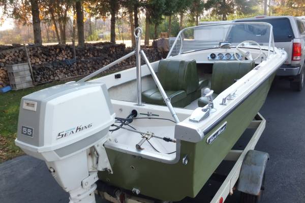

I found this 1970 SeaKing on CL not far from my house. I was impressed with the ad and the description of how clean it sounded...not a scratch on the hull and all original. I stopped by tonight on my way home, and couldn't believe how nice this thing is! The engine looks new, the boat is so clean. The only thing that could use attention is the vinyl flooring which is coming loose up from where it curves up the sides. The seats look new, and the windshield is spotless.
He was asking $550, and I got it with very little effort for $400. Comes with a pile of life jackets, 3 props, anchors, etc.
I was SO tempted to keep this one...but being a good friend I called Alaina's dad and told him he just bought a boat. I offered a money back guarantee... if he doesn't like it I'll buy it back. At any time.
His daughter doesn't love the color, but it's not as bad in person. I'm hoping it grows on her. If not, I will offer to paint the hull for her.
I will take them out tomorrow night to pick it up.

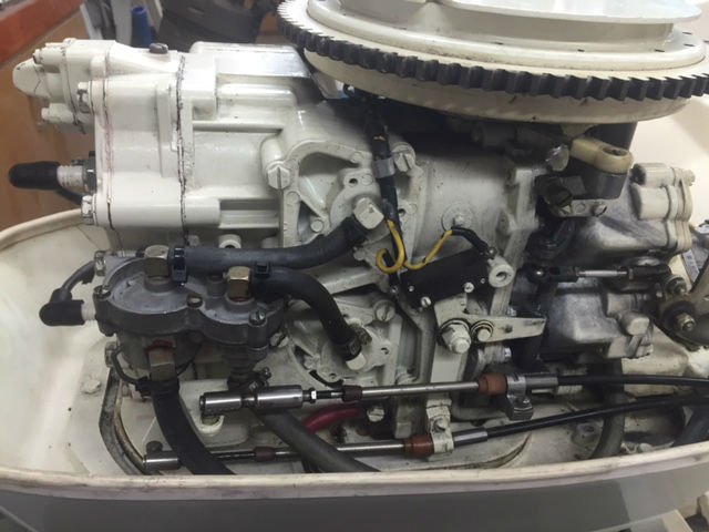

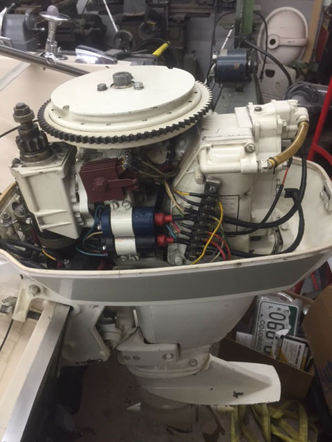

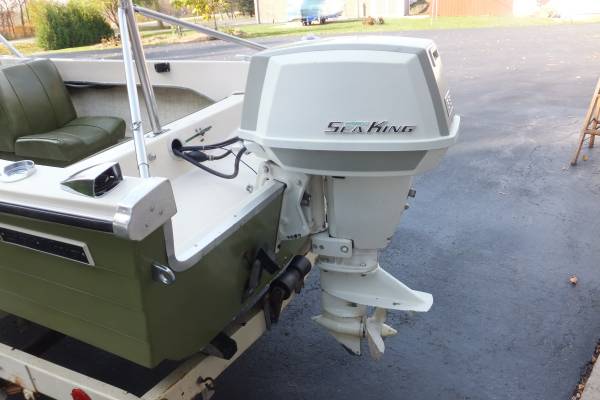

Some motor pictures in case someone can tell me what I have here...
Re:1970 Seaking 10 years 11 months ago #117166
  • ed-mc
  • Posts: 1472
  • Karma: 235
  • Thank you received: 130
That's a very clean motor. Probably will only require minimal servicing (clean/gap points if it doesn't spark); carb clean if it's not getting fuel; and a new impeller in any case.
Also check the gear oil, if there's water in it, likely the driveshaft seal will need replacing at the same time you do the impeller job. A new seal is cheap, and a snap to replace.
This is a Chrysler-produced engine, so you should be able to look up parts for a 55hp Chrysler.
Here are some Chrysler listings at Marineengine.com:
www.marineengine.com/parts/chrysler-outboard/index.php
The oldest 55hp they list is 1974, but I expect the parts would be similar.
You can also use the "application guide" to find Sierra Marine aftermarket parts.
Not a screamer but a pretty good outboard, very simple in construction and easy to service.
Years ago I had a smaller Sea-King (about 13-1/2') and put an old 700E Merc Dockbuster on it. Had a lot of fun for very cheap, and it was an excellent ski machine!
Your boat is in far better shape than my old Sea-King was, 30 years ago.
An excellent find, congrats!..........ed

27955 is a 1969 55 hp.
Re:1970 Seaking 10 years 11 months ago #117179
  • Kerry
  • Posts: 675
  • Karma: 51

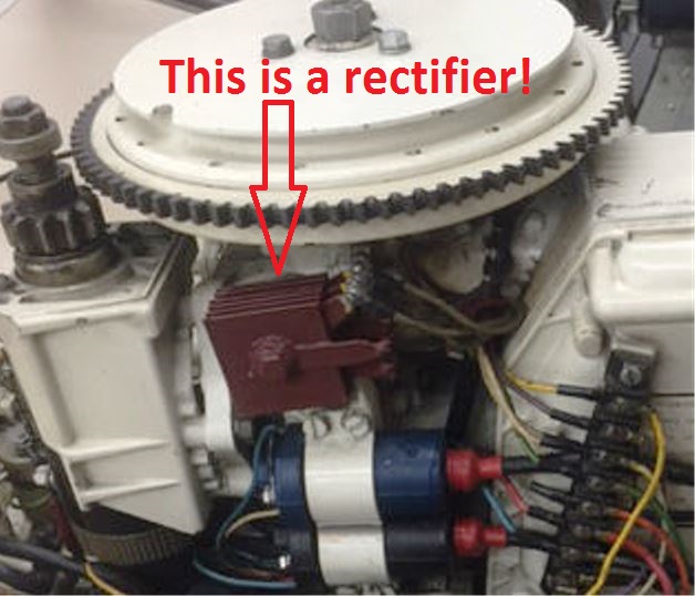

Checked my manuals, the twin coils and maroon box indicate a CDI ignition. Still uses points for triggering, make extra sure they are clean and properly gapped, as they also control timing. Point gap is .015, and a variation of .0015 will change timing one degree according to my manual.

The maroon "box" mounted above the 2 coils would appear to be a rectifier assy, and I expect this model is just a 12V points-n-coils ign, easy to service and very reliable.......ed

I'm getting confused...I did read up on CDI, but I can't tell from you all...is CDI good or bad for me?
Re:1970 Seaking 10 years 11 months ago #117208
  • ed-mc
  • Posts: 1472
  • Karma: 235
CDI is a good ign when it's working. But if you have to replace parts on a malfunctioning Chrysler "Magnapower" electronic ign system, it can get very expensive.
But you Do Not have Magnapower ign, see the attached picture. There is no CDI module mounted anywhere on your engine.
Points/battery ign is easy to service and is virtually trouble-free with the occasional maintenance. CDI ign is good for plug life and smooth idling but your 55hp will run fine on its conventional ign and standard spark plugs.
HTH..........ed

I stand corrected.

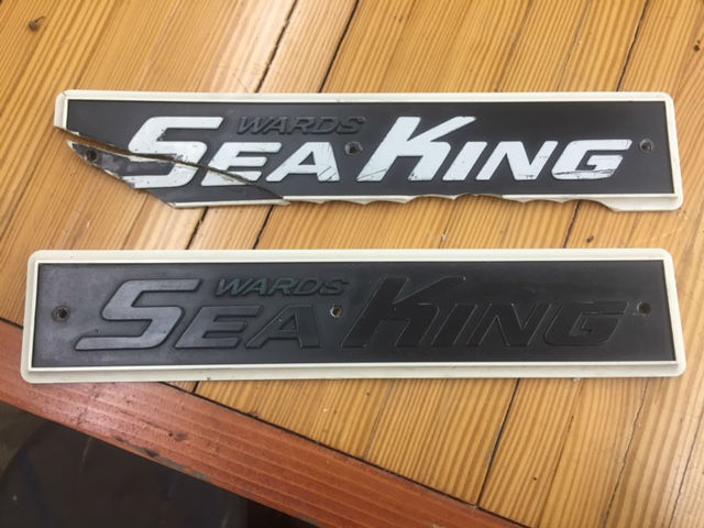

I did pop the side name plates off, as the starboard side is cracked/broken. I am wondering what you all have come up with for repair or remaking plastic badges for boats that don't offer new replacements. I wonder if a 3D printer might work easily and affordably for this?

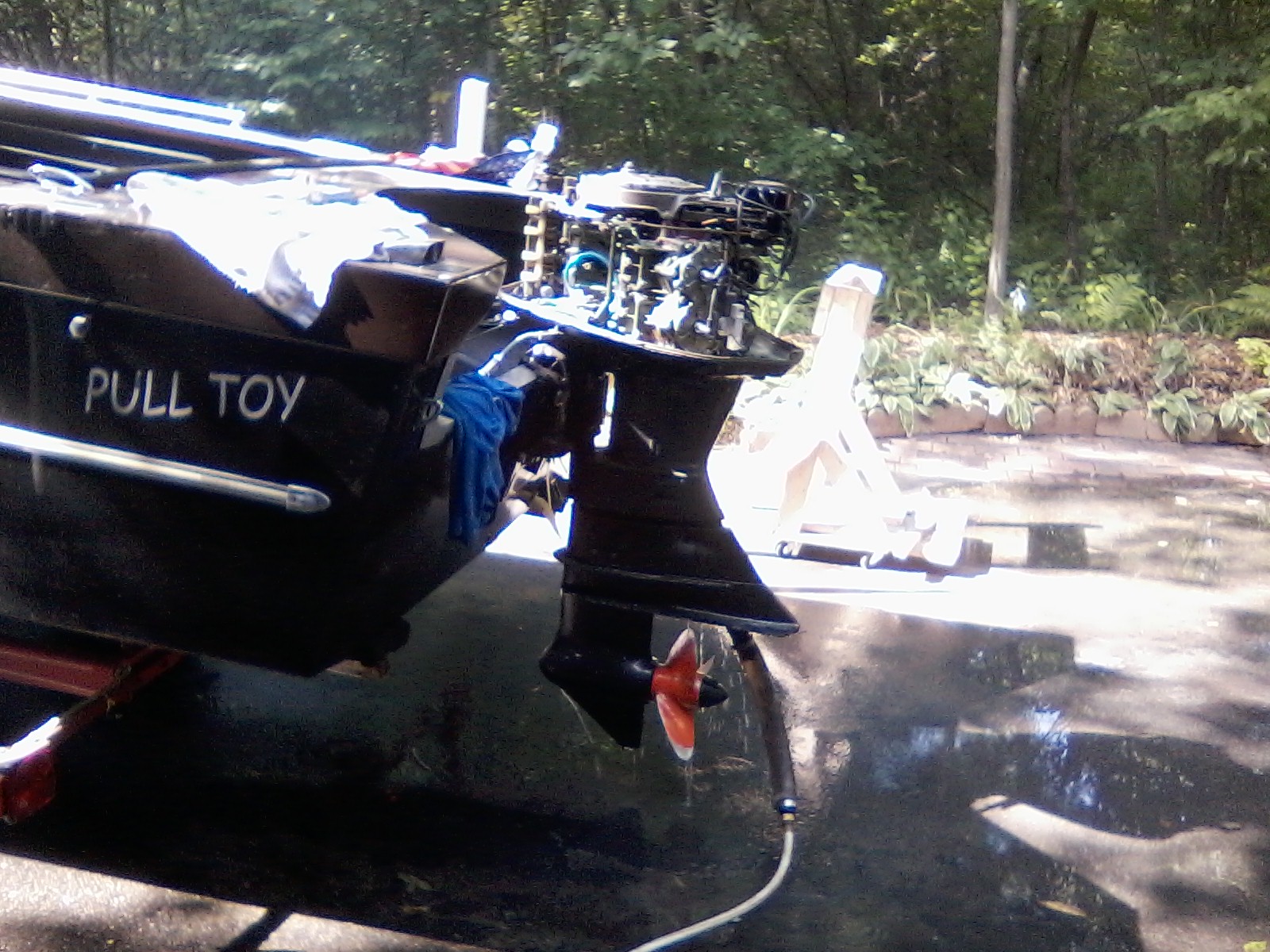

I finally got around to doing some more work on the boat tonight. I did some wet sanding on the gel coat with good initial results. I will want to go back over it with higher grades I think, so I will keep at that project.
I was able to get the impeller out. I had been waiting to place the order to Franz Marine for the plugs, wires, impeller, etc until I could get the impeller out and see what I needed.
I snapped a picture and sent it to Franz around 9pm tonight. At 9:20 my cell rang with an unknown-to-me number, which I almost didn't answer. Glad I did. It was Franz! He said he is leaving tomorrow morning for a week of vacation, so if I wanted the parts, he would package it all up tonight and ship it out before he leaves in the morning. Then he gave me his cell in case I had any questions. He was worried that he would have poor cell service where he was going, but if I left a message he would get back to me asap. Seriously. I am blown away at the service and knowledge. I didn't even really ask him for a total when I paid...he's just the kind of guy you know you can trust. That just makes this hobby that much more fun.
People are good.

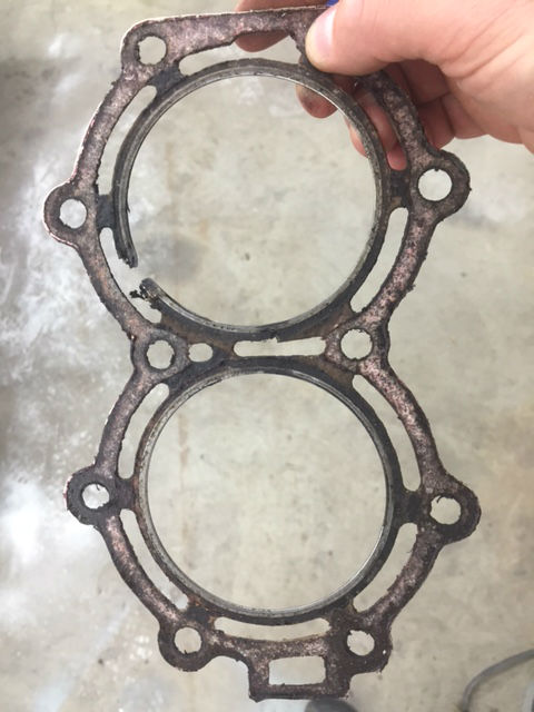

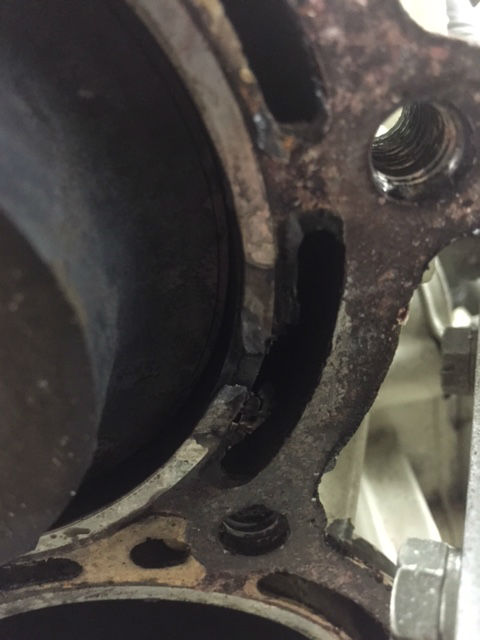

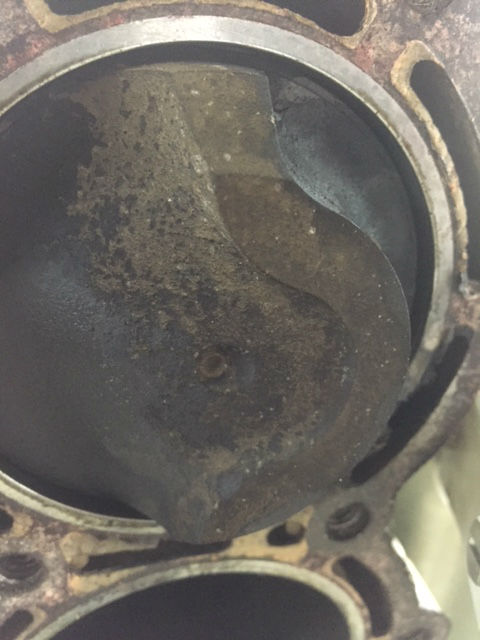

I thought I'd give an update, more for therapy for me than anything.
After I got the parts from Franz, I put in the new plugs, wires, impeller, new lower unit oil, etc. I found a guy about an hour from my house who said he is an expert on these old Chrysler outboards. He charged me $50 for a tune up, and I gave him $80 to show me how to do it, rather than just do it for me. He's a really nice guy. Turns out I was not pumping water after my impeller change. Seems the water tube didn't get hooked up right when I reassembled it. I finally got that hooked up and working right. We put a new diaphragm in the fuel pump and adjusted the carb. Got it running pretty decent. I had hoped he would check my work on setting the points and then set the timing. We were running late on time, so he kinda rushed through that part. However, it ran well enough that I figured we were good to go.

We got up to the lake, dropped it in the water, and it wouldn't start. After a bit of work, I was able to get it running and was able to keep it going by manually revving it with the throttle on the carb. Once it warmed up a bit it ran pretty well. I had my friend drive the boat back to the dock while I drove the truck back to his house. He ran a few laps on his own, and said it ran great. By the way, this is the guy that was supposed to have bought the boat but backed out. I tell you, when his wife saw the boat, she was very upset that they passed on it. By the end of the weekend her bid was up to $2000 to buy it from me.
Anyway, he ran a couple of laps, then picked up his daughter and mine and took them out for a couple of laps. I was down at the dock by then and he picked me up. With the 4 of us in it top speed was a whopping 23mph. He said it was moving a lot faster when he was alone, but he didn't look at the speedometer.
After another lap, the overheat light came on. I shut it down right away and let it cool down. We restarted it and all was good, and it was pumping water. Another lap and it just died, almost like we ran out of gas, but no sputtering. Just kind of bogged down and quit. And it would not restart. I left it tied to the dock for a couple of days because it looked so cool in the water. We tried numerous times to get it to go, but eventually the starter quit and we were done.
I took the starter apart and found the ground brush wire had been soldered and this came apart. I tried to fix it, but it only held for a few minutes.
I took the start to a nice guy who really fixed it and worked on the starting issues again tonight. I was able to get it start on starting fluid and then could keep it running by manually working the throttle. But, I noticed I was not pumping water again, and shut it down. While it was running it was running poorly.

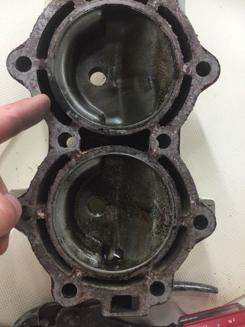

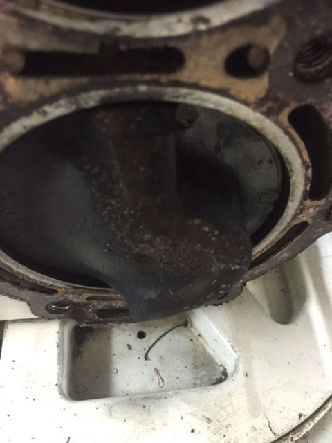

I did a compression test again and now the bottom cylinder is 140, the top is just 70. Yikes.
So, off with its head. Huh...it's a Hemi!
I got lucky...the head gasket was blown.
I will get another this week and see how much of issue this solves. Wish me luck, and shoot me any advice!

It blew for a reason, likely the head isn't flat. You need to get it flat or it'll probably blow a gasket again.
You can have it surfaced at most any machine shop, or if you've got the time, surface it yourself with a sheet of sandpaper taped to a piece of glass or very flat metal surface.
Start with Medium grit and if the head is not flat, you'll see the low spots right away. You'd have to continue sanding until all low spots are gone. Move the head in a "figure eight" pattern on the sanding paper, this will more-evenly remove material.
Check the block, too. These old big twins have a bad habit of delaminating the steel sleeve within the aluminum block, once the aluminum around the steel deteriorates, the gasket won't hold. The only cure for that problem is a replacement block or powerhead. Fortuntely there are a lot of Big Twins out there!!
HTH & keep us updated on your progress.......ed

I got a sheet of heavy glass and adhered 120 grit sandpaper to it. Moving the head in a figure 8, I slowly progressed to get the surface shined up. If the presentation of low spots was any indication, the head does seem to have been warped. After a lot of elbow grease, all areas are nice and clean. I carefully scraped and sanded the block as well. Just out of curiosity (I won've received the gasket until Monday) I mated the head to the block to see how it fit. Interestingly, it seems high in the middle, as it teeters a bit. I can rock the head up and down pivoting in the middle. When I hold the bottom of the head tight to the block, I can get a .006 feeler gauge in between the head and block at the top edge.
Is that ok? Am I concerned over nothing as I don't have the gasket in there?
Thoughts?
Also, I thought maybe now would be a great time to time the ignition, as I can clearly see when I am at TDC. However, according to the manual, I need a special tool (rod) with marks as I am trying to find 32 degrees before TDC, and I don't have this tool. The manual uses a test light to adjust the opening and closing of the points based on the tool mentioned. The guy that helped me tune this up before the 4th of July holiday weekend just threw a automotive timing light on it. He couldn't find a mark on the flywheel, so he found TDC and made a mark on his own and used that. He put the light on it and said it looked fine. I've timed cars before, and that is pretty straight forward, but I could not understand what he what using as reference lines to confirm timing. Maybe that had something to do with the failure I am experiencing?
Advice is so much appreciated.

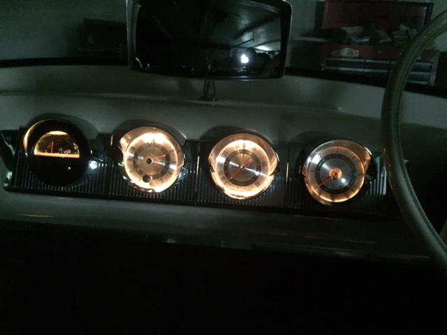

Today I got the gauge lights working, and after rebuilding the dimmer switch, it all works like new.
I think they are pretty neat!
