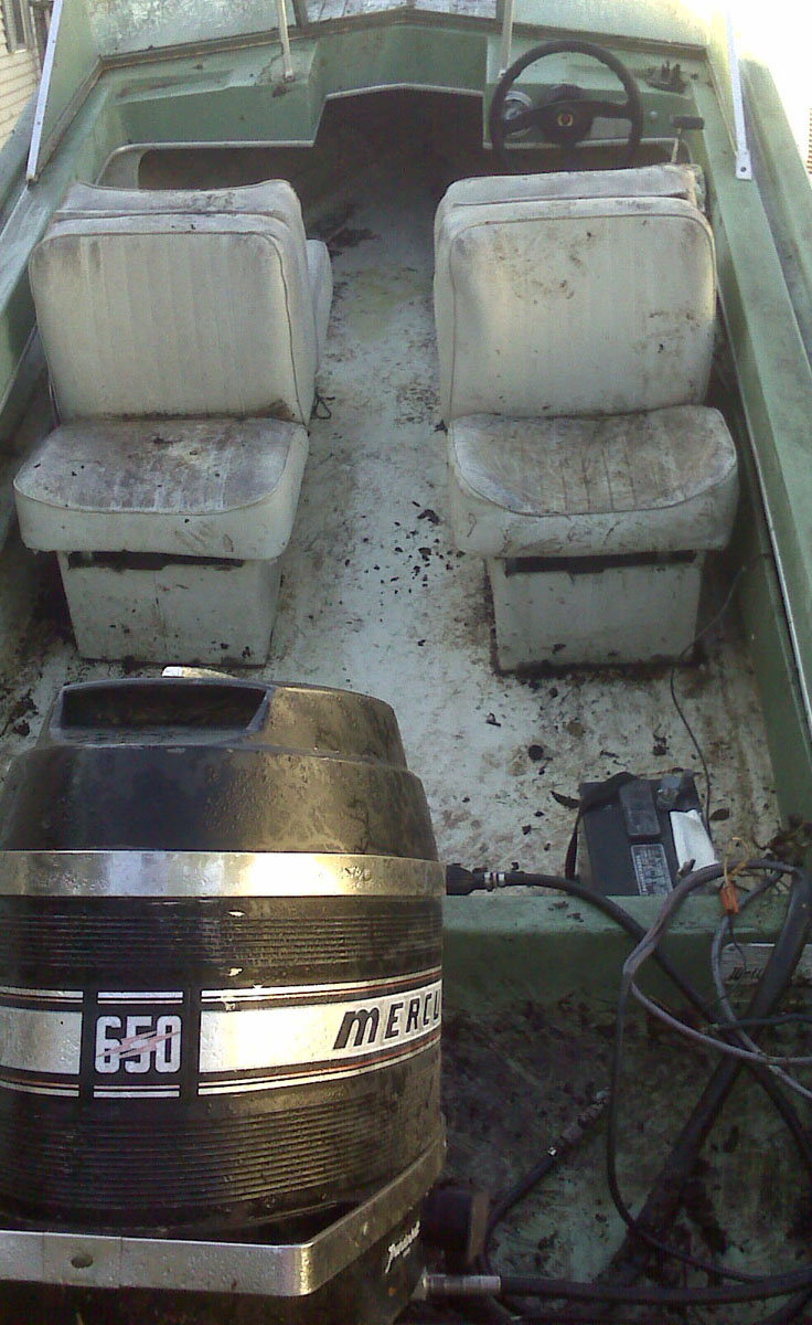

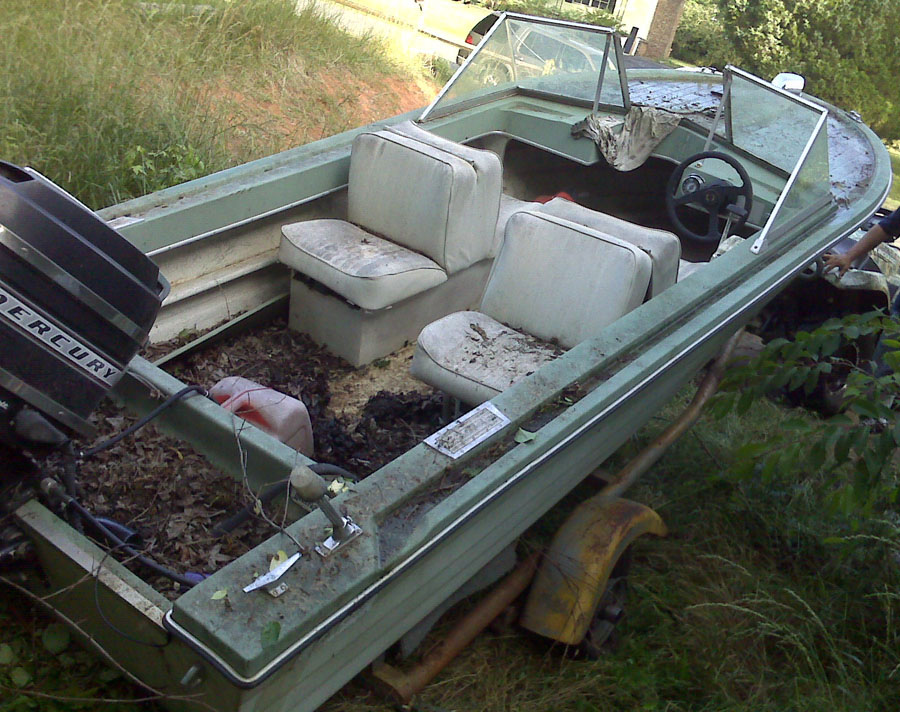

Just started back to get this boat back in shape....
I started with the trailer, and have ripped out the interior of the boat, but need a few suggestions as to the best place to start.
Interior is non-existent now and I have cleaned and wet sanded the exterior.
Should I paint the exterior first, then go for the complete interior? I have time, but would like to approach this the easiest way?
I have a few pics on my profile...she needs a lot of TLC
Thanks.

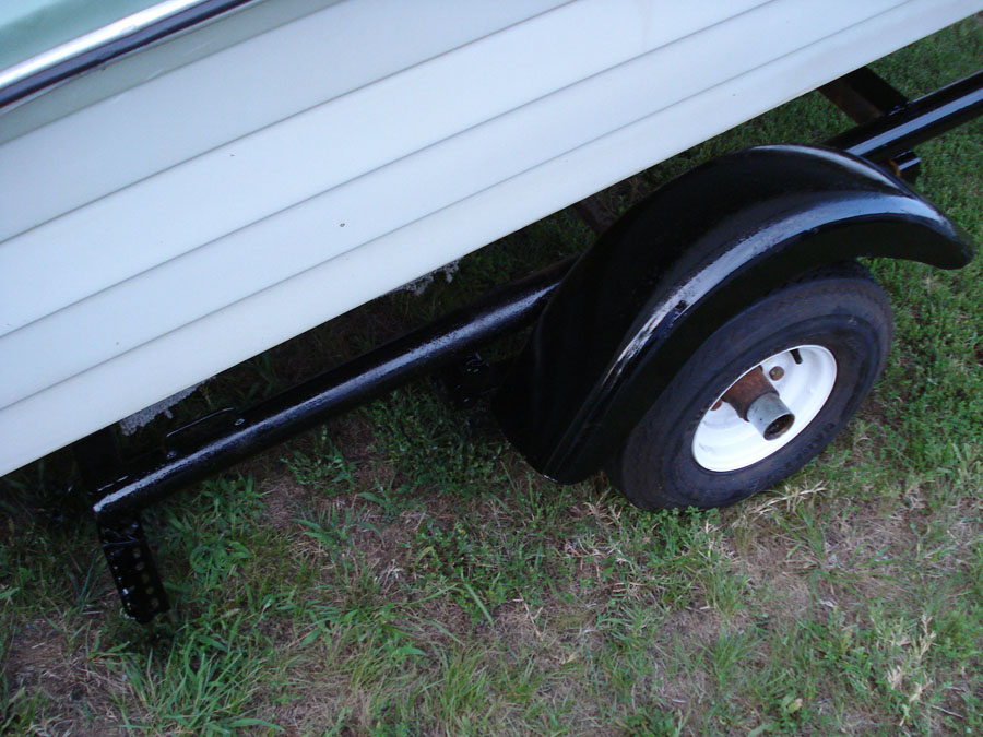

here is the after pic of the trailer

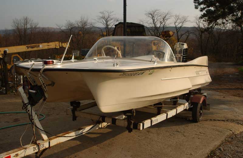

wellcrafted,welcome to the forum,i started makng the interior of our boat 1st,but it was winter and i didnt have my garage yet,it was in another garage 20 miles away,then we replaced the floor then after i got my little garage we sanded and painted the whole boat,after that we put in the carpet and interior,i still have some left to do.
then next is paint the motor to match because we are taking it to harveys lake in august.
i wish i had had enough time to have the motor gone over 1st,but we like the look of it on this boat and it is the original motor,so we will go with it.
before pic after pic

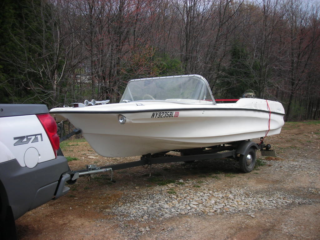

i did the outside of my boat first. they're wasn't much to do inside other than seats and dash. the motor wasn't touched and the trailer is now rebuilt from axle out.

Trailer looks great!

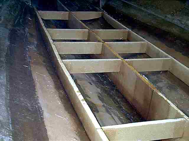

I am about to start the rebuild of my Banshee, and after much consideration I have decided on the following
split boat hull from cap
Rebuild Hull (inside and out - Transom - stringers - floors - glass and strengthen smooth and paint)
Rebuild Cap (glass - modifications - paint - fittings)
Re-unite hull and Cap
Trim and fit out interior (wiring - seats - lighting etc)
Then finally for me have a professional restore my outboard (for whatever it costs to do it right) and fit it up last for the reasons mentioned - fresh for water use etc
