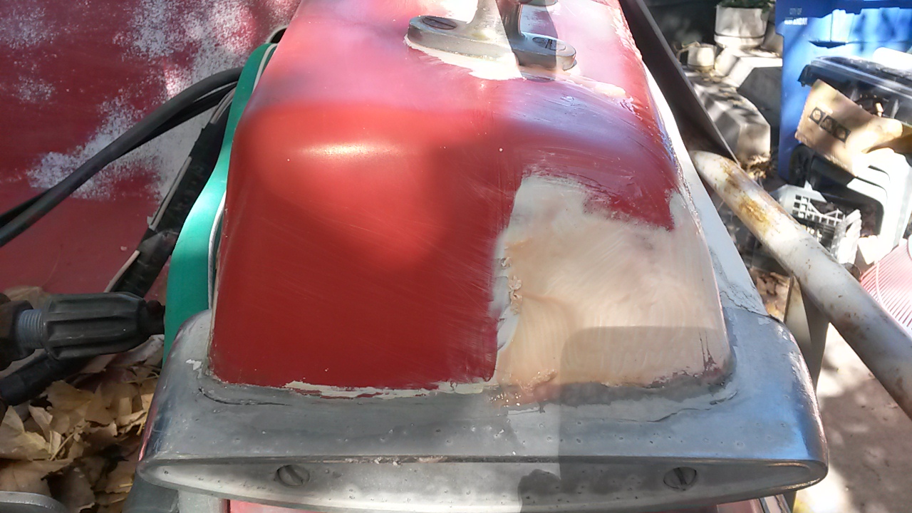

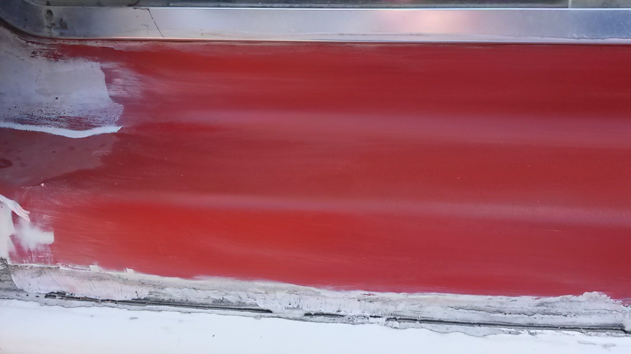

I finally got a chance to get some Citristrip, and I tested it on some spots on my catalina and I tell you, after only half an hour it took off the paint like it was still wet. Fiberglass underneath looks great. I took some pics showing contrasts, I can't wait to get the rest of it off. Thanks again for the insight and tips.
Re:Stripping paint from fiberglass 10 years 11 months ago #116480
That entire rear portion was all white. 1/2 hour, and it's gone.
Re:Stripping paint from fiberglass 10 years 11 months ago #116482
If you look to the left, you can see two thick trips of white that just stop. They did continue all the way to the right. It was very thick and came off like a breeze.
