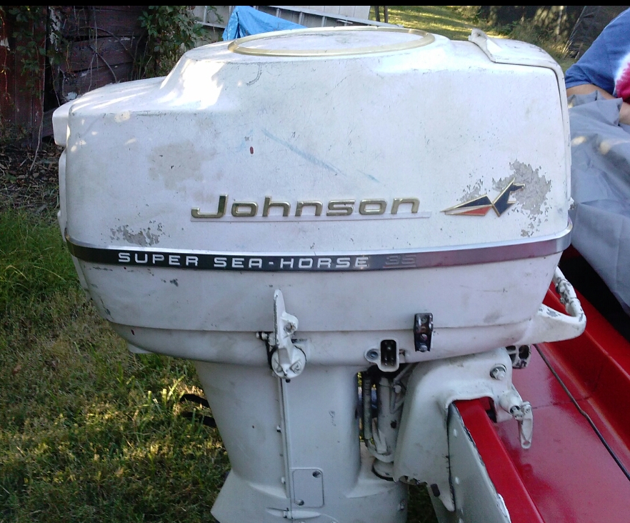

Found a '59 Johnson 35hp. Needs a little cleaning and maintenance, but I got to hear it run and shift and everything looks good.
Re:Scott vs JEGO 11 years 2 weeks ago #115451
VintageDave,
That, imVho, is one of the nicer OBs around. = I have one at Mother's that money wouldn't buy.
