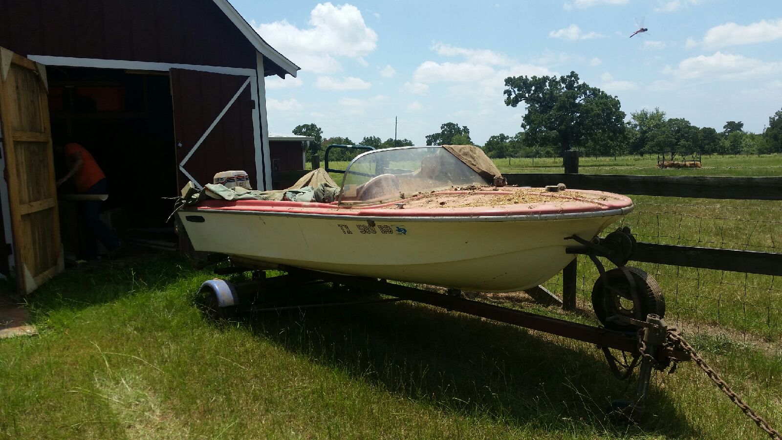

So while visiting relatives my wife was offered the opportunity to buy this boat (for 400.00) from my great aunt. It was purchased by my great aunt and great uncle new from sears many years ago and was used on a small lake on our family land in Texas mostly for family reunions. I am told it originally came with a sears 25hp motor but was upgraded to the evinrude 35hp to help with pulling skiers. I was basically used once a year for a few years (stored in a barn under a cover in between uses) then put away permanently. It has been covered in the barn for 20+ years.

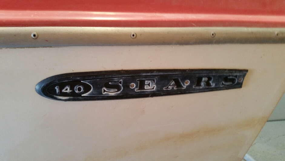

From the picture it looks like a 1964 sears 14' runabout. The emblem says "Sears 140". The outboard motor says evinrude 35. That is about all the info I currently have.
The trailer looks a bit sketchy, it does not look like any I have seen with similar boats. Knowing my family, they may have built their own rather than buy one. My wife is having the wheels, tires and axle bearings replaced for the drive back to phoenix.

let's see if this works ?
Here is the pic that was posted...
www.fiberglassics.com/media/kunena/attachments/legacy/images/20150723_124859.jpeg
Nice looking boat. Love the dragon fly too !

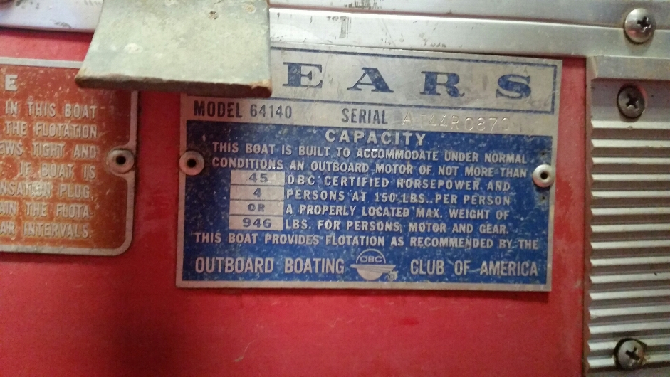

After seeing the pic, your is the closest to the deck form I have ever seen. Mine is a 1962 Elgin Sport utility runabout. 13' 9" center line, 60" beam. Other than mine, I have never seen another with the bow form like ours I.E. the two raised ribs along side of the bow light. What does your plate read ( mounted on the starboard side of transom, inside) ? Been searching online for years, never seen another so close to my elgin
Re:1964 14' Sears Runabout (Sears140) 11 years 2 months ago #113377
I do not have a picture of that plate and i have not seen it yet. All I know is it has badging on the side that says "sears 140" from what I have read, sears used many different manufacturers to make their boats and motors back in the day. It is very likely that this boat was made by the same manufacturer as yours. Just google "sears 140" or "14' sears boat". there is even a flyer for this boat from the catalogue back in 1964 online.

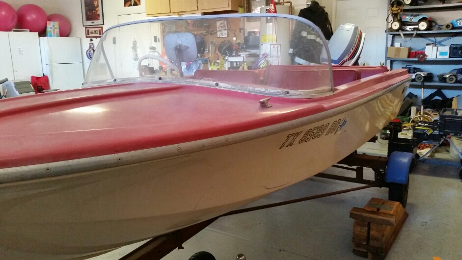

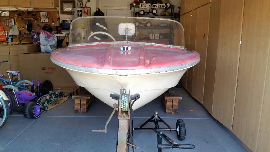

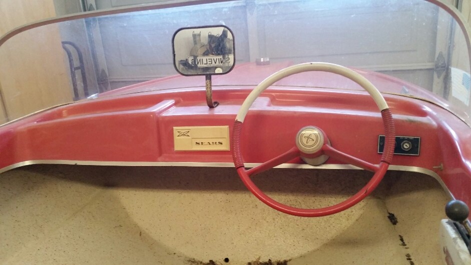

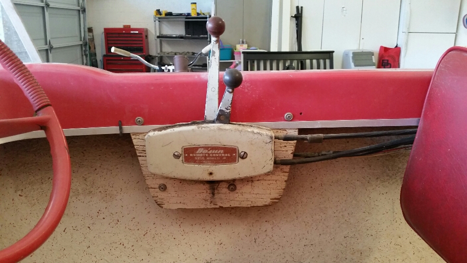

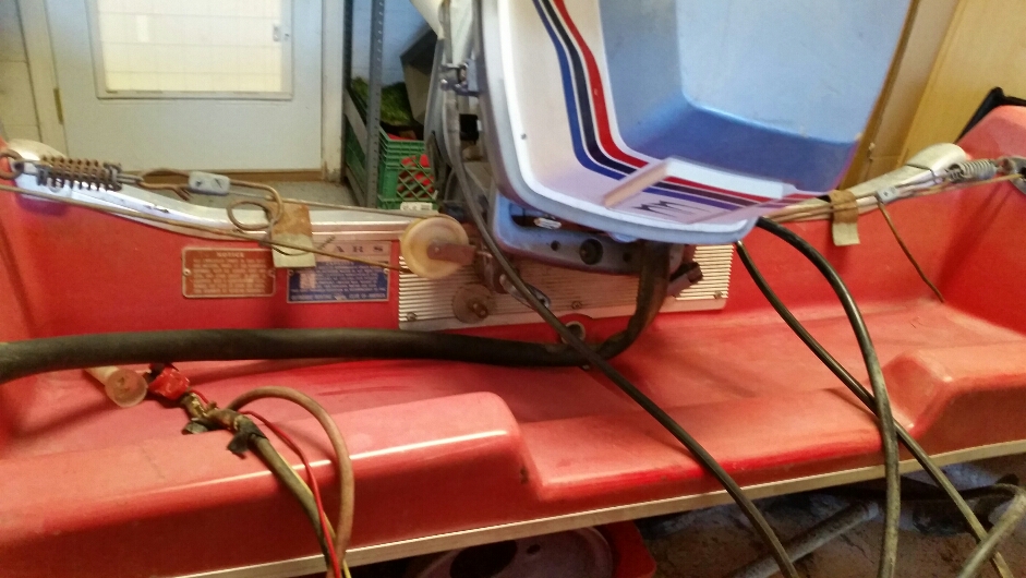

So here's the good the bad and the ugly.
The good - the transom and body are near perfect for their age, the windshield is flawless. The entire upper half just needs a good buffing to shine it up. The interior is great minus one rip that should be easily fixed. It looks complete minus the fuel Cel which I assume was a plastic one, no big deal. The controls all seem to work too, could use some lube but otherwise working well.
The bad - the trailer is pretty rusty, it's going to need sandblasted prior to paint. The prop is pretty much trashed. Needs to be replaced.
The ugly - unknown by my great aunt, there is a patch (about 18") in the floor under the rear seat. My uncle remembers they hit a stump many years ago the punctured the hull. The boat never sank and they repaired it. They used it for years after that and he says it never leaked. It is kind of ugly and although it is in a spot you would rarely see, I think I will take it to a glass shop and see what they would charge to clean it up.
Other than that it is great and we are excited to get her back to her old glory!
Re:1964 14' Sears Runabout (Sears140) 11 years 2 months ago #113661
Looks to me like you can have a really sweet rig there with just a little work! I know fiberglass work seems a little intimidating at first, but many of us (myself included) were guided by the great folks here on the basics and found out it really isn't as bad as once thought. Very similar to working on an outboard, once you get into it it really isn't as hard as you once thought. The gang here is always glad to help, let's get her done! :laugh:

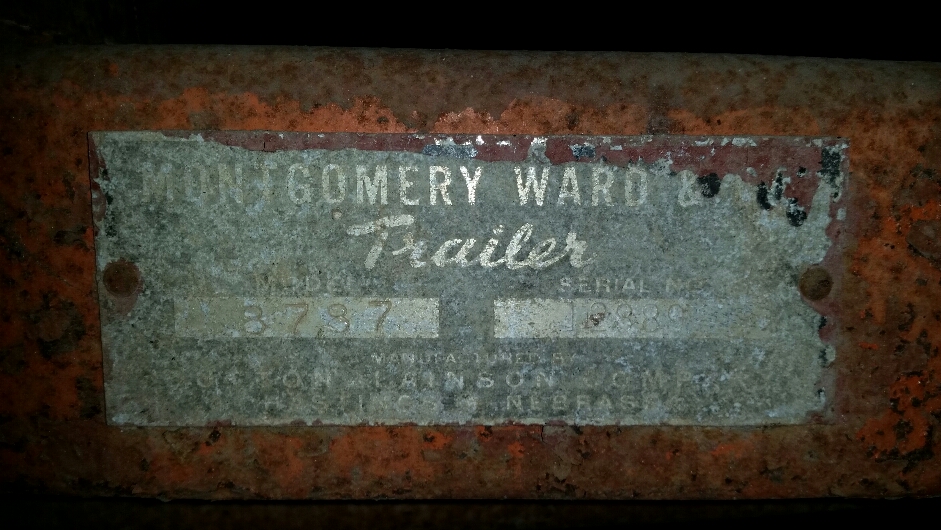

Re:1964 14' Sears Runabout (Sears140) 3 years 11 months ago #147272
Hi - where did you find this serial number on the trailer? I am trying to register mine, just like it!!
