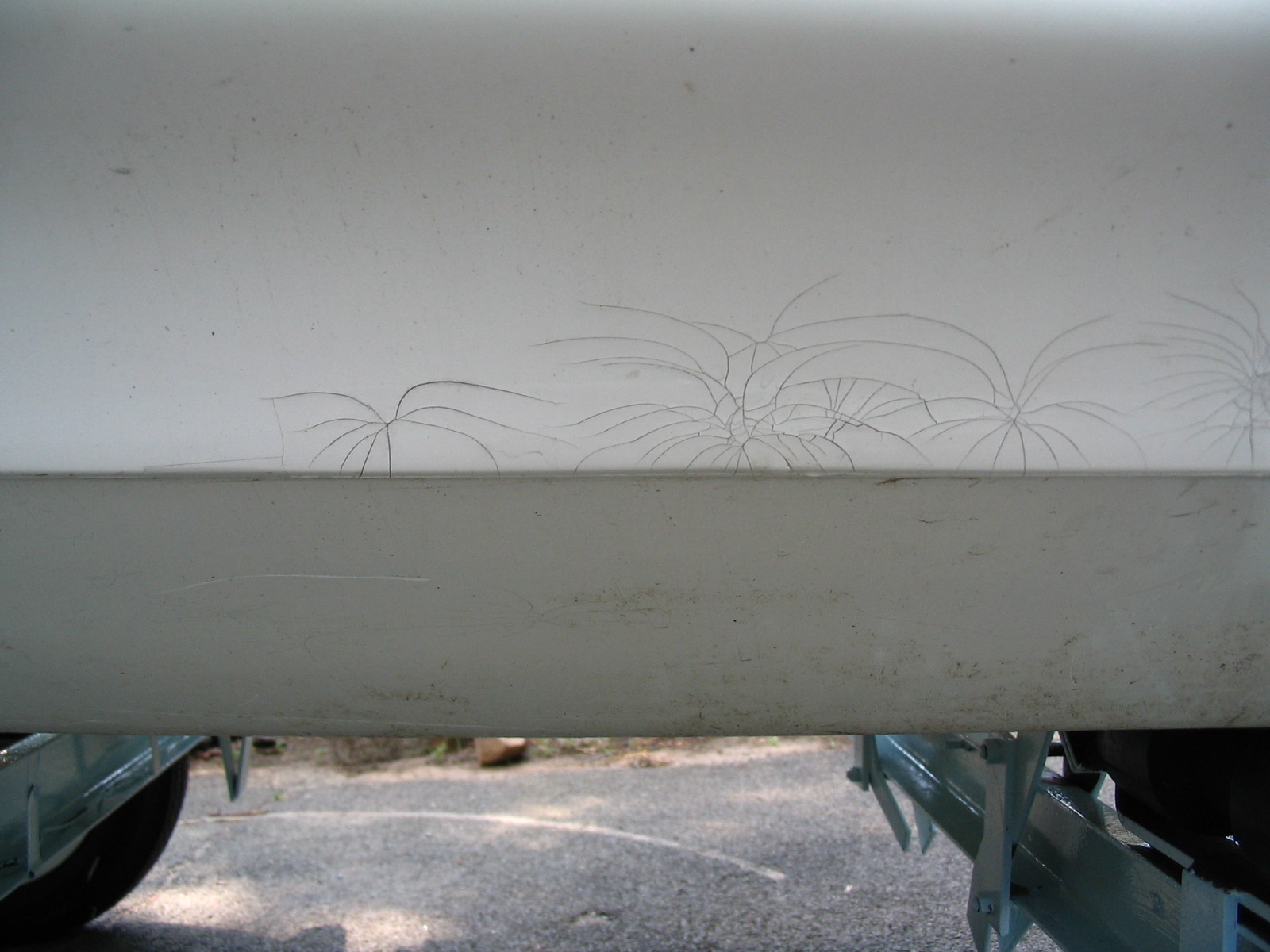

hi, new to all of this and a novice. I'm trying to restore a 1962 Swiss6 "Comet" 16 ft.
The paint on the bottom (it's rather flat by design) shows signs of small fissure "spider web" cracking. Not significantly terrible. I've been told that sanding and layering between coats is the way to go, however the sides coming up from the bottom are in perfect presentable shape. Is there a way to just touch up the bottom with a new coat of marine white paint, without having to sand the old off completely. Will it seal the fissure cracks, and what to do with the gel coat "shine". Would it have to be buffed, wet sanded, or can you just paint, and then gloss coat ? Any info is appreciated..

We are mixing terms here. I'm 99.9% certain the boat is finished with Gelcoat and not paint. The spider cracking is a common occurence of old gelcoat finishes. You can either sand them completely out and recoat with new gelcoat or use a dremel tool to v-groove out each vein of the cracks and then fill with a gelcoat paste. Depending on how extensive the they are will determine the best method to use. Or You could fill them with a fiberglass paste filler and then Paint the hull with the paint of your choosing.

bruce, unfortunately there is no easy fix to spider cracks in gelcoat. as flamingo said they must be v-grooved out, properly filled and finished. this is the normal breakdown of gelcoat on old boats. its not an easy process if you have no hands on experience. its messy and you should wear a ventilator. when i had mine done, all looked great, then the first big wake i crossed/jumped, guess what , some of the cracks re-appared. the only way imo to avoid this from happening again is to remove all the old gelcoat..then re-finish. good luck, ron :

Fiberglass in itself is waterproof, to an extent. The Gelcoat, is the finish coat. Gelcoat is a Resin based product just like the resin based fiberglass. Both of them will over a VERY VERY long time absorb miniscule amounts of water. Nothing that you should be concerned with. Only if the fiberglass fractures exposing the glass fibers is there going to be an issue. The spider cracking is more cosmetic than anything. It probably will, over time lead to the gelcoat eventually totally failing and falling off but your boat will NOT leak or have any other structural issues.

Spider cracking will probably not begin failing and falling off during your lifetime. If it does, it will most likely be so far into the future that you will no longer own the boat or just won't give a damn. I say leave it alone and go boating.

If you have decent hot water coming out of the relief port on the rear of the motor during use,some steam is normal.The amount of water and steam coming out will vary depending on the temp of engine (thermostat opening),lake water temp. As for the crazing as long as none of it is scaling off, you can watersand and buff it to make it shine. If it's peeling off,I'd leave it alone if your going to sell it anyway. Mark S is right on about leaving it in the drink too long. I wouldn't because I saw mine get what I guess was marine growth in the tiny hairline cracks on my hull and pimple up the surface of the hull causing my hull on my boat to fell like medium grit sandpaper.I watersanded it down,buffed it and got it smooth again. No more leaving it in the water all week :S . I also had a Crestliner that the hull was doing just like yours and I watersanded it with some fine paper and buffed it with great results ending up with a good shine.
