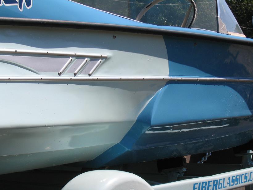

As far as the windhield goes you have a few options. 1) have a new one molded from your old one, which is pricey, I was quoted $600 for mine.
2) get some lexan and make your own from the original that you have (you can Google it for some tutorials)
3) fill the cracks in that you have with some expoxy, then use rubbing compound and a buffer to bring back the rest of the plexiglass.
As far as the shiny bits go, if they are pitted real bad they are probably pot metal and the effort to restore them is probably not worth it. You can buy chocks, cleats, ski poles, and running lights on ebay that look very vintage and should suit your needs fine.
If they are stainless pieces or aluminum you can Sand and Buff them, finishing with some steel wool for a nice shine.
Post some more pics and you can probably get some better advice than this amateur.

Thats an interesting idea regarding lexan, I have never heard of that. I will have to take some closer pictures of the hardware to see what people think. Thank you!

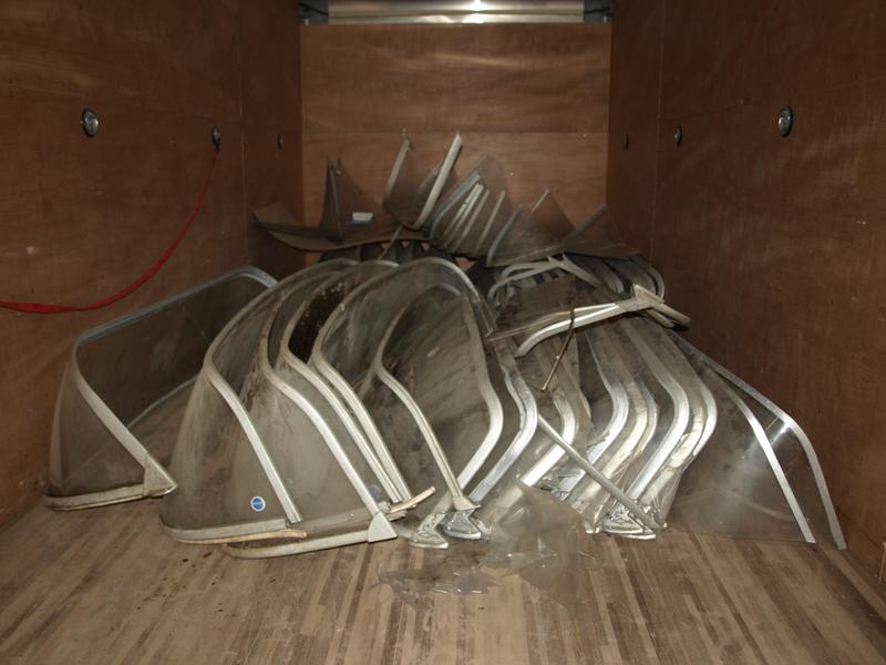

Tyson,
You forgot the fourth option, which is buy a New Old Stock one or good used one.
I have "NOS" Custom Craft windshields, and I know where to get at least one of the smaller ones, which is probably the one he needs.
I believe the smaller one for this boat is 54" tip to tip? That's what is available from a fellow down in FLA.
Anyway, Welcome to the group!!
P.S. Wefco has the die for the rub rail you need, just tell them it's for a Custom Craft, or send them a sample piece.
Check out more Custom Crafts Here: www.nicklecityclassics.com/customcraftboats.htm
Dave in sunny Buffalo

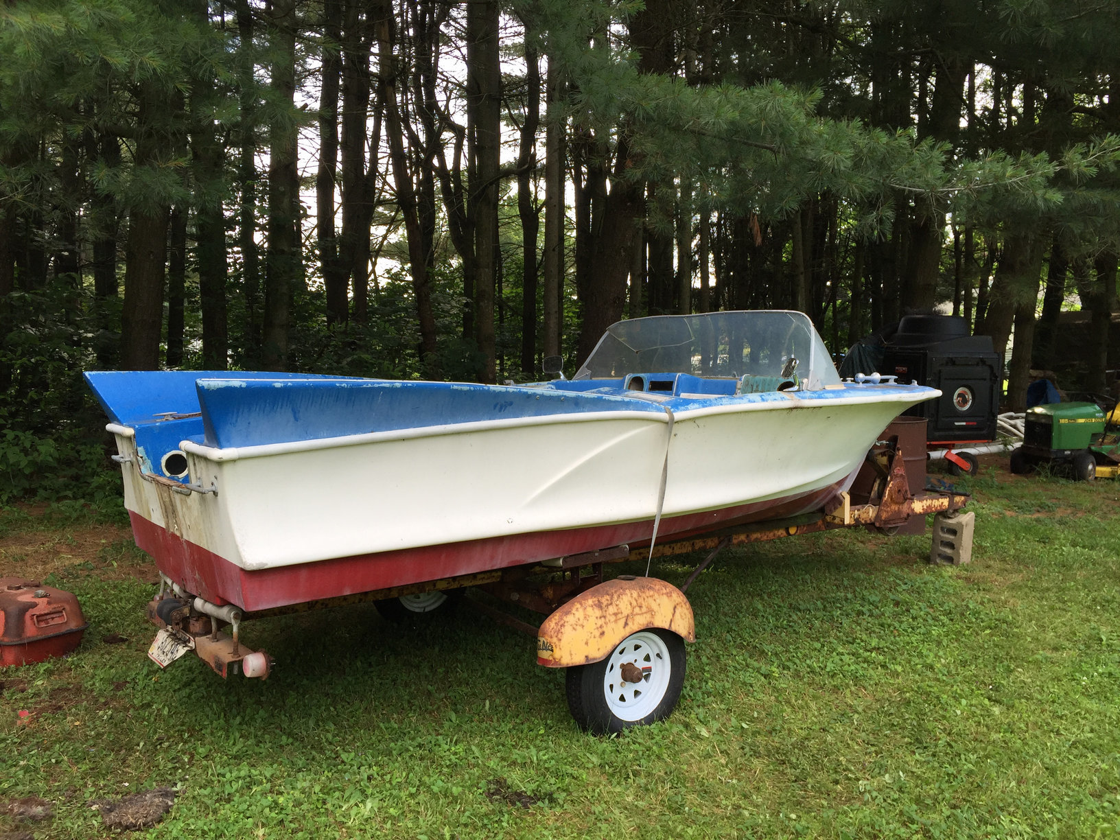

Thank you, It is great to be aboard! Perfect Wefco has just what I was looking for! Ok so here is a more pressing issue. I have discovered that the hull is filled with water. Feels (and sounds) like over 100lbs. of water in the area I have pictures below. As I mentioned I pulled this out of the weeds and the boat was filled with water. I drained all the water and pulled up all the carpet to reveal the drain holes, however, obviously something is clogged. I used a pressure washer on the highest nozzle but it didn't work. The water from the hose does shoot out the back but it doesn't release anything from the hull. Is my only option to cut a hole and drain the water somewhere in that picture I posted? Has anyone had this problem before? Thank you in advance!

That's a bit of unfortunate news. I still don't understand how to get the water out though. There is not a seem to open. So am I correct about having to drill or cut a hole to release the water? From the newbie I am the boat seems like it's entirely fiberglass with some wood reinforcements. Or are you saying I need to get an angle grinder and cut up the floor? I'll do whatever it takes that makes it right :)

That boat is pretty easy to replace the floor/sole. The stepped part (looking from the outside) is the only part you need to worry about, it's about 3' wide and filled with solid balsa wood, (unless it's been replaced). measure in and score the inside glass and it will pop right out. I filled mine in with solid 1 1/2" closed cell foam and a thin (1/4") piece of plywood sandwiched in mat and topped with cloth. Nice and solid and very quiet riding!
I got your request for info on Nickle City, but not much to add, let me know how wide your windshield is (tip to tip) and I'll put you in touch with the guy in FLA if it fits!
I like this style with the big fins, quite desirable once restored, and not too big a project if you don't mind getting a little dirty (and itchy :)).

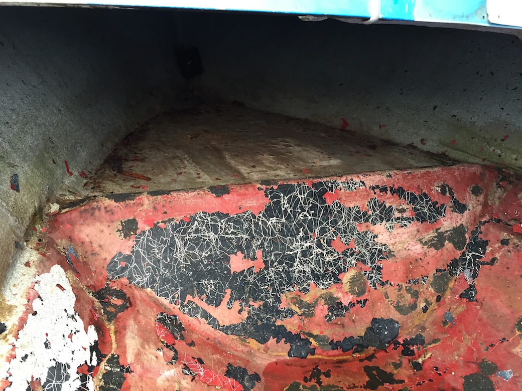

Thanks Dave! But I am still a bit confused. In my laymen terms are you saying that I can score and pop out the red part. kinda like cutting out a half moon? Bare with me this is the first boat I have ever bought :)
Thanks!

That is right no step on the "outside"

OK, you're talking about the front part, and I'm talking about the back part, lol...
The front is just an air chamber, you can drill a hole to release the water and dry it out with a fan or some acetone, they very rarely get water in them unless the boat has been stored with the bow down, even then it's tough to get water in there...
If your floor/sole is wet, that would need to be cut out.
Here is the "step" I was talking about:
"Tredonic" hull.

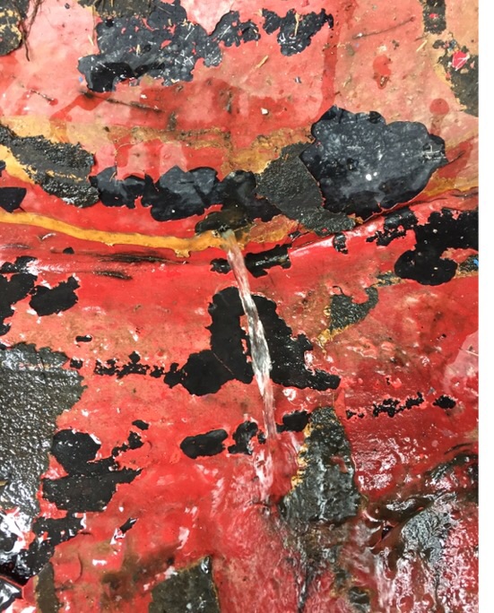

Yes the front part :) and you nailed it exactly it was "Stored" in the weeds bow down. I will get on draining and inspecting it today.
As for the windshield, the broken one I have measured 65 1/2" from tip to tip. I hope I can buy one for it.
Thanks for everyones help, I will keep you posted. Buy the way I could use some parts off of the boat you have pictured. Is there any fat chance that would be possible? Or did you simply find that image.

Drill the hole and drain it. Drill as close as you can to the bottom, but not all the way. drain what you can by gravity and try to get some kind of small pump (drill attachemtn?) to get the rest. You can either seal it back up or put a drain plug from a dinghy. it's not a big deal.

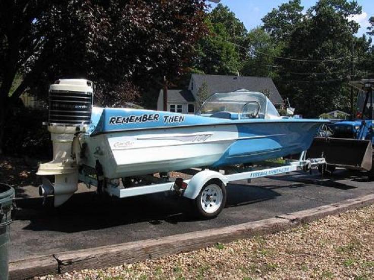

That picture is from Nickle City Classics, the boat belongs to one of our members.
If you have all of the hardware, you can just have it rechromed. SteveG knows a guy who is very reasonable. If the hardware is deeply pitted, you may want to fix it a little first, I believe sanding and filling with solder is the preferred way to do that.

I did drill a hole and drain the water out! Regarding the hardware, I will sand them and try my best with polishing them up. I will keep you posted. Now that I was able to drain that water I think it's time to move this discussion over to "Member Projects"!
