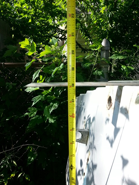

here's that measurement

Re:short vs long shaft on 18 inch transom 11 years 3 months ago #112537
Hi,
It would appear that they intended for a short shaft to run elevated (jacked up).
Regards,
Joe

Just curious what the purpose of a jacked up short shaft would be. Would it be fo more performance?

Re:short vs long shaft on 18 inch transom 11 years 2 months ago #112615
um...looks more to me like a 2in jack on a long shaft might work better.
Re:short vs long shaft on 18 inch transom 11 years 2 months ago #112618
I'd advise running a long shaft motor on that boat and putting a shim under the bracket.

Previous owner says it had a short shaft. That picture shows 18 and 19 inch transoms could be either? I guess I will find out when the time comes. Thanks for that pic!
