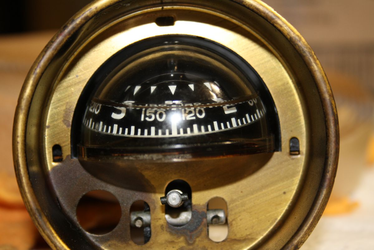

My Airguide compass is only half full of liquid, is this correct or should it be full?
And I presume the little bars at the bottom are to calibrate it somehow?
Thanks folks
Cheers
Bill

Bill,I'd think it should be a little more towards the top of the dome. My compass is a little closer to the top. I think you're right on the calibrating of it.

I think the older compasses were filled with mineral oil. I've used this stuff to refill a compass a few years ago.
www.westmarine.com/buy/ritchie-navigation--fluid-for-ritchie-compasses--P014_420_007_502
Re:Airguide compass 11 years 3 months ago #112510
Thanks for the input. Think I'll drill a new hole, drain it & fill with mineral oil

let us know how that worked with the mineral oil....we have a couple 50 yr old compasses that have all the juice baked out of them that look ok otherwise...john
Re:Airguide compass 11 years 3 months ago #112519
  • rerya
  • Posts: 9
  • Karma: 2
Spoke to the son of the deceased owner of Air Guide.
Mineral oil is the solution in the compass.
