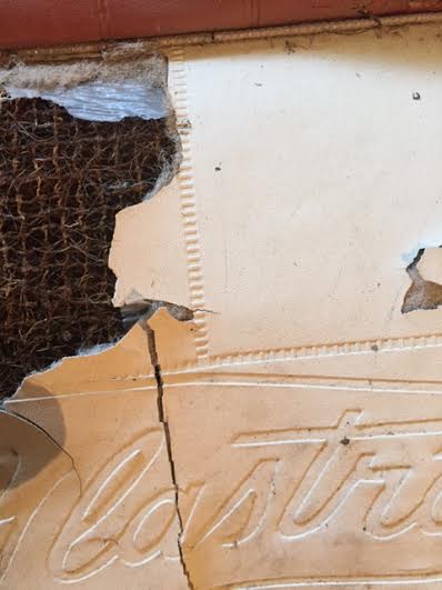

I have old dried out torn seats and they have logo on backs and seats. So that's 8 total. I will try to download a picture for you.
I think I can cut out the existing logo and send it to RF Works so they will have an exact size and model.

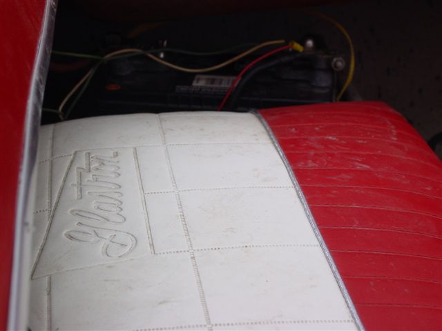

BTW - The pic is not my boat - I found these on net to show how they should look - my boat is red & white

I looked into the embossing when I did my seats (mine are the ones in your pics). All the vinyl is embossed, not just the logos. I decided to go with stitching because the spacing is different from the white to the colored vinyl, which makes set up costs prohibitive. The silver piping is from 56 chev that I got from SMS auto fabrics. ( It's very difficult to work with)

I'm confused. Did you mean that you stitched the borders of the "squares"? The picture appears to show these squares are debossed with indented lines as original with Glastron.
Or are you referring to the "striped" colored backs of the pieces?
I'm working with an auto upholsterer who says he can duplicate the originals, including the lines etc. for about $650 including materials. The only thing he can't include are the logos, which is why I sought out the RF Corp for their input.

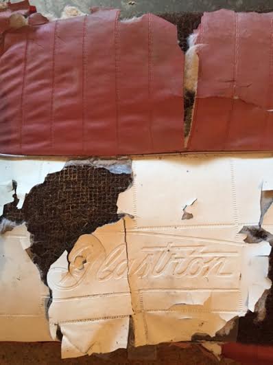

One more old Glastron Seat View

Sorry, the blue seats are mine & all stitched. The red seat is just a good example of original (not mine).
