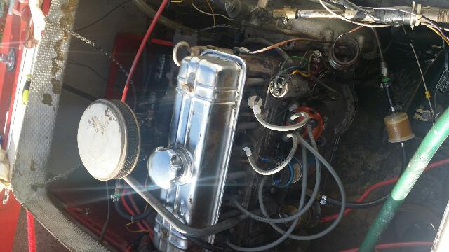

1962 glasspar volvo penta bb70 stern drive. Can't locate the oil filter. Been searching online. New to this type of engine and it was flooded with fresh water. Did plenty of oil changes but still can't locate the filter. Is it in the cooler?

Thank you for the reply. What oil did you use, did you have to but a new gasket too? My plug wires,say "autolite 7.5 mm insulated jacket". The boat got flooded with 3 ft of water and bow I'm putting it all back together after saving the engine. New bow eye is in after snapping off and just down to the final oil change.

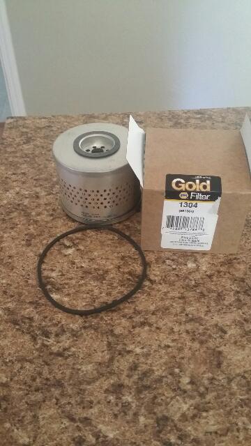

Thank you for your reply. Napa has almost everything for these engines and if not can get it! Here is what I picked up this morning. Ordered it last night at 645 and was there when they opened. I'm changing it all over for a final today with new filter and 5/30 Mobil 1. It's what has been recommended for the most part. I got advice from the previous owner and it's what he used for 25 yrs. Turned her over yest and she started right up and ran for 30 mins no problem. I'm pretty happy with the results since my hubby flooded and sank the boat for the most part. I've been able to clean her up and put her back together with glowing results! I'll post the final results later. Also got the bow eye replaced with a new U bolt style. The single shank style really made for a disaster!
Thank you all for your help. Definitely couldn't have done it without this site!
