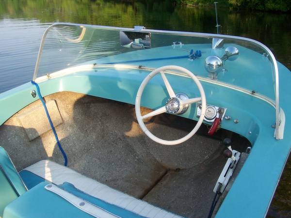

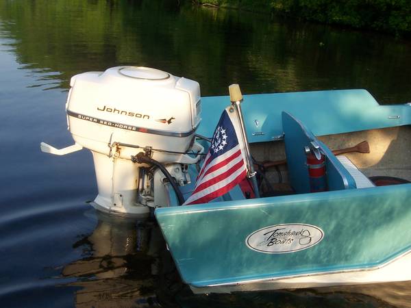

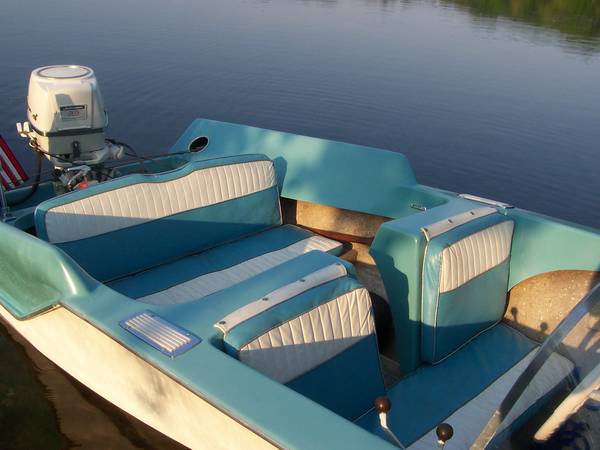

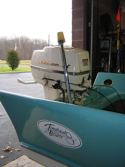

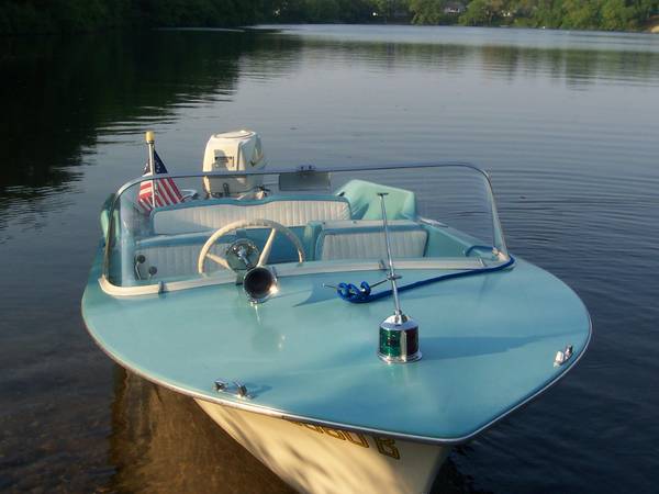

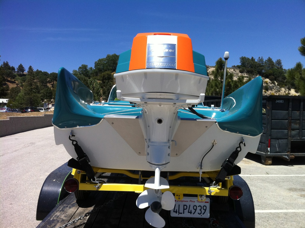

I have attached files below for your review. I have an all original boat, motor and trailer with correct serial numbers. Boat was in storage most of its life with very little use. I am in the process of having it professionally repainted only because the paint had been faded over the years. But everything was in great condition as can be seen in attached files below. I have a lot of documentation I have done a lot of research and I cant find another all original one like it. Yes step pads on the gunwale and Transom pad like a motor mount

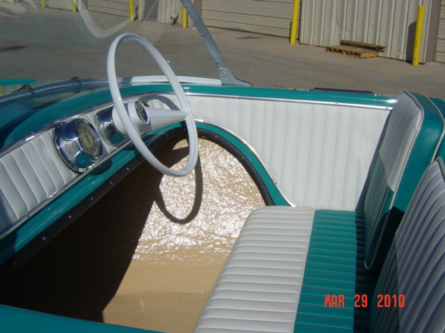

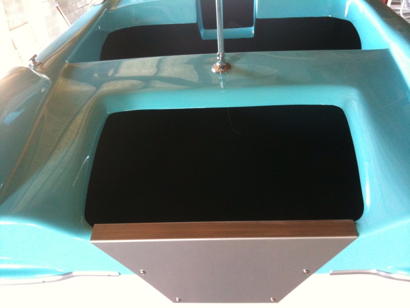

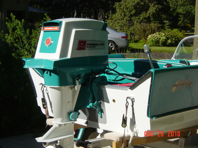

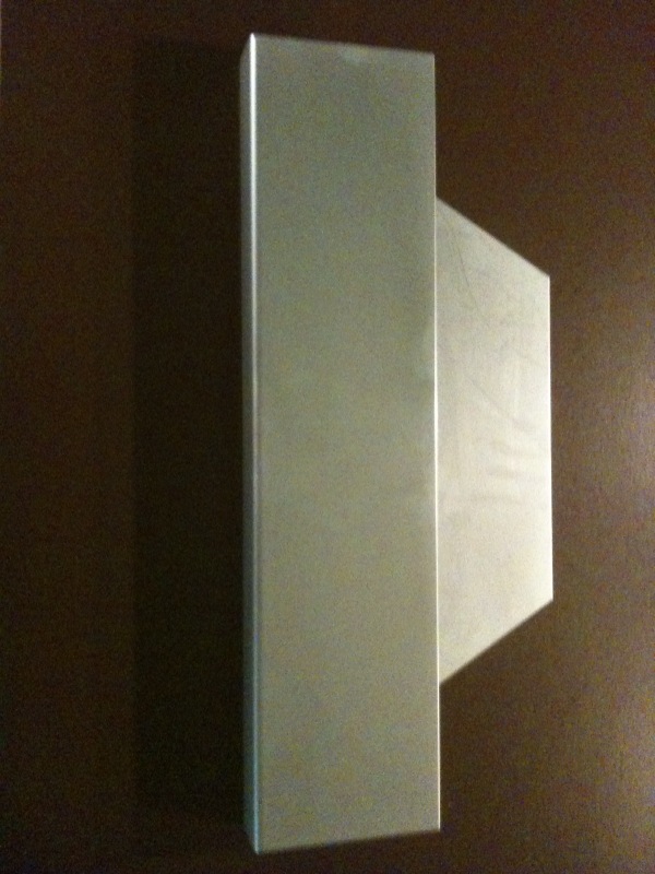

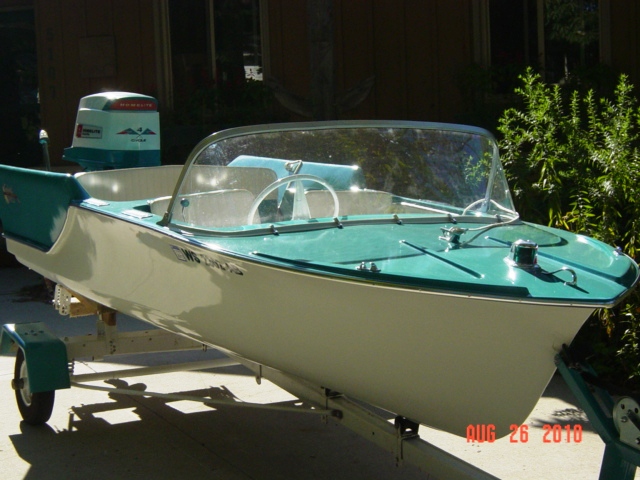

step pads from Overtons.com. I installed two step pads on each side for the front seat one for the back seat.
Transom Pad is made out of 1/8" aluminum plate with 1" radius corners. Aluminum plate ordered from the internet.
A little hard to see the step pads in the photos. I have done five Tomahawks all together. I live in Wisconsin where they were make. There are a lot of them around this area.

We fabricate 14ga. stainless steel transom plates. Our standard transom plate is 22" wide, 10" deep on the outside, and 5.25 inches deep on the inside. I have 2 in stock at the moment.

Gregg thanks for your reply. I have attached pics to my previous post so you can see my boat from different positions. I have a couple of questions that you might be able to clarify for me. I looked at your boat pics and there are some differences for example. My boat looks like the 1958 tomahawk ski mate listed on the catalog that's on the glassifieds. The bow surface has a raised centerline and tapers down slightly on either side, yours has raised detail lines on both sides of bow surface. Did they make two different bow designs for 1958 tomahawk ski mate?

NICE RIG & I really WISH that I could find a HOMELITE 55 like that one for a Texas-built 16 foot hull that I have "squirreled away" at Mother's.

It looks like you already have the transom mount for the splash well, so I'm guessing you want someting that will also cover the area under the motor mounts outside the transom? What I've seen is any that are out there include part for the screw mounts. You can do any number of things including buying the transom pads (available in several different areas...just do a search fo outboard transom pad) and cut off the screw mount part, which is easiest.
Or, get some heavy duty lined rubber, cut it to size of the mounts, and put it under for protection. I went to local truck place and boaught a heavy duty mud flap and cut to size. Works great and protects the boat finish.

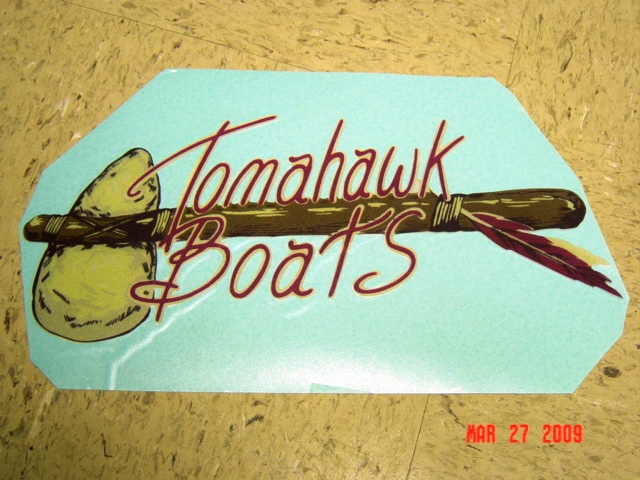

Thanks for your feedback. Yes I have the original rubber pad with screws that goes over the transom that I am looking to replace. its has worn out over time. I will search for transom pads per your recommendation. I am also looking for correct 1958 tomahawk ski mate logo labels. I am not sure that the ones I had were correct symbol. do you know where I could find these.

Going to have to dig out a file. All my boats have a file. A guy here in Wisconsin reproduces these. I have bought about five sets.
Greg Anderson
Wisconsin
How about that I found the information!!
Gerald Nelson
W5914 Freedom Ct.
Montello, WI 53949
608-589-5507
He has NO computer. Call him after dinner, but not to late. Everything is via U.S. Mail and check, NO PayPal. Nice guy, you will like him. Keep in mind the last time I contacted him was 5 years ago. Hope he is still around. Good Luck!!!

Are you sure it is a 58? what I have seen which I can't say is exact is that the 58 had a plastic molded emblem and flat bow. The 59 had the round decal like I see in your picture and flat bow. 60 and 61 had raised structure on bow and flat raised floor. Very curious how much you know about the history of the boat. I am always looking to distinguish years. Thanks

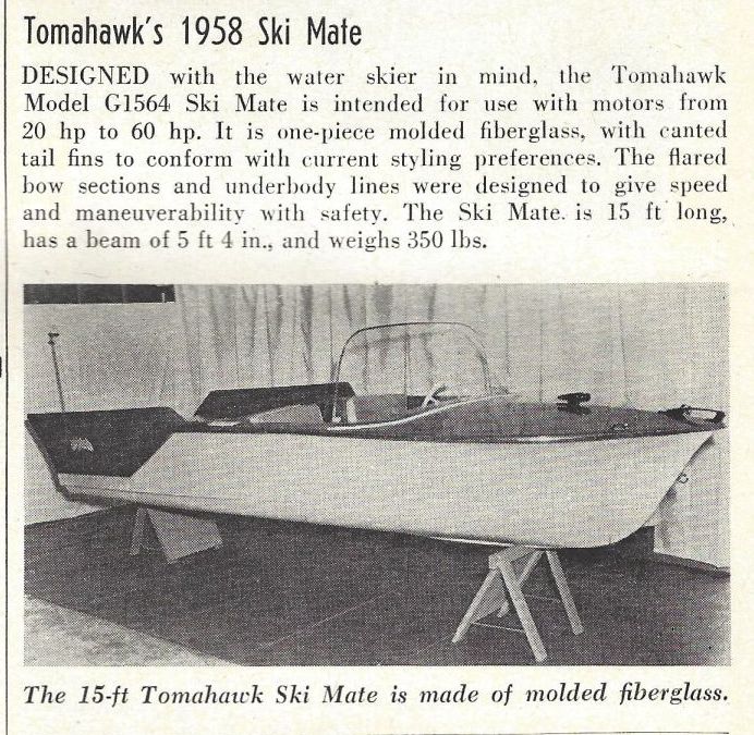

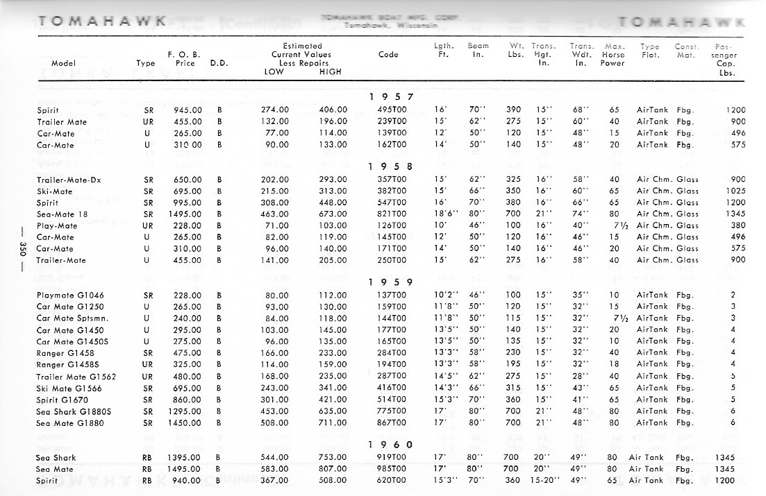

Thanks for your response. I agree determining correct year can be very difficult since there's not a lot of info or pics from 1957 to 1960.In the glassified section there is a spec sheet and advertisement for the 1958 tomahawk ski mate and my boat matches the 1958 specs exactly. You are correct on the round decal. I wasn't sure it was correct either. I am in the process of a groung up restoration and noticed when I removed the round decal the imprint of the original decal was there which matches the 1958 advertisement decal.
I have attached both files below for your review. I also confirmed that the 1958 and 1959 had smooth structure on bow and 1960 and 1961 had raised structure on bow. Also spring cushion seats became available in those years as well. another point od differentiation. What initially confused me was there are pics on this site of beautifully remodeled boats listed as 1958 Tomahawk ski mates and they looked significantly different. They have raised structure on bow, they have 2 step pads on both sides to get into boat and I have one on each side and the helm area has a totally different layout, some with gauges and padding. So I can see how everyone has struggled with these particular dates. For now I can find any other 1958 15ft all original tomahawk ski mates with original engine and trailer. let me know if you or anyone else is able to find any. Thanks again
Re:1958 tomahawk ski mate 11 years 4 months ago #111045
Attached file below is the advertisement from the glassifieds under tomahawk. great source of info for tomahawk boats

Does anyone understand the differentiation between "air chamber" and "air tank" flotation on the model sheet above?
