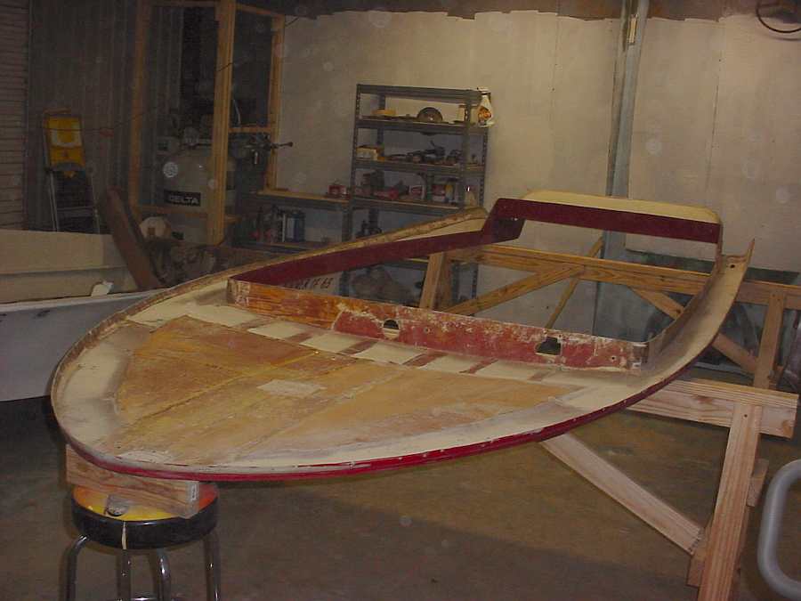

To do the transom right you are going to have to split the dck from the hull. You will be time and work ahead to go ahead and split it than to try and patch it as a whole. Also, that boat was orignally a short shaft transom and someone modified it for a long sdhaft motor, and then evindently it was cut back down again for a short shaft motor. The transom wood is going to run from one side of the hull to the other so it's going to be very hard to replace from the top, unless you do a sea cast type pourable transom. With the repairs that need to be done to the deck to correct the butchered transom I think it would be easier to just split the boat and do it as it was originally built.
Splitting the top and bottom isn't that big of a deal. On the style you have you shgould be able to just remove the rubrail moulding and slip a jigsaw blade between the top and bottom and cut along the dotted line so to speak. The hardest part is usually seperating the splashwell from the transom under the deck, but if the wood is rotten it usually breaks free pretty easy.

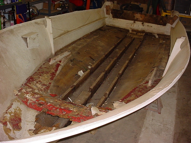

Clasicfins.. thank you for the pictures and advice... is that your Biscayne pictured? If so, then I can see that there seems to be three stringers that support the floor?
You have described exactly what I have been thinking about over the last 6 months or so that I've owned it... I agree.. splitting it seems like a relatively simply operation, and I would love to get everything out in the open so that the repairs may be done right this time (Gotta get that darn pressure treated out! haha) I agree with you, I am in love with the boat's lines and if I'm going to take the time to re-paint it and get it sea worthy... then I need to repair it right first...

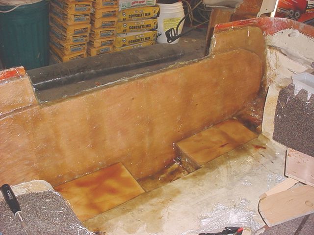

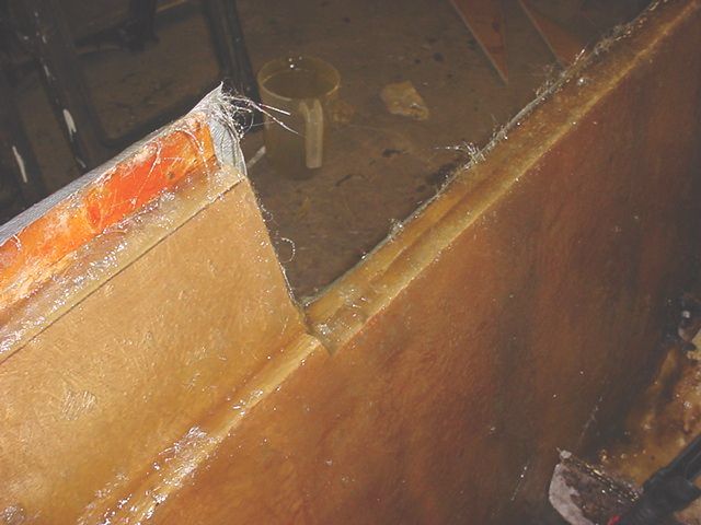

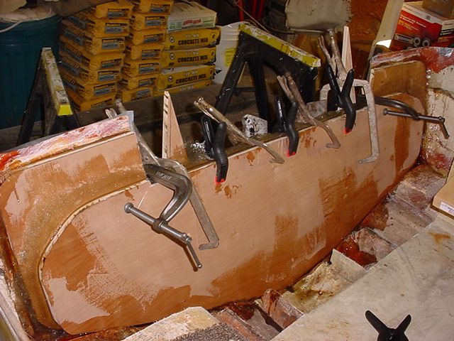

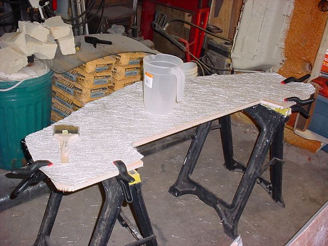

Here's some shots of my family boat I redid the transom on a while back. Newer boat, and mine required one sheet of plywood to be cut differently than the other, but the principle is the same.
Basically, once you pop the deck off, most boats will require two 3/4" sheets of plywood to gain the correct thickness. After removing the old wood and cleaning the inner skin of the hull I lay wet mat/resin on my 1st sheet of plywood and then clamp it into place to dry. Then after it has dried I lay mat/resin on the 2nd sheet, lay it against the 1st sheet, and clamp and let dry. Then come back over the wood with a layer (or two) of mat/resin to seal it in. This is just a quick run through of pics to give you an idea of the process. Ignore the sloppiness it was a quickie job done over the weekend. LOL Hope this helps.
Doug

Doug.. thanks a lot for the pictures... they really do help. I guess then to back-up the slight cracking at the bottom of the transom then, once the old wood was removed, I would lay in a thin fiberglass mech layer from the inside, then lay in the laminated pieces of plywood...
So tell me, it looks like you have laminated in the plywood to the outside skin of the hull, and then added two guessets on the inside at the end of the process... so the 'structural' nature tying the transom plywood to the rest of the boat would simply be the lamination of it to the fiberglass skin of the hull? I guess once the chemical process of the resin happens, everything basically becomes one?
Sorry for the clarrification of questions, but I've only worked on wooden boats thus far with my father...

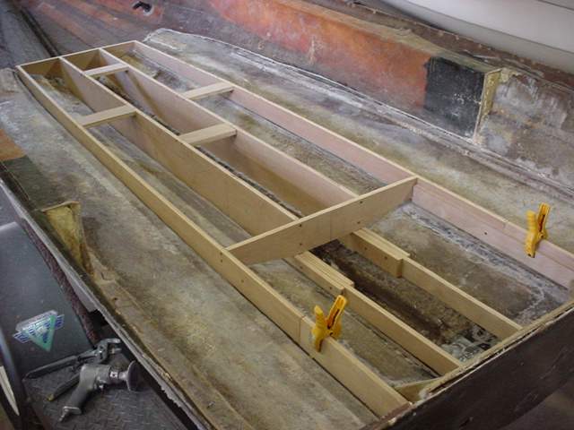

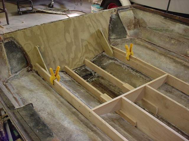

The one in the pic is a '63 Winner I have in the shop at the moment. My Lake and Sea is still in one piece.. for now. LOL As far as the stringers go.. you can build pretty much any stringer design you want once you get the floor up. Here's one I built for a Tidecraft bassboat.

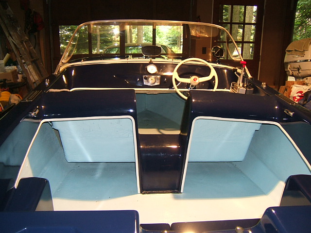

Retro54, Rick here, the 59 and 60 are the same look.
except My dash doesn't have the molded inlay the goes
around the middle of the dash.I'll send some interior
pictures. Also,I sprayed the entire boat with a product
called Polyester Spray Fill after body work.This product
will fill and smooth any areas that you maybe you
didn't block when spot primering.This is like spraying
liquid filler on boat.I wet sanded and painted.More work
but worth it.Any Auto paint store has a type of Poly filler.
Rick

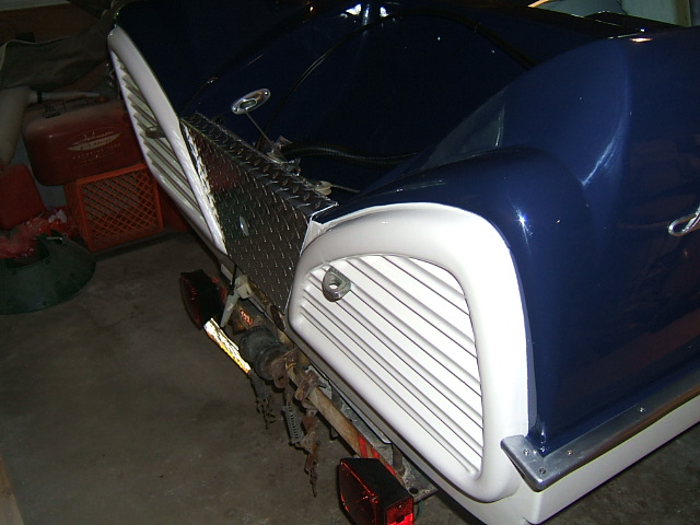

Retro54 Heres more pics.
Rick
Re:1960 Lake N Sea restoration questions 16 years 8 months ago #1179
Retro54 Found one more,
Rick

Rick, thanks alot! your 59 is slick! I bet it cuts on the water really well.... what for motor are you running? looks like a seahorse?
Re:1960 Lake N Sea restoration questions 16 years 8 months ago #1186
Retro54,Engine is a 59 Super SeaHorse 35hp.
Finished boat too late in the season to launch.
Still need to restore engine and trailer by spring.
