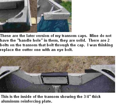

Had another thought. Instead of using the holes in the top of the transom caps, I am thinking of removing one of the bolts that bolt through the side of the cap, through the transom and through the 3/4" thick aluminum reinforcing plate behind the transom and replace it with a stainless eyebolt with a nut and washer on either side of the transom. Will see if I can find pictures of that too. If I can't find them, I will take some tonight.
*edit* Found some pics on my PC of what I am talking about...
Sounds like a much better idea to me, at least the pulling torque would be horizontal.

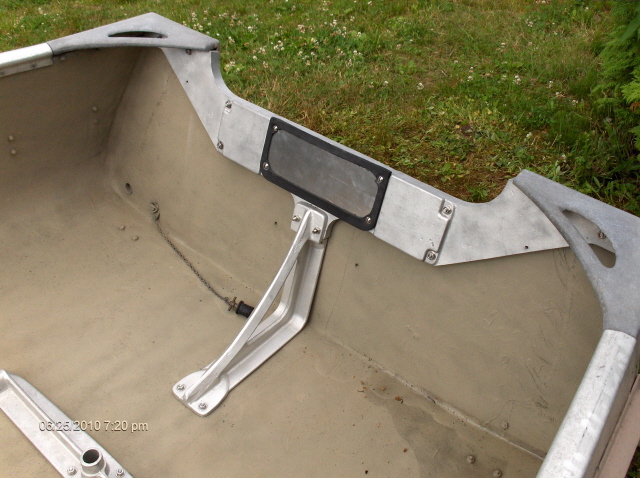

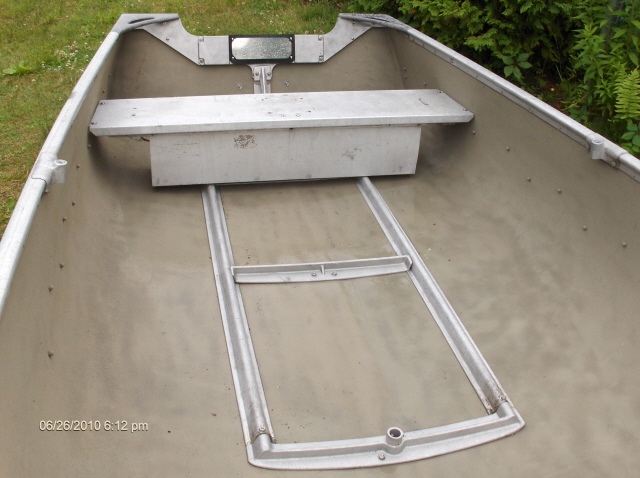

I also agree.Using the holes at the back of the transom, and through the aluminum transom plate is the only way I would try it.
Here are some pictures of my Herter's Hudson Bay. These should look familiar to you.
Re:Skiing behind a Herter's Quebec 16 years 3 months ago #11189
Thanks Matt. That is one CLEAN Hudson Bay. Looks great. I didn't know they had a flat floor. The Quebec has a recessed channel in the floor where the keeel bolts through. Great pictures.
