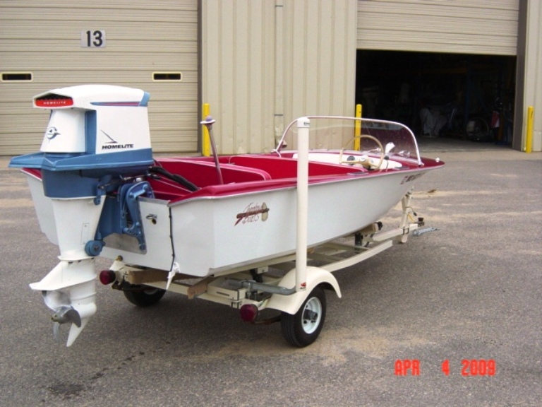

Roy Roger ran twins Mark 55 (40 Hp) on a 14 ft wood hull (yellow Jacket) In 1957 when the first fiberglass Yellow Jacket cam out he ran twin Mark 75 on it for a few days, Story was after 3 days of trials he went and had them put the Mark 55 on it. I bought a 1957 14 ft Yellow Jacket with a 55 Hp on it. When it is all said and done I hope to have twin Johnson Gold Javelin 35 hp on it

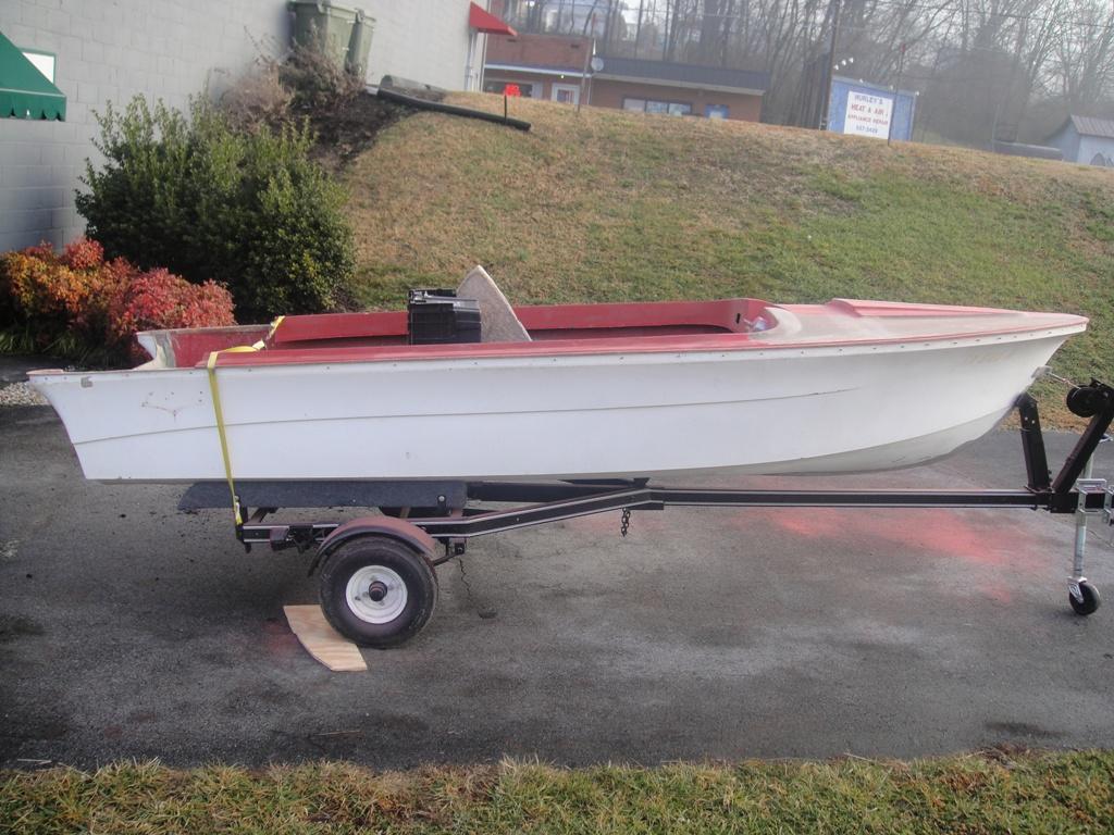

Your boat looks like its extremely light. I would suggest that you look for the lightest motor that'll do the job to your liking. A decent 55 would make that boat scream, but a lot of old boats get difficult to steer and control above 35-40 mph.. Most old boats do very nicely around 30-35 mph. I think a little OMC 28 would be great on there, you' be surprised how fast they are.

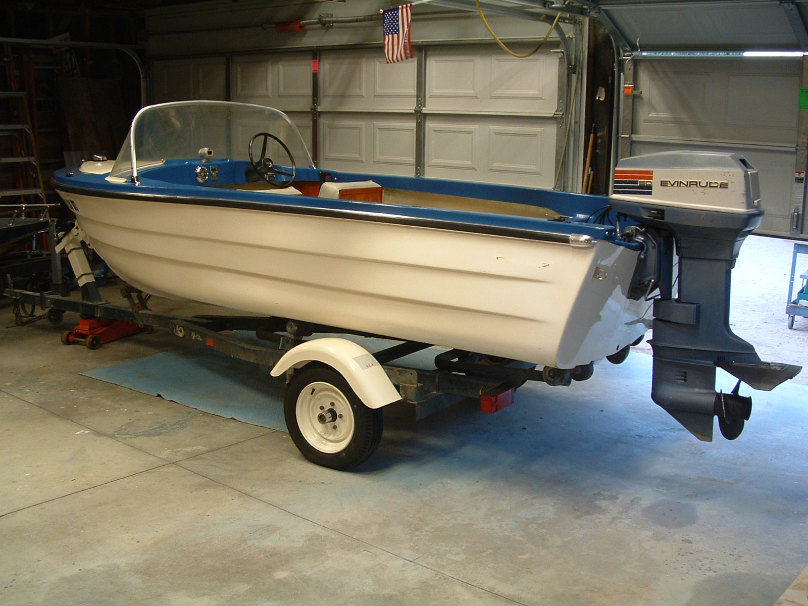

The motor turned out not to be a 55 but a 50hp short shaft evinrude, early 70s with push button shift. Its a pretty clean motor, he said it ran good but blew a fuse when u put it in reverse, im thinkin that should be an easy fix prob a bad wire or somethin?
Re:55hp evinrude+14' boat ? 16 years 8 months ago #1224
Yeah sounds easy. Probably just some wire coating coming off and the wire is grounding out or a wire is just loose.

That motor fails in forward gear, three wires run down to the coils, The reverse coil is the lower coil and may be shorted out,

Most of those older 14-footers were originally rated for 35-45 horsepower. Your boat looks to be a short shaft, but I could be wrong on that. Short shaft motors above 40hp aren't as easy to find. Many of the boats that get squirrelly with bigger motors are the old round chine boats. Yours has sharp chines, so that should help with stability a bit.
If you do put a 55 on it, be very sure the transom is rock solid.
Also, if you do find that the boat was originally rated for less, insurance companies have habit of not insuring you if your boat is overpowered.
