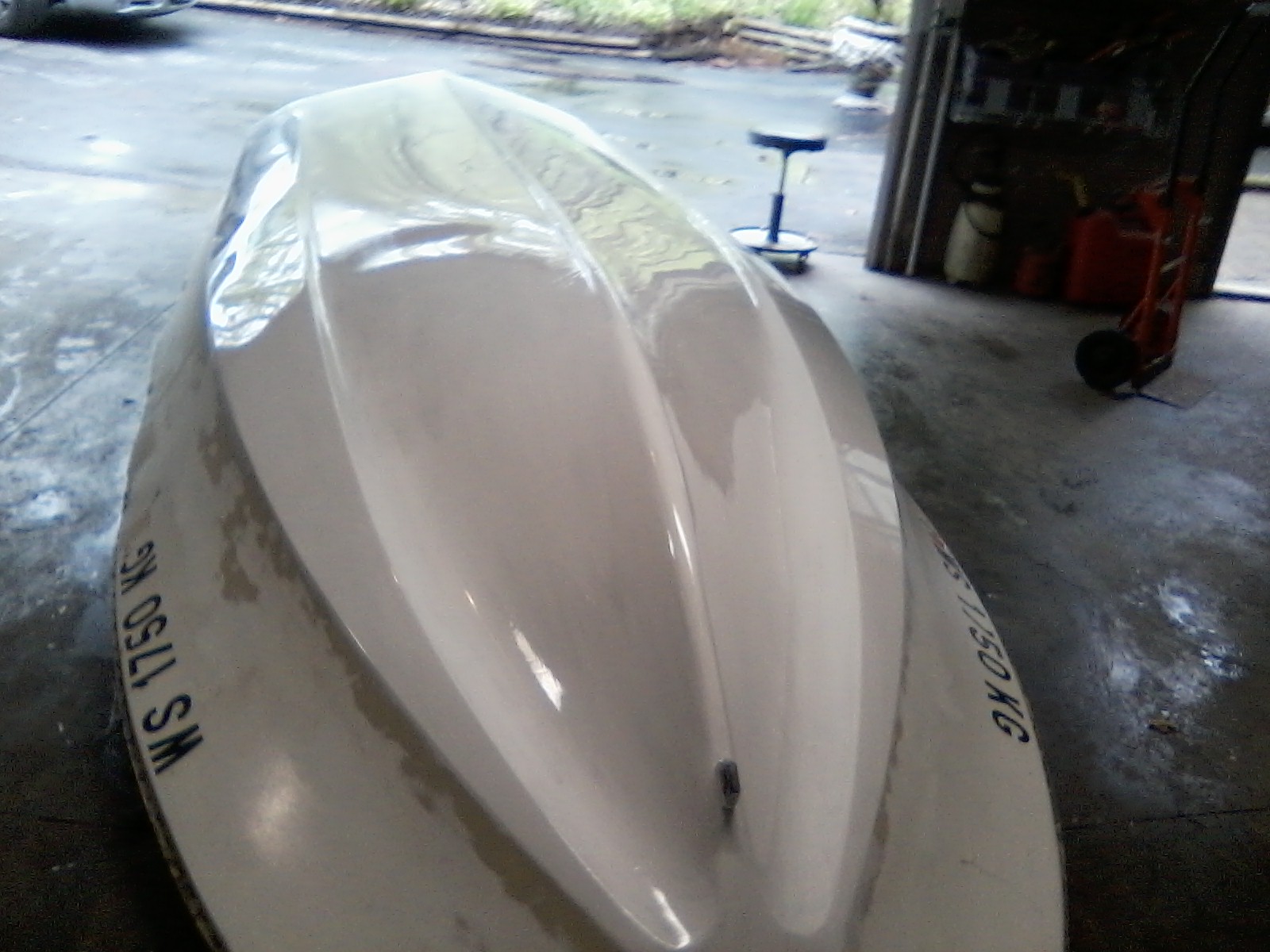

I've never did it before but after this morning I'm becoming a believer. Did the bottom of me latest project '64 Lone Star just to see if it could be done. That way if anything went south it would be sorta out of site. Used Rustoleum gloss white un-thinned. Weather was low 50's, cloudy. It will need a second coat but so far things look promising. Does it need a light sanding between coats?

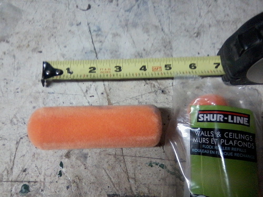

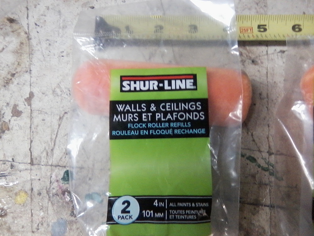

It looks great! I'm looking forward to doing ours. What type of roller did you use?
Re:Roll and Tip 11 years 4 months ago #109946
Watched some of the vids on youtube which helped somewhat but it's just not the same unless you 'sparement yourself on some unseen place.
I used a short fuzzy nap roller, 4", it's what I had in the shop. Videos say you can do about a 2 sq.ft. area at once but I found out that a smaller area works better. I did an area about 16" wide and half the width of the bottom. Immediately stroke it out and blend it into the previous section. Nice thing is that if you get a sag you can still brush it out minutes later.

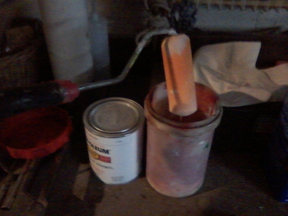

Did a roll and roll this afternoon. My opinion is that it's much easier, less pressure to brush out and a smoother coat. Have to wait until tomorrow to see how the final look and feel is.
