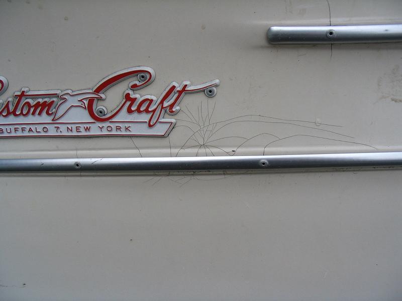

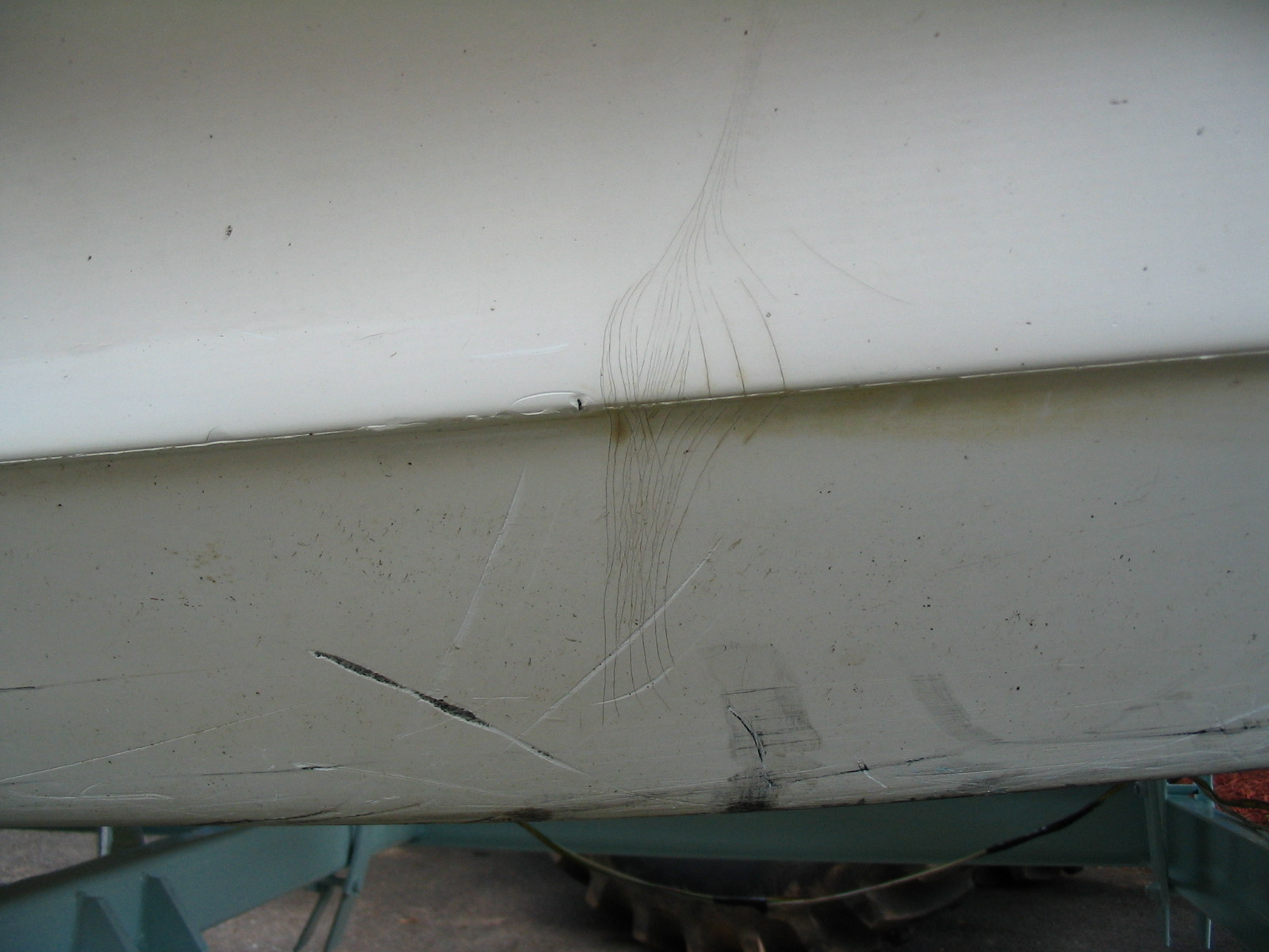

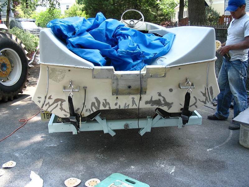

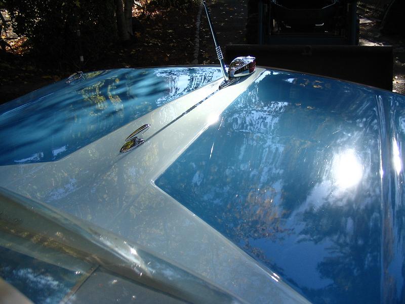

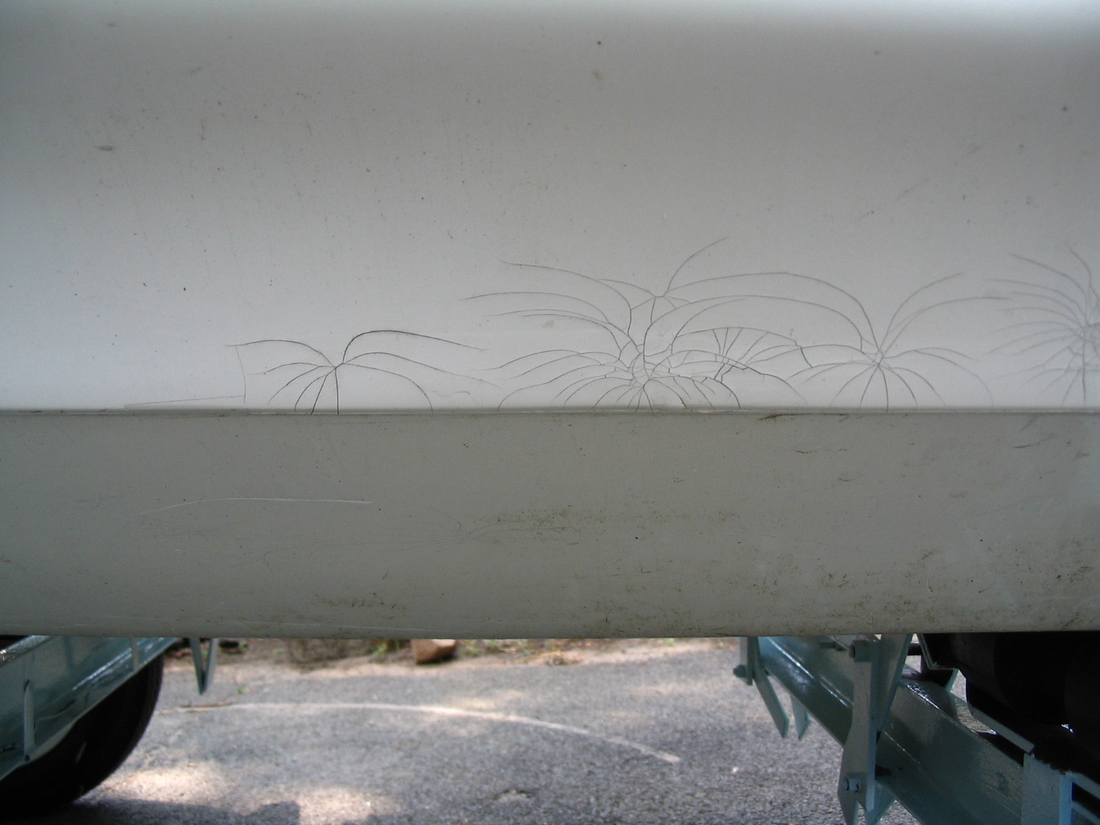

del is absolutely correct. my boat was full of of spider/gelcoat cracks when i purchased it. i sanded out these cracks and probably did not go deep enough. had it painted with an epoxy primer, then painted by maaco (3 coats baked in what they call an oven.) this was 10 yrs. ago. the finish/shine is like it was done yesterday. however after a few times out on rough water the cracks reappearedin some of the places. some pics. ron : : : : as you can see in the last pic.the crack lines ..i guess i didn't go deep enough. should of had a professional do it. the finish today.
