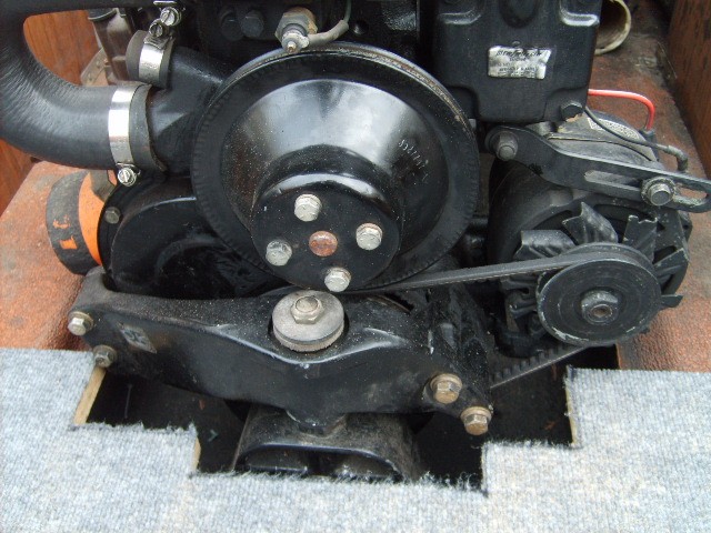

I just bought a 1974 Silverline Aquatica with the 165 HP I6 Mercruiser motor. The motor runs great, but I noticed that the v-belt doesn't go over the water pump pulley, it goes around the crank pulley and the alternator but just skips the water pump. Now I am no master mechanic, but I believe the belt should also be running the water pump. Am I missing something or is the belt missing something?

Mi sure someone around here has the same engine you speak of, but any case can you provide some pictures just to be sure.

Added to original post

Does your crank pulley have two grooves or one? It's not uncommon for the alternator to be driven off a separate belt, with another belt running the water pump. You ARE missing the water pump belt if I'm looking at your pic correctly.

Mark, there is a second groove on the crank pulley, but it doesn't line up with the water pump pulley or the alternator. The water pump pulley lines up perfectly with the alternator pulley.

Here is a link to a boat that is for sale but it has a good picture of the belt route if you page through the pictures. Hope this helps.

Thanks Saber, that is exactly what I have, I am going to put a new belt on.
