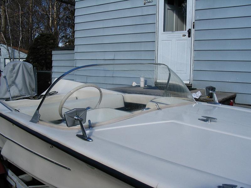

is there any NEW way to polish a windshield, other than to go thru those 4 agonozing steps tha jag posted years ago. don't want to use a disc sander for the fear of burning the plexi-glas. i've never used one. i've asked a few body shops around here but they won't touch it. ron

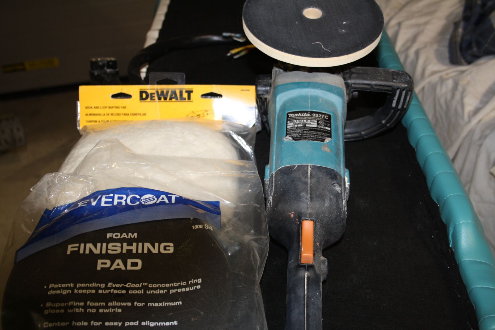

Re:windshield polishing... 11 years 6 months ago #108059
I have to admit, I have not read Jags article, but your windshield does not look too bad. I used a polisher on my windshield ( do not use an angle grinder, they spin way too fast ) I used a rubbing compound first with a wool bonnet, then cleaner then polish with a foam pad. You can probably rent a polisher. I would say you would want it in the 1000 to 1500 rpm range, the weigh of the buffer is probably enough.
Good luck!
Cheers
Bill

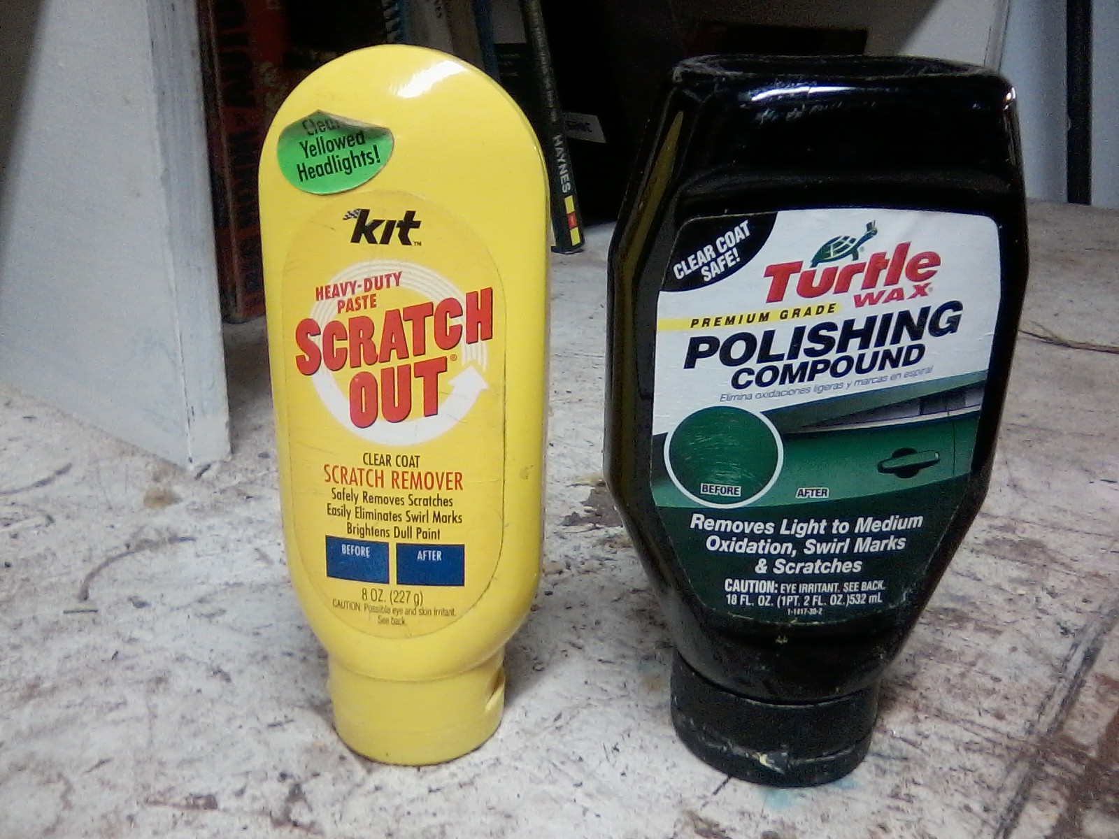

Re:windshield polishing... 11 years 6 months ago #108063

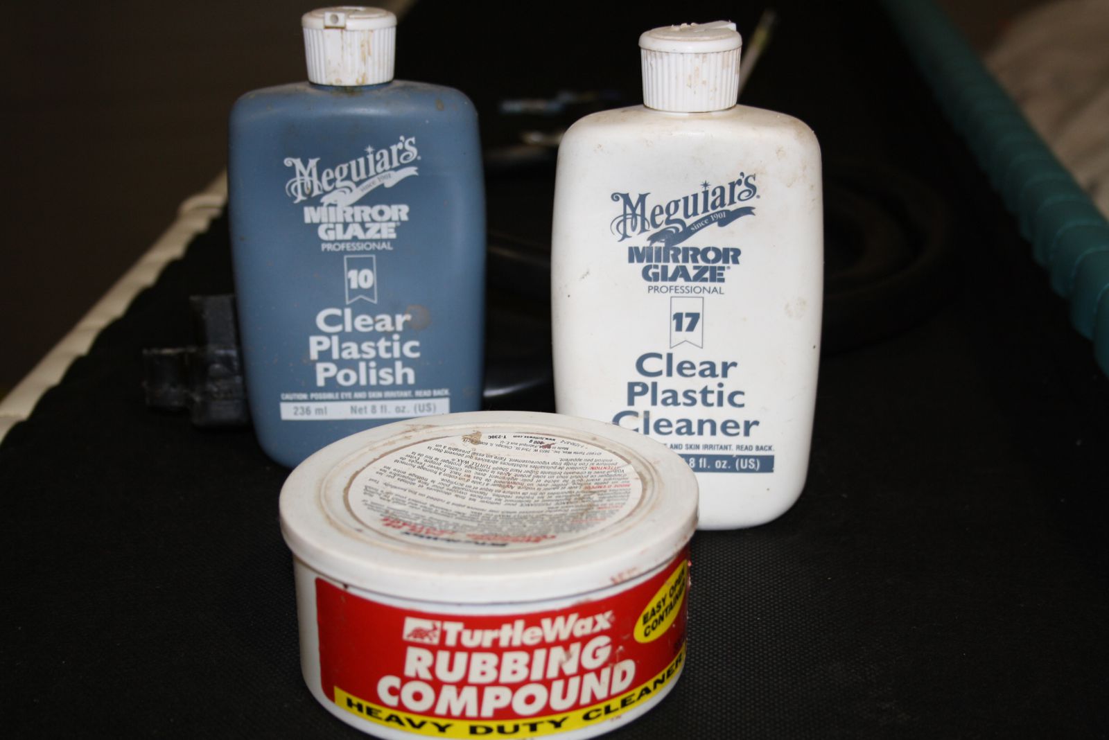

Ron, I don't trust myself with my 'lectrick polisher, probably melt a hole in the windshield. Here's what I use for most of my projects. Get 'em at a local auto store or big box. It doesn't take much elbow grease either. You can repeat the steps over if needed. When finished just put on a coat of car wax.
BEFORE
AFTER
