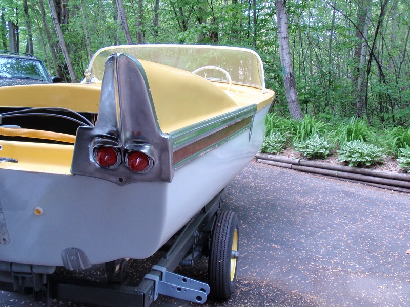

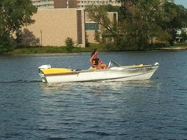

I have a 1961 14 ft Crestliner Mustang runabout that weighs 320 lbs)...its always been heavy at the rear with an outboard, two tanks of gas, and a battery. The boat never really wants to plane out (especially with anyone in the back seat; It has a bench seat in the front and one in the rear). I've been thinking about putting maybe one gas tank up under the front deck where dry storage is intended...but it'd be a pain in the rear to get in and out especially with it being full. There isn't enough room to fill it up where it'd set unless I drill a hole in the top of the deck and installed a gas cap. I don't really want to do all that so I've decided to just put my battery in the front BUT I will have to extend my battery cables 10 feet; I'm talking about the cables that crank the outboard. Is this ok? Because I know the longer the cable, the less fire there is. Will this burn anything up? What size of wire do I need to add on 10 ft to the cables? Electrical expert advice needed here. Thanks in advance.
