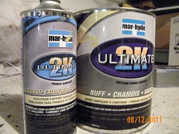

Re:Do I really need primer? 11 years 7 months ago #106013
All the same high build primer I used on previous jobs. I'll just shoot a light coat on the whole thing for the adhesion and even coverage. There are areas where the PO did repair some minor nicks and gouges. You know how they do seem to turn up after you think a perfect paint job was laid. Odors on this stuff will send you to the moon or an early grave if you're not careful.
