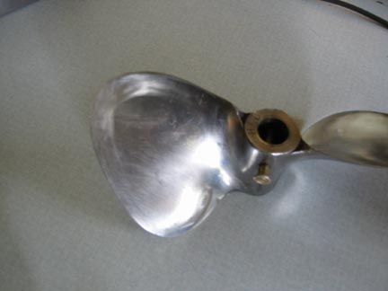

this is my disclaimer....Firstly I do not know how to cup a prop, I do not own any appropriate tools to cup a prop, I do not advise anyone to cup their props, take it to a prop shop, that being said I do know how to make my props run faster, right or wrong I do not care, it makes me faster and that makes me happy
cupping an aluminium prop you can increase the pitch by one
bronze & SS props can be increased the pitch to about 2
aluminum is very difficult and should certainly only be done by the experienced, or prop damage is likely
its not quite the black magic its made out to be, the trailing edge of the blade is curled to add the additional bite & pitch
see the photo of the SS blade I pounded over my trailer hitch to make some changes because this prop wasnt getting the job done, this pounding did make a considerable improvement so I have begun to sand out the hammer marks to polish it back up again
I experimented on a cheap broken prop my first time , then a second cheapo prop to see the affects, I was happy and occasionally employ this tactic
I wouldnt do this to a really expensive prop because I dont know what Im doing :woohoo: but I cant help myself, I just want to go faster
