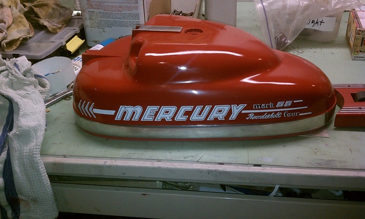

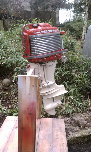

I am just restoring am Mark 78, ordered all the paint, decals and medallions from Peter at NY Marine.

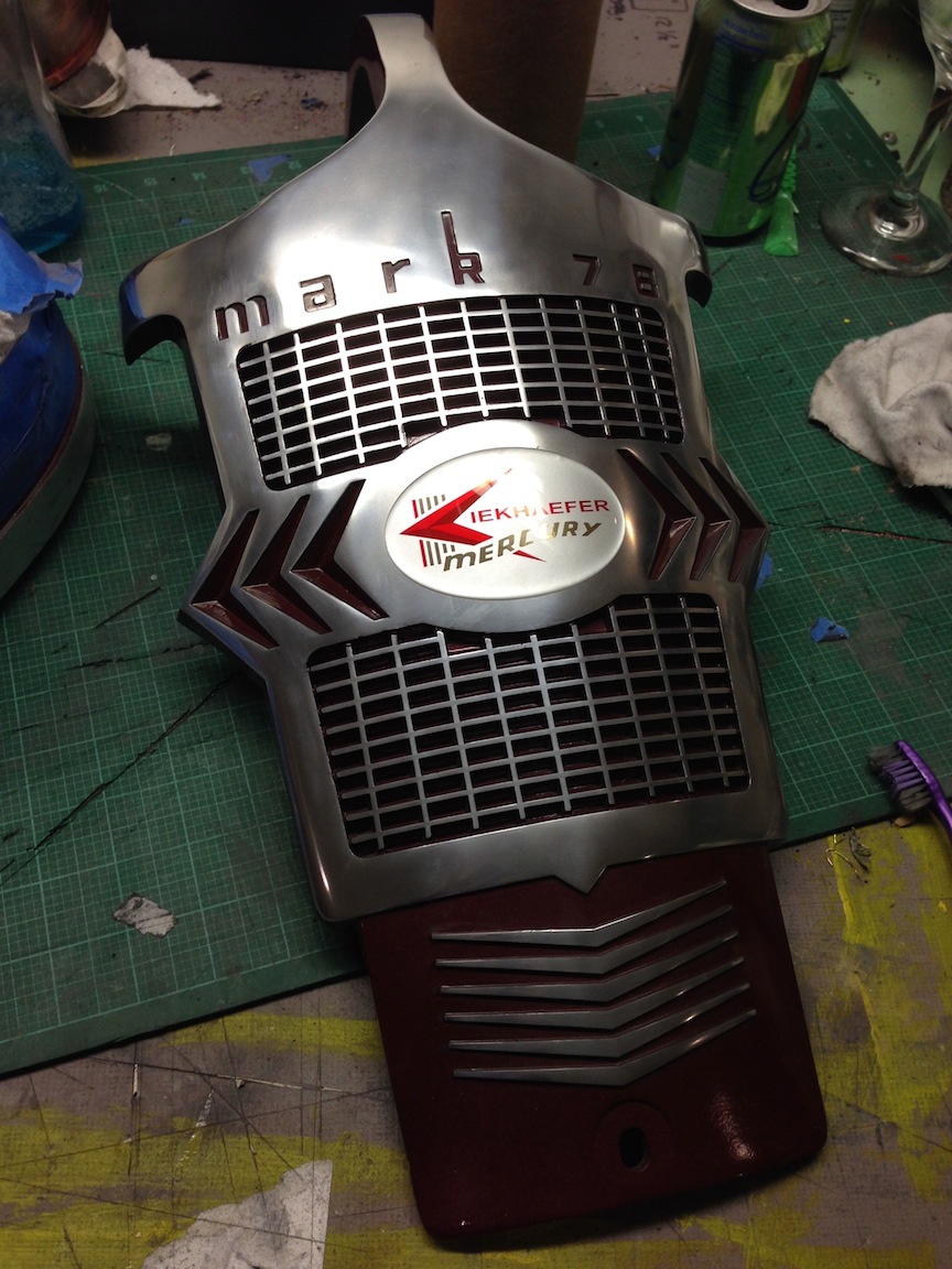

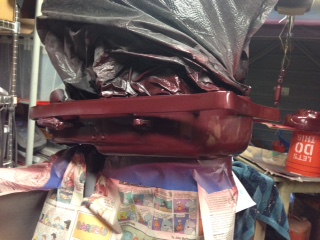

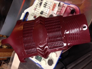

Re:Advice on painting outboard 11 years 8 months ago #105478
It is fairly simple, but lots of work.
Strip motor to bare metal. Bead-blasting was needed for the front cover above as it had little voids I couldn't get in to. A good stripper and lots of elbow grease using steel wool and metal brushes works for me. fill and sand any dings that bug you, I live with a certain amount of wear.
I am a freak on a proper paint job, refer to the web and this great site to find out what your motor should look like. I mask off all items that do not get painted. I go ahead and paint the bolts but take them off (one at a time) and strip after painting. If you want to separate the powerhead from the lower unit that is recommended (but I don;t always do that). I do take off everything else and paint separately.
once you are down to metal I clean all with a degreaser and an aluminum prep solution like Alumaprep & Alodine.
This is the time you will need the proper stuff from Peter at NY Marine. Consult with him on the type of paint you want to use (I use his Alkyd with catalyst). He will get you the proper amount of self etching primer. Cover the metal liberally and sand any rough spots. Make sure all metal is covered, this can be tricky as there are some tough spots to reach like behind the rail on the bottom cowl. I use a small detail gun with a regular compressor. Strain all your paint, mix well and no drips.
After painting I then start to take off the paint in the bare areas. One has to be careful here as you can get chipping if you are not careful. I always have a problem with the top of the rail on the bottom cowl.
Apply decals and medallions according to Peters instructions, never clear coat.
Then, take a wrench and hit your beautiful new paint job good and hard. Now you don't have to worry about any future damage...

Thanks for taking the time to provide all the details headley. You did an awesome job on the 55! Thanks for your inputs Dave, satx and jb. This site and the support provided from people on here is fantastic :cheer:
I don't think I have the energy or willpower (I wish I did) at this point to separate the bottom cowl from the mid section. However, is there an easy way to separate the clamp/swivel bracket from the rest of the motor without dropping the midsection?
Also (going back to the energy and willpower problem), can I get away without taking it down to bare metal?

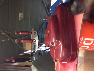

Here's a pic of when I did my '69 650. You can see the different stages the other guys are talking about. Top is finished, bottom is in etch primer and the skeg is bare aluminum. Like they said above, its a lot of elbow grease but worth it in the end.
-Brian

Nice restoration NJ.
Looks like you didn't disassemble it for the painting?
I was looking at your other pictures, how did you resolve the cracks in that steering wheel?
Re:Advice on painting outboard 11 years 8 months ago #105595
  • NJTriton
  • NJTriton's Avatar
  • Posts: 289
  • Karma: 12
No I didn't disassemble it. I'm not going for a show presentation so I didn't see a need to go that far. The steering wheel I dug out all the cracks out down to the ring, filled it back up with epoxy. Sanded, primed and painted. Still looking for a good way to reproduce the center cover though.

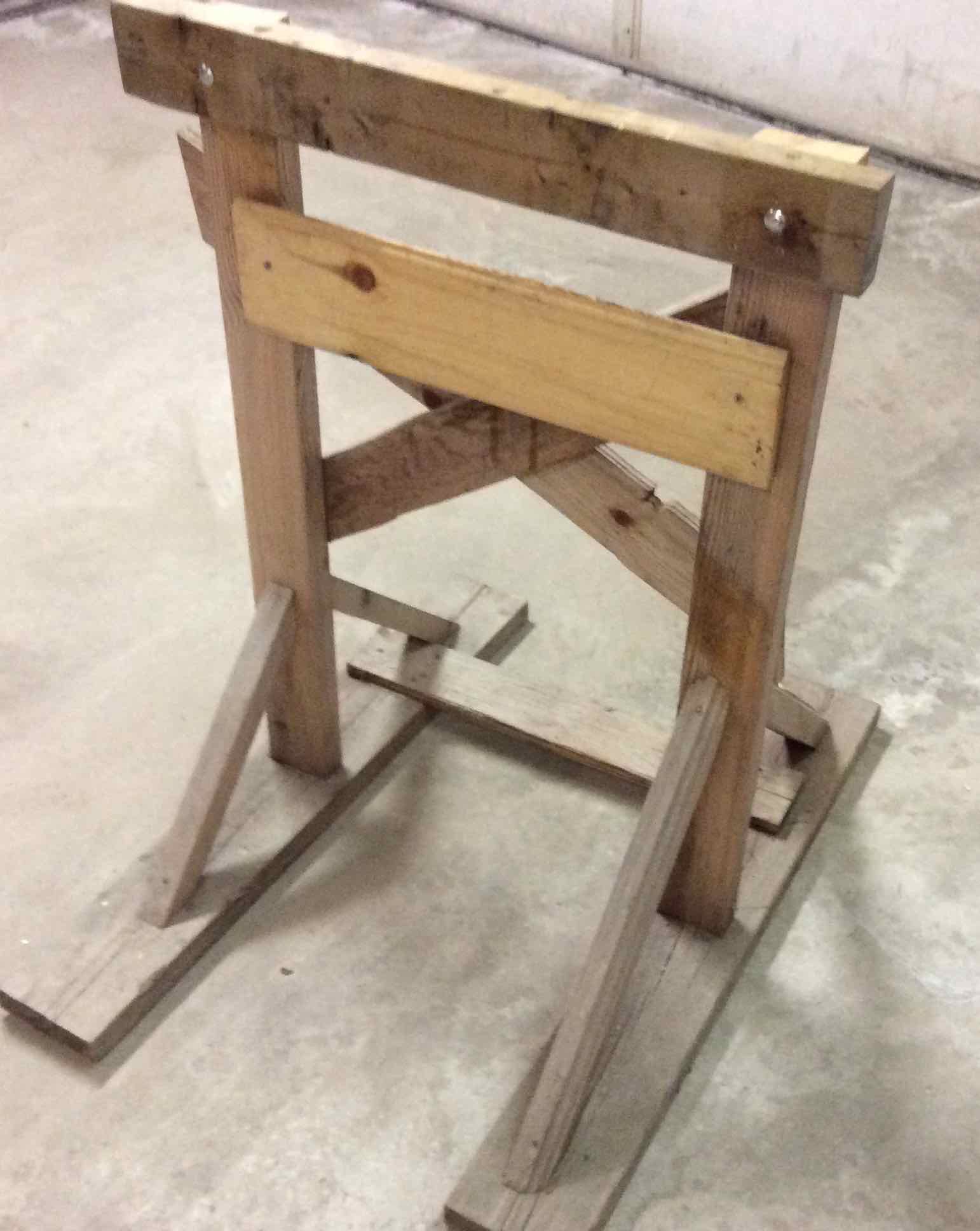

once you get the motor off,this may help you to get sanded and painted,it also rolls so you can roll it out of the way when your not working on it,john
www.fiberglassics.com/fiberglassics-forums/home/main-forum/step-by-step-motor-stand#103222

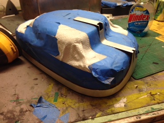

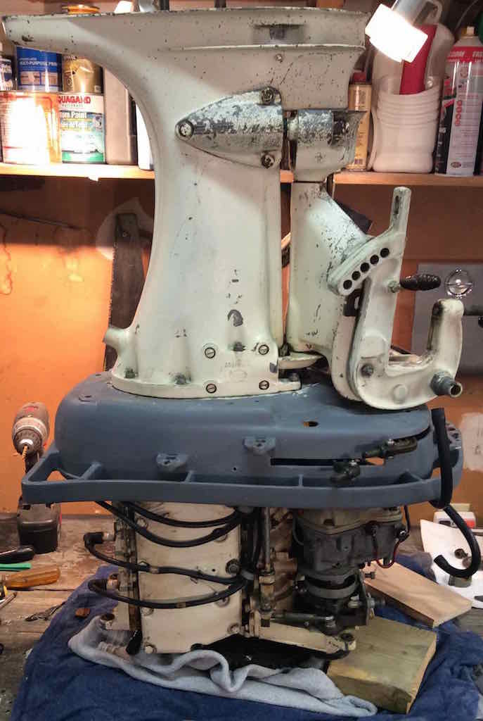

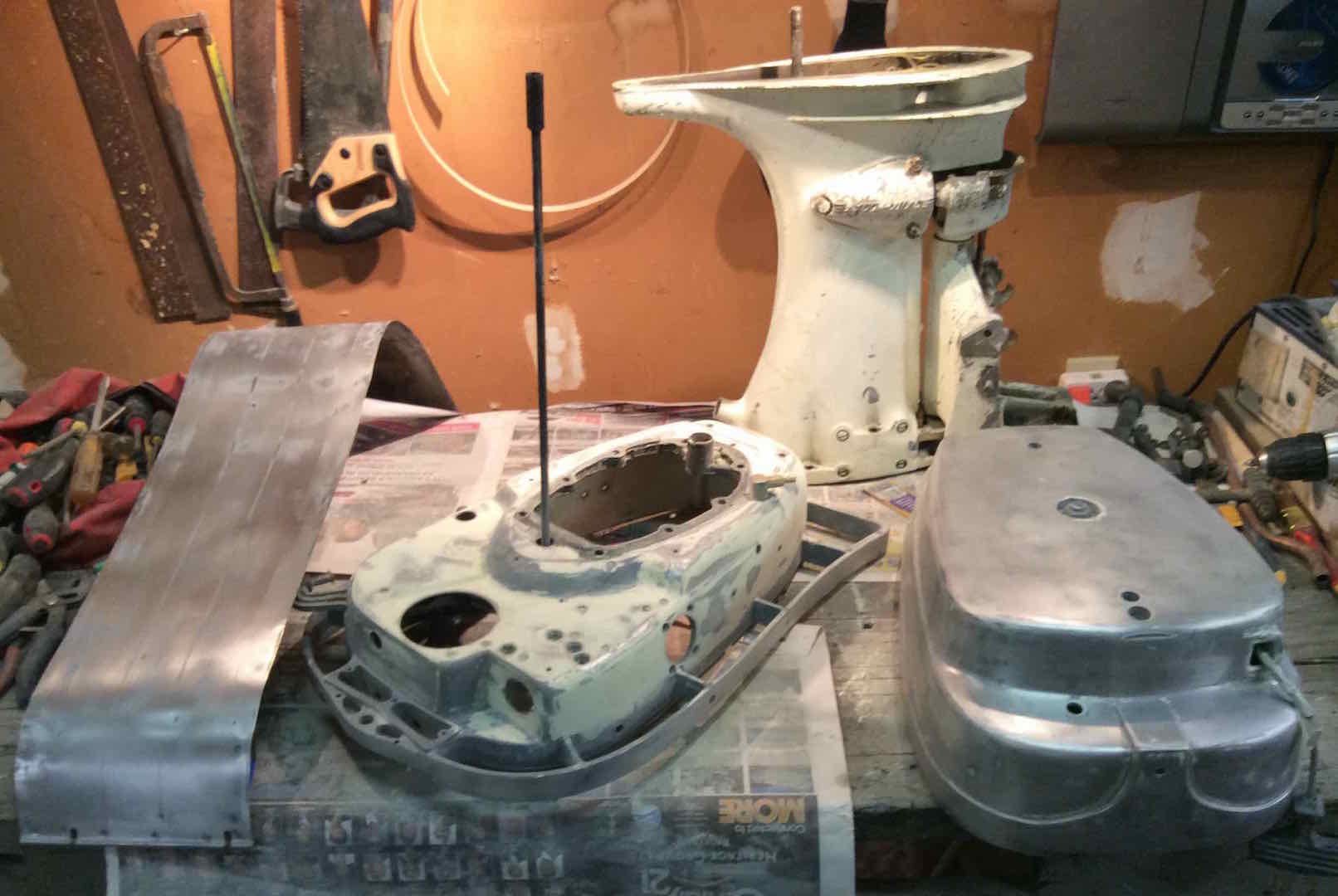

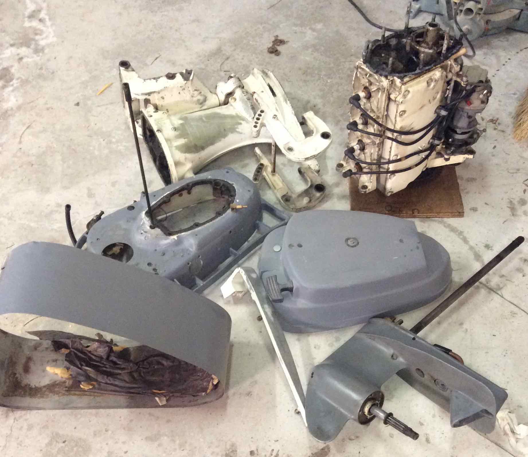

Thanks for the reference John. I had already built one....but yours is so much more professional than mine :unsure: . Here is my stand and a couple of pictures of the progression.
(The primer coat is something that I put on last year. Due to some advice I got, I'm sanding it all down again to remove as much of the original paint as possible. So, by looking at the progression, it look like I'm working backwards....which to a point, I guess I am :dry: )
Re:Advice on painting outboard 11 years 7 months ago #106025
How much sanding did you have to do to the lower housing and skeg area? Mine is all rough cast aluminum on my 400. No corrosion but not at all smooth. It is like an orange peel, not paint orange peel but little dimples.

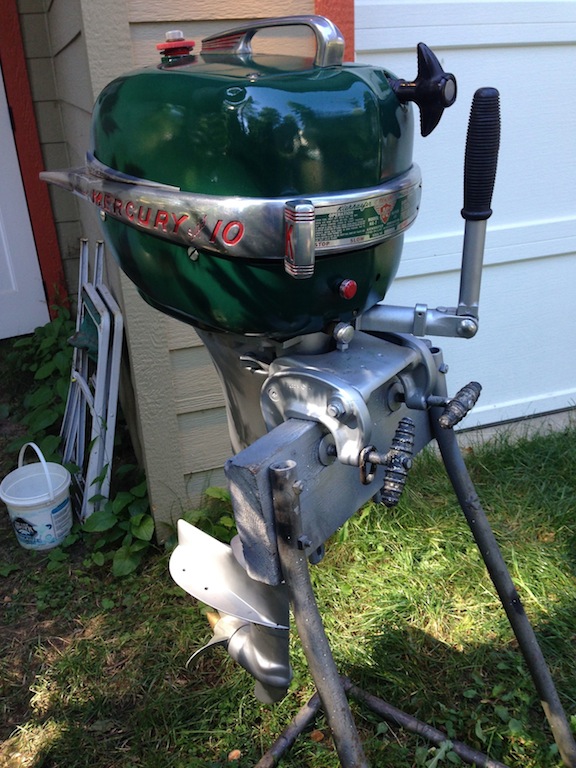

here is the merc 400 i painted for the 64 cc sunray,some people love it some hate it
Re:Advice on painting outboard 11 years 7 months ago #106038
I'LL never get tired lookin at tht CC.
I'm sanding down to the bare metal....in most places that I can reach. So..."how much sanding?"....until I cry and start throwing things!
