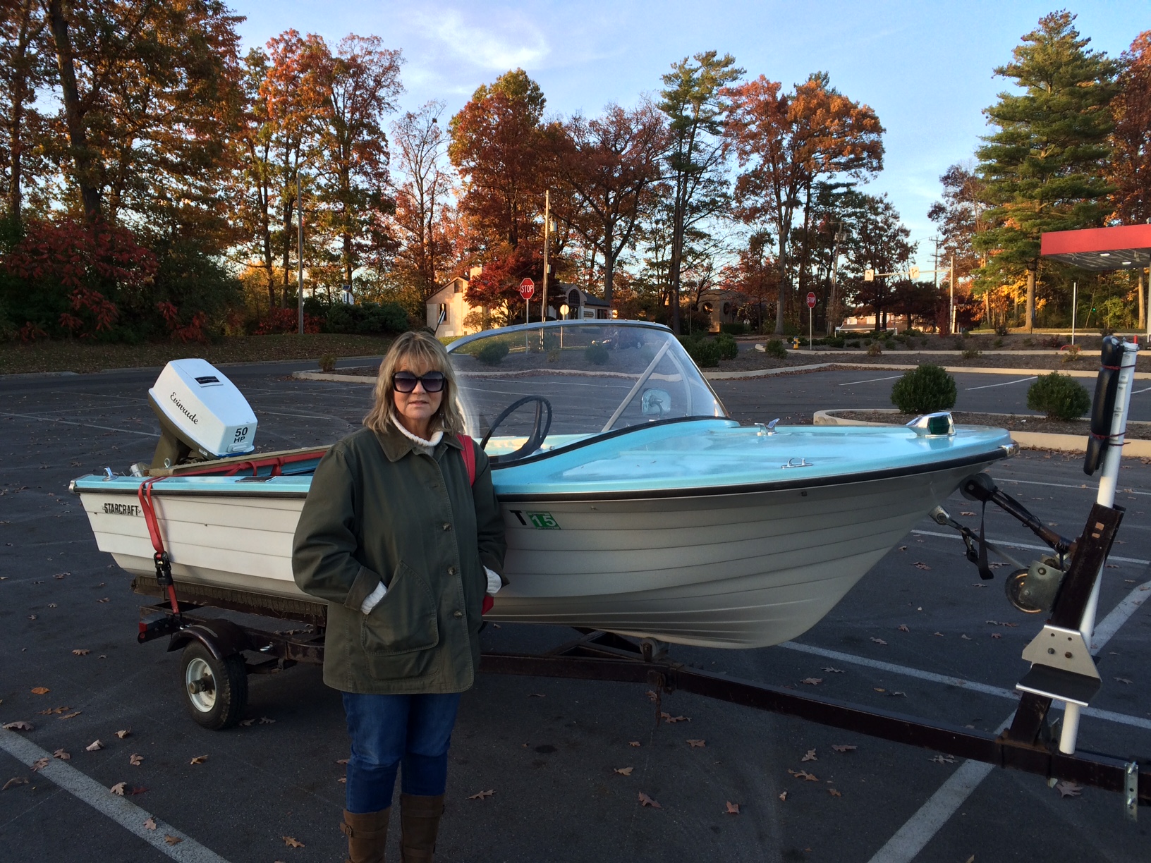

Incidently, the boat appears to be fully original, including the bilge well. That well is about 12" X 6" and 6" deep. The holes I mentioned are in the well, approximately 1" up from the bottom, and the entire setup seems to be part of the original design.
I have attached a photo of the boat which was taken on the day we acquired it. The lovely spokesmodel is my wife.

Re:14' Starcraft Mustang - 1968 11 years 5 months ago #103691
Nice boat, like that color. Hopefully rain water won't go down in there, normally during boating you shouldn't get a lot of water in the boat but maybe after a good drain and dry tape them up unless it's covered.

So I clearly didn't remember correctly.... Nice original model and the boat's not bad either ;)

WELCOME ABOARD. - NICE rig, too.

Nice looking boat cwd. That is a great color.
