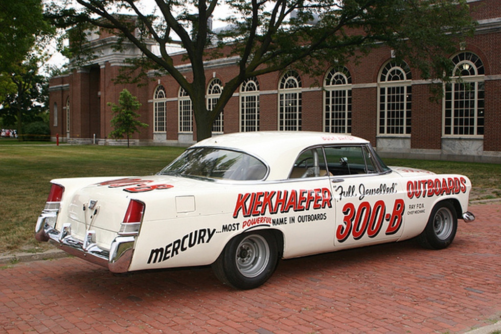

I was aware that Mercury was late getting on board with a stern drive offering following the Volvo Penta success with this new technology. What’s interesting is that the Volvo Penta debut of the AQ80 in 1959 was based on a design by Charlie Strang who at that time was chief engineer at Mercury.

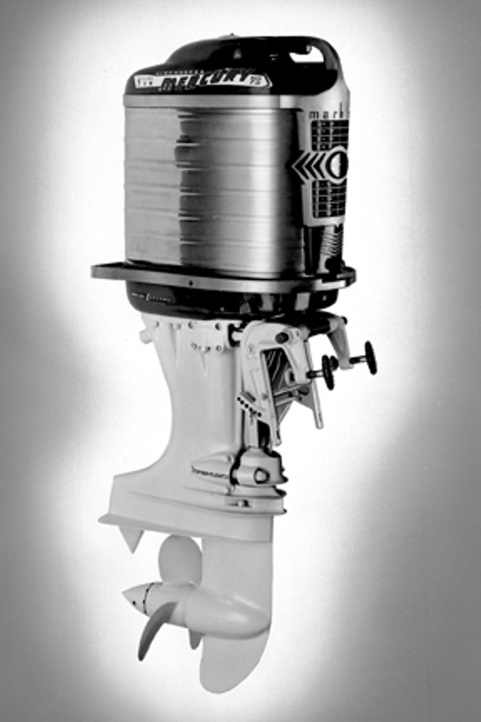

Charlie showed Mercury President Carl Kiekhaefer his ideas for the stern drive in 1951. According to Charlie, Kiekhaefer responded:
“That is a horse shit idea! Now, if you took the engine and you stood it on end and put it on top of the gear box, you’d have an outboard motor. Then you got the right touch!”
Years later Jim Wynne, who was also an engineer at Mercury, and Strang planned to leave and start a company to build stern drives. Charlie backed out at the 11th hour but gave Jim his blessing to take the idea and run with. Wynne left Mercury and developed a prototype and his design was awarded a patent. He took it to Sweden and Volvo Penta was licensed to manufacture what was labeled the Aquamatic Stern Drive.
Jim Wynne demonstrating the manual tilt function.
And it's a matter of fact that it is Charlie Strang we can thank for our coveted “Tower of Power”.
Charlie cut one cylinder off of two 4-cylinder blocks and welded them together. He then welded three 2-cylinder cranks together and with an ignition system made up of automotive parts he put it all together and ran it.
Another interesting fact here is that this was all done behind Carl Kiekhaefer’s back. Charlie’s directive was to work on nothing but the Kiekhaefer Mercury race cars which at the time was Carl’s priority for the company.
As seen here they were very successful and it has been said it was Kiekhaefer's participation in the sport that helped elevate stock car racing to a more professional status.
As a result of the emphasis on the race cars much of the work on the six cylinder outboard motor was done after hours in secret. When they finally finished it and put it on a boat they showed it to Carl. He took one run up and down the river and came back and said, “It speaks with authority. Let’s build it”
Nine months later in 1957 Mercury Kiekhaefer delivered the Mark 75. And this 60 HP motor was the most powerful production motor ever manufactured. Thank you Charlie!

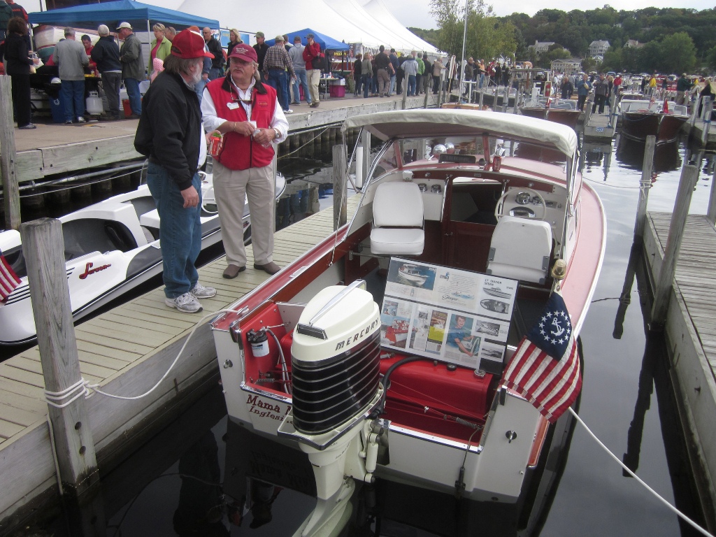

On Friday before the show opened my wife Mary and I were strolling about the harbor and as we passed the launch ramp there was a boat launching sporting an old white Merc. I pointed out to Mary that the motor was similar to the Merc 800 on our ‘Mama Mia!’. She looks at it and she doesn’t know what the hell she’s looking at other than it’s a boat motor and it’s white.
Now there is an older gentleman standing there as well and he chimes in “Oh, You like those old Mercury motors?” I said “Yeah I love these old Mercs, I have a few of them”. The gentleman responds, “Well that’s real nice to hear because I designed that motor” He then introduced himself and it was none other than Charlie Strang. OMG. So Charlie and I get to chatting up old Mercs and after a while Mary pokes me in the ribs and said I should tell him what she had once said about that big old motor on our boat.
Before I finish that story let me tell you this. I did all the restoration work on Mama Mia! out on the driveway in front of our house. I got to a point where she was looking pretty good and I wanted to show off the progress. So that evening I invited Mary aboard and we sat in the boat out on the driveway and enjoyed some adult beverages. Mary commented on how big the old Merc looked and suggested that the design resembled some of her kitchen appliances. Yeah OK I think I can see that too.
So we mention that to Charlie and he says that’s an interesting observation and goes on to tell us how they actually came up with the cowling design for the Mercury Six. He said they had the powerhead fully designed and functional but still needed to design the cowl. They were working on it late one night because during the day all their efforts were focused on the race cars. According to Charlie one of the gals brought them dinner in a Nesco Roasting Oven. They ate their dinner and took a closer look at the modern lines on that kitchen appliance and sure enough the Nesco Roaster was the inspiration for the classic looks of our Kiekhaefer Mercury Outboard Motors.
Right on Mary!
It was the following year again at the Geneva Lakes boat show when I was aboard Mama Mia! talking to a guy about the restored Merc 800 on my boat. I find it interesting when showing our 59
Glasspar Seafair Sedan that the old Merc draws as much attention as the boat itself. But any way I'm still talking about what I thought I knew and mentioned that the 1961 Merc 800 was the largest outboard available at the time and 1962 was the first year for the Merc 1000. I continued to spout my ignorance when I made the statement that the motors were essentially the same other than then the increased displacement from 76 CI to 90 CI.
It was at that moment when I noticed an older gentleman standing there shaking his head. He said “No, the block on the 1000 is 2 inches taller due to the increased bore”
Yeah it was Charlie, I stand corrected.

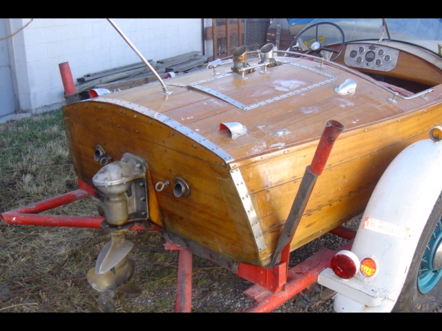

First I/O by Johnson Motor Company in 1930
Glasspar brochures mention an I/O dealer option first in 1962 and as a factory option in 63.
