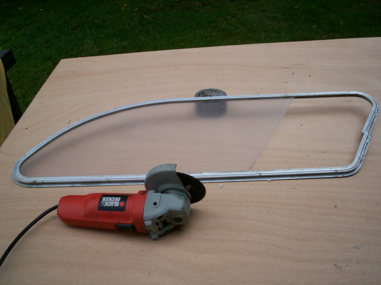

Found some acrylic material for the windows on my Dorsett Monterey. Cost $40 at the local "Jerry's" (like home depot) in Eugene, Oregon. I bought 1/8 inch. Tried several methods of "cutting" and finally settled on an angle grinder with a very thin grinding wheel. Acutally melts the product rather than cutting but very easy to follow the cut lines if you go slow and carefully. Deburring is simple and the product has protective plastic wrap on both sides. I actually bent the material around the old windows to capture the pattern. Very flexible. I did, however, break one piece when I let is fall over the cutting table and the weight of the material snapped it in two. No problem if I kept most of the weight supported by the work table. Says it has a 10 yr sun life. Hope I do! Mike

Neat stuff. I think if a person had a band saw, (I don't), you could use a fine tooth blade and it may work on that stuff. I bought a .188" thick piece for the center windshield door on my Starflite and promptly broke the first piece trying to use the "score and snap" method recommended by the store salesperson. Ended up using a grinder and cut-off disc as you described. (Kinda messy, but it gets the job done!)
