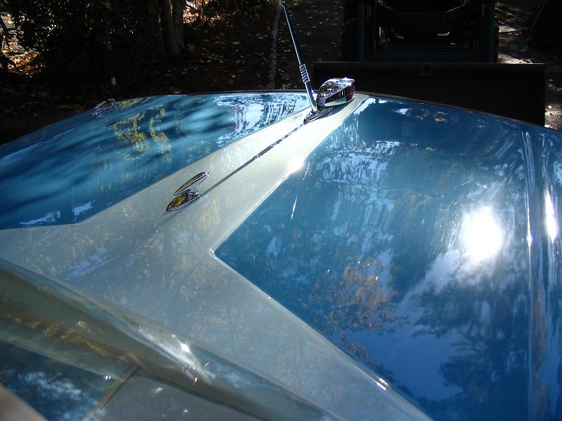

BROUGHT my paint (petit easypoxy) to maaco and they sprayed it for me and baked it in an oven. no problem yet. it was done in 2005. ron ;.
