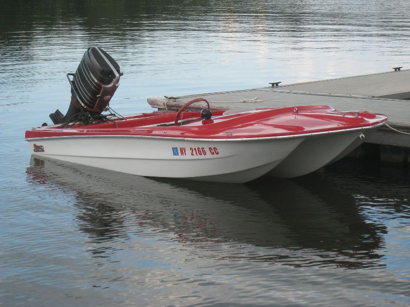

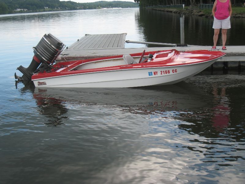

Over rev with a 19 pitch 2 blade aluminum, do the same with a 22 pitch 2 blade cupped SS prop. ?? Put the 21 pitch 3 blade aluminum on after a very short test with the SS 22, at least I can get to about 5000-5200 at WOT with the 3 blade 21 pitch prop, but mostly with the motor tucked right in to the transom. This video is of the 21 pitch 3 blade aluminum prop starting about 5 grand and bumping up over 5200 as I very slowly trimmed it out. Got to 37 mph.
Smart Tabs shipped today. May wait to put them on before I take the boat out anymore. I'm starting to worry that I'm gonna screw my motor up with all this over-revving, or maybe even detonation I can't hear. This has become very frustrating!

Thanks for the side views, Frank. Balance looks ideal, not too much stern squat. That cool 2 blade took a step backwards, so the Cat obviously needs blade area. If you can try one, a 22 or 24 pitch Bass Boat style prop with more rake to the blades and mucho cup, or one with four(!) blades would be my next test. Still think something isn't adding up- 100hp, 300 lbs. boat, with tunnels, should go faster with 21" pitch. Had a 14' Checkmate V-bottom with 125hp Evinrude, ski setup, 21 pitch stock OMC aluminum prop, boat weighed 550 lbs. Ran 58 GPS mph at 5700 RPM. I would think your Cat should be in the mid to upper 40mph area.
