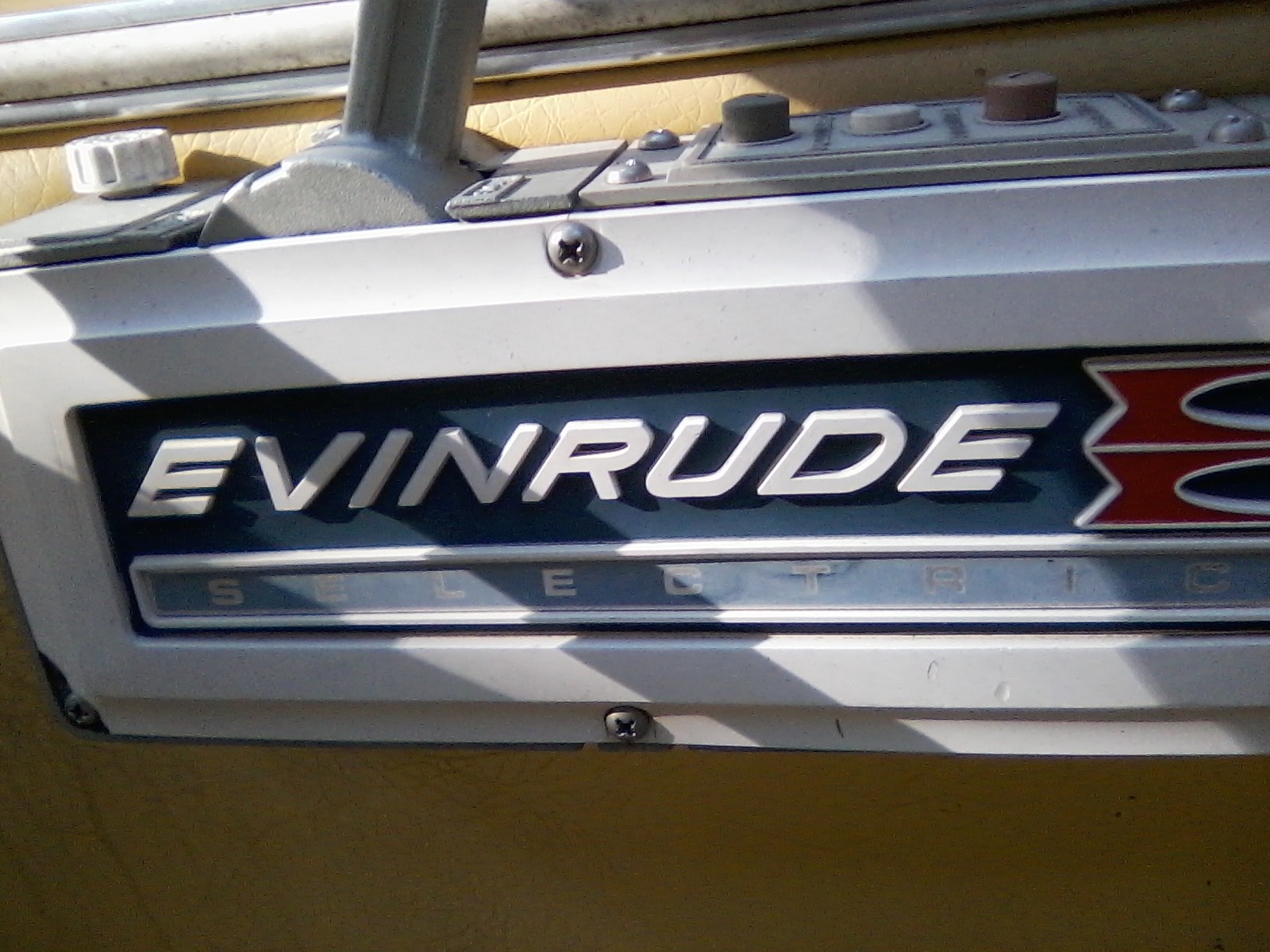

Right on Bob. Reg 80/90 weight gear lube will kill a selectric.
By the way...This ones on the market with my 100hp Starflight :)
Re:'64 Evinrude Oil and Lube conversion 12 years 2 months ago #100041
I was planning on going with Silver - Bay suggestions. I don't know if mine says selectric on it but yours looks very similar to mine. My has a turn knob on the bottom and an idle speed knob on the front. I still have the manual and it does say use Type A and C and SAE 90 oil on the engine so I am going to go with that.
