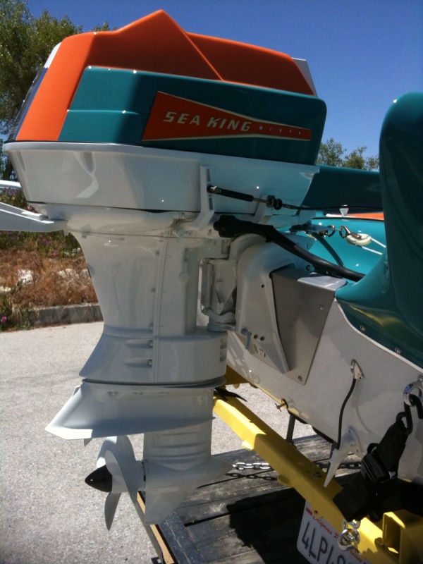

So far.... we have found that all the parts from 1959 & 1960 Johnson and Evinrude 50 HP motors are interchangeable with our 60HP Sea King.
I believe that Gale would be also.
Larry

Re:60 hp gale questions 11 years 4 months ago #111766
Larry,
Your Sea King IS a GALE.

Re:60 hp gale questions 11 years 4 months ago #111881
55,
The Gales had the newer style pointed lower unit as shown in Larry's pic.
Not sure whether it was the 50 hp or 75 hp powerhead.

Re:60 hp gale questions 11 years 4 months ago #112100
check this out
Re:60 hp gale questions 11 years 4 months ago #112108
  • ed-mc
  • Posts: 1482
  • Karma: 235
  • Thank you received: 131
63 Sabre wrote:
check this out
Them's the ones!!!! :P
