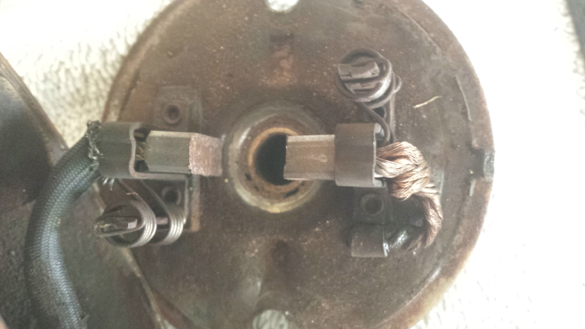

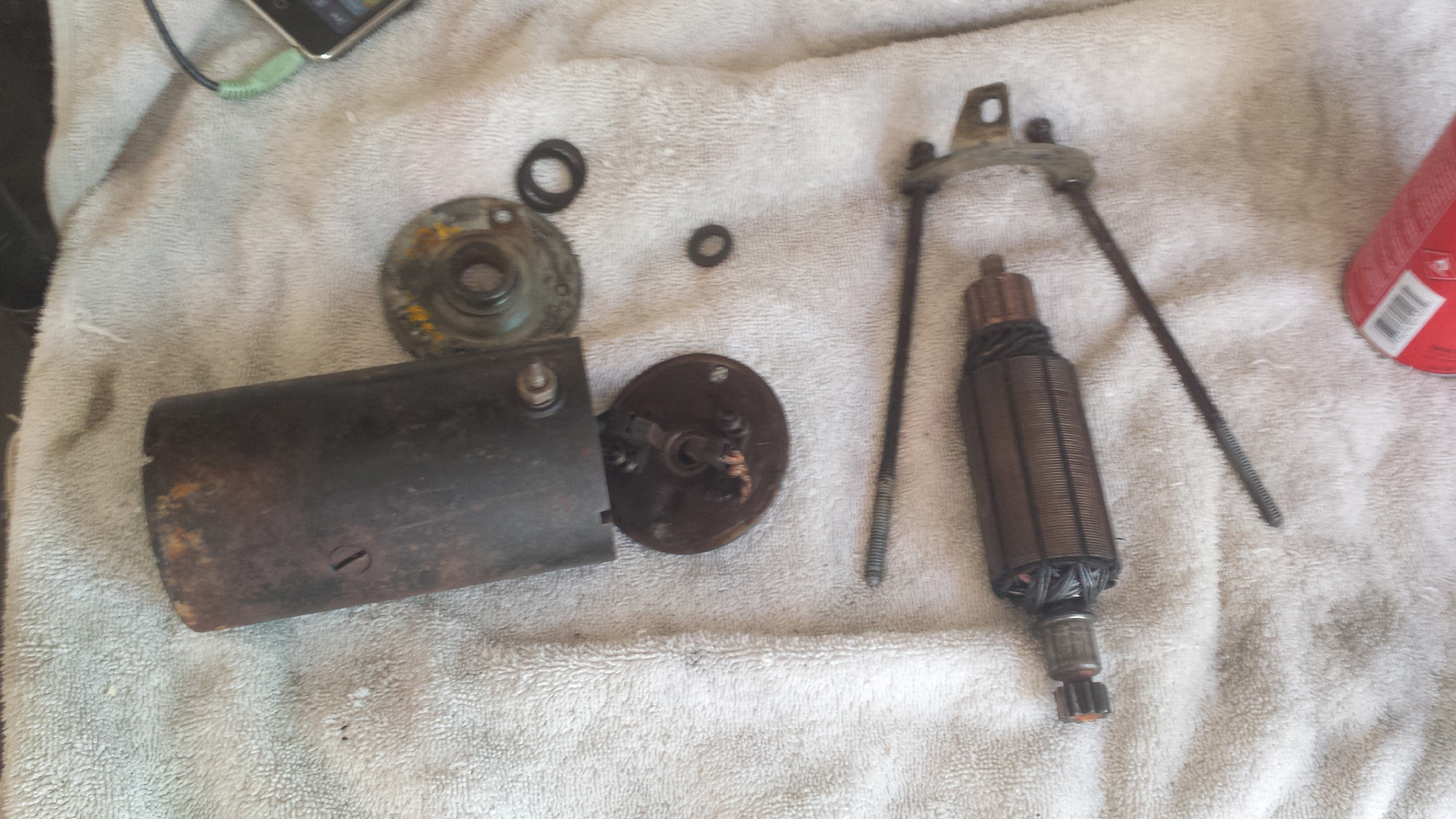

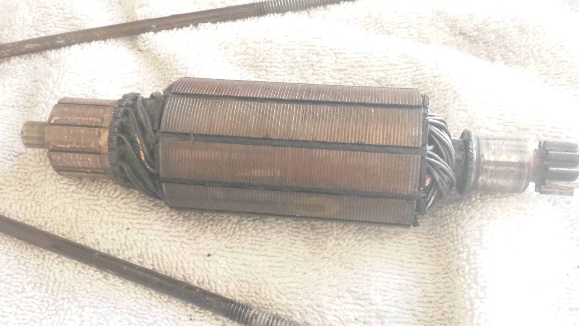

So I took the starter off and low and behold it was crispy inside, lol.
It was toast so I pulled the starter from my project 60hp 67 evinrude, worked great, exactly the same, what luck!

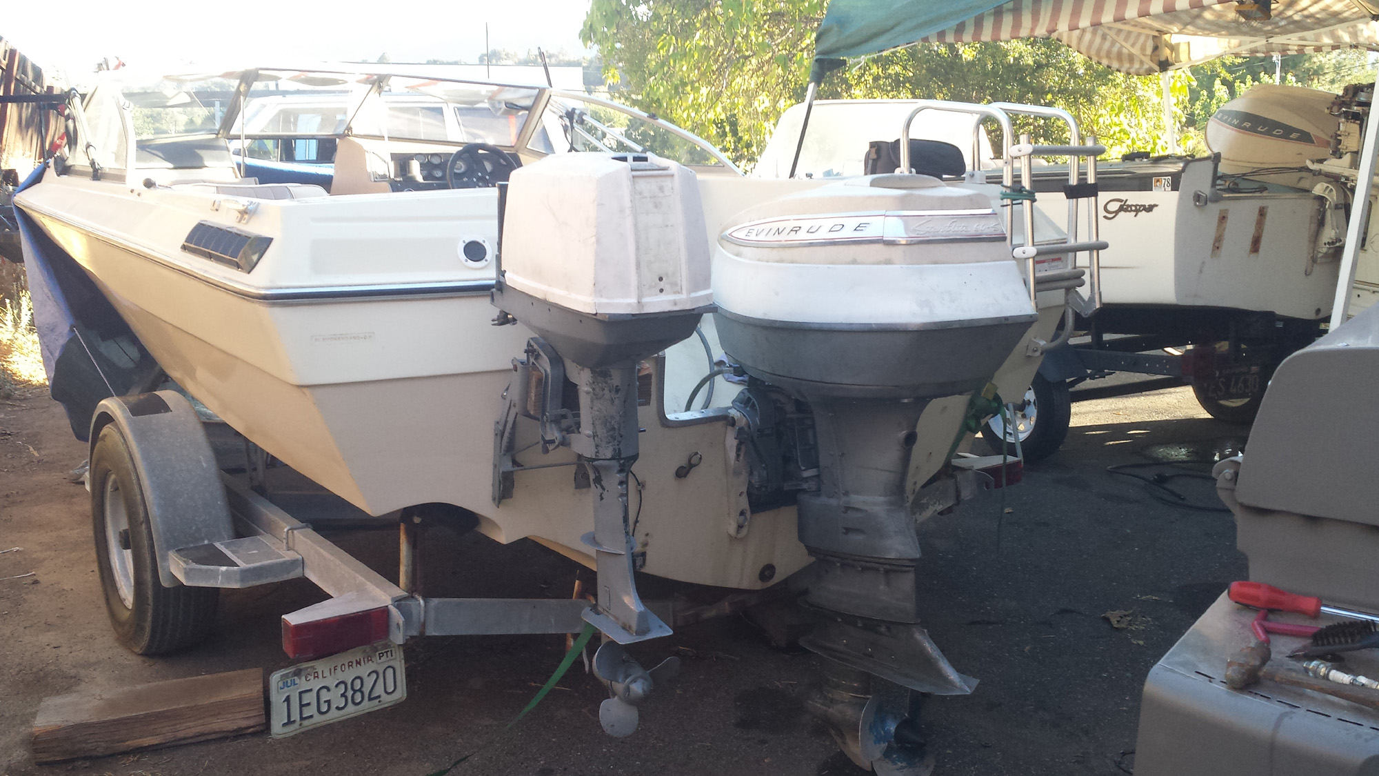

As for the fuel issue, apparently I'm missing the fuel filter located in the fuel bowl, running an inline filter for safely for now. I flushed the system out and flushed the lines with air. After hooking everything back up and priming it a couple times it started right up real quick. Might try to take er out tomorrow if I'm able. But this time no more getting towed for me. Another craigslist score and I was able to get a 15hp tiller motor for 40 bucks, I already had a bracket that came off my glasspar.

Brandon, that's great everything fell into place. The inline filter is a good idea, I have one also since being towed. Good score on the motor and lucky fit on the starter. I would keep the old starter on the shelf, from the pic it looks like the brushes are good, springs might be weak from heat if the armature was toasted. spare parts are sometime expensive.
