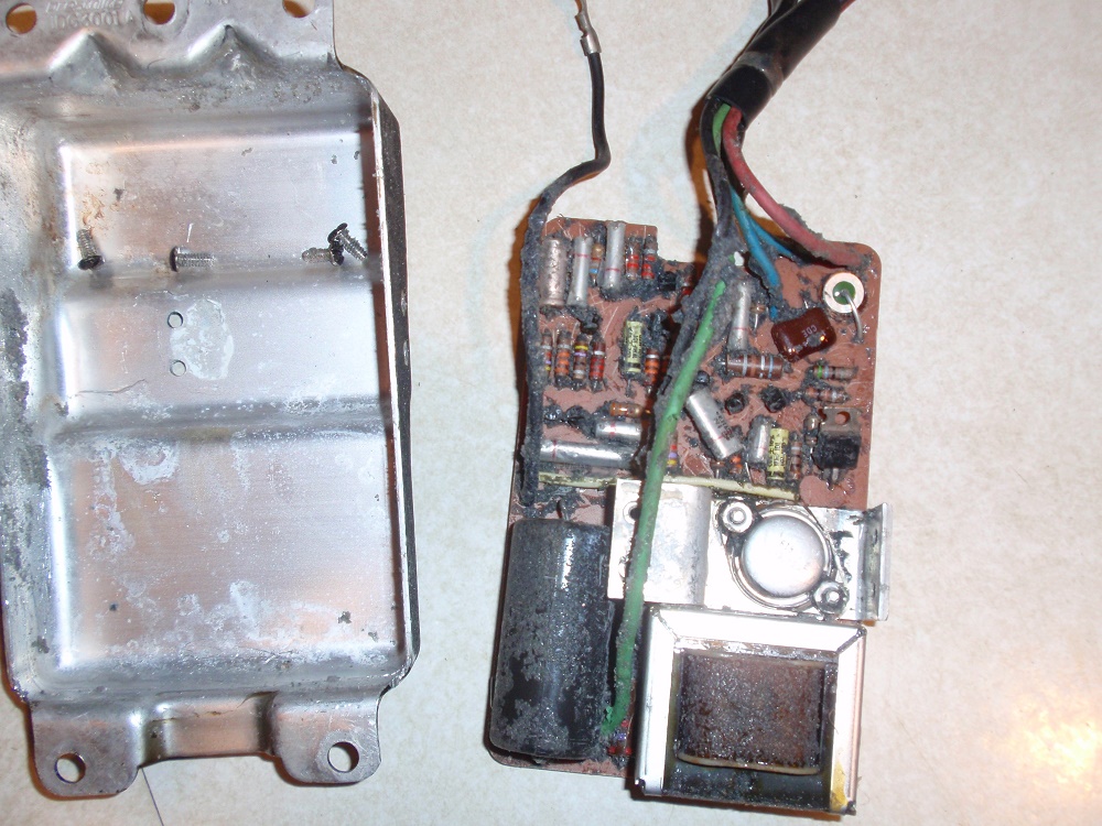

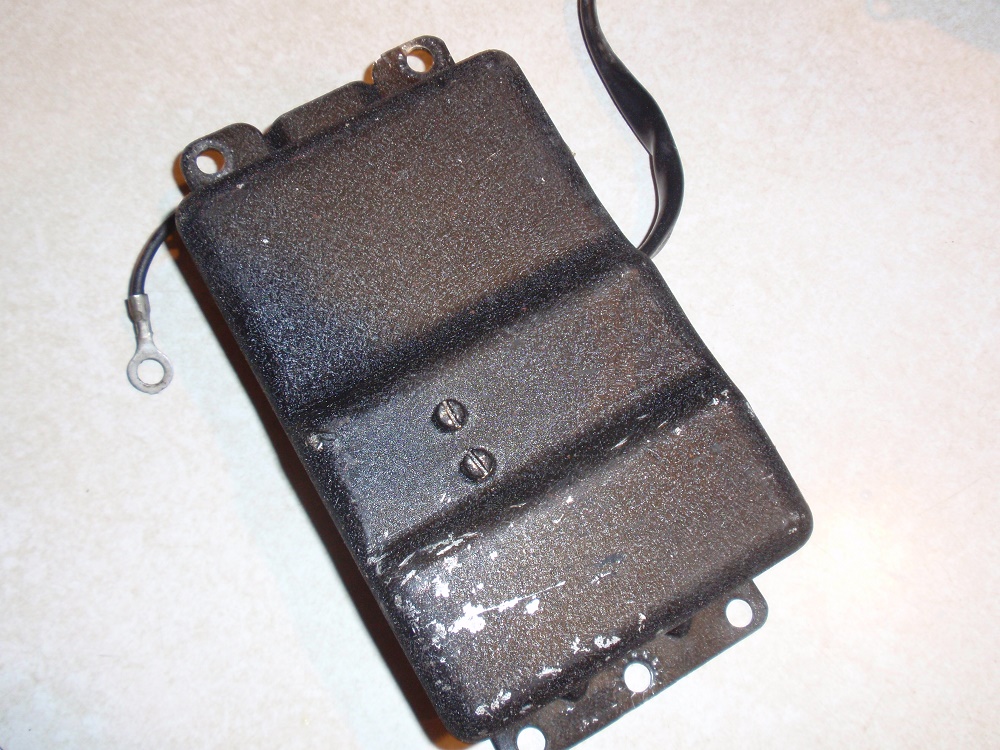

Didja ever wonder what was in that black brain box (CDI) that is the headache of older first gen OMCs?
I finally got around to reverse engineering one that I removed from my '67 100hp Johnson.

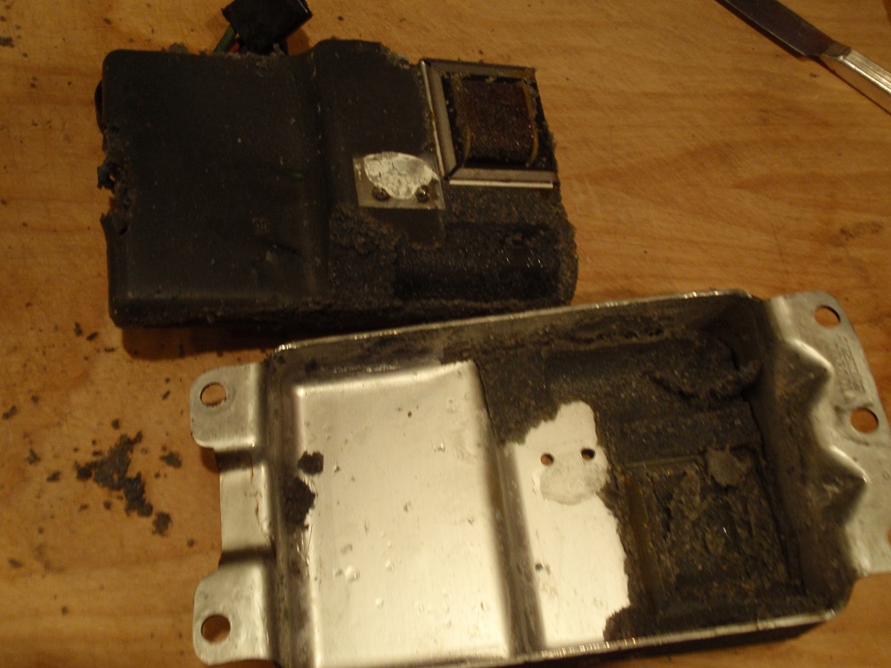

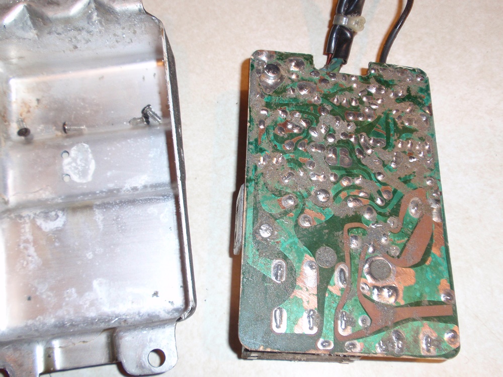

I knew what was inside them, combo of electronics, capacitors, resistors etc. but the way they are packaged makes me suspect failure of these units is due to heat more than anything else. Once assembled the whole unit is filled with a mix of a sandy rubber/silicone probably for vibration prevention and moisture incursion. The back is sealed with the rubbery stuff without the sandy stuff. The mixture sticks to everything and completely seals everything.
Cleaning the gunk was a pain, many hours with a dental pick. I was really looking for something that would jump out at me and tell what failed but no such luck.
Anyone have experience with these units as far as scoping them?
To think that failure of just one of those little buggers can leave you stranded out in the middle of the lake. Sure an glad I converted to a simple coil/point system.
I'm sure today's tech is better, at least I hope it is. As for me, a screwdriver and feeler gauge works :S

I think you answered your own question on this. Recall that these also use a proprietary HV transformer/coil, and those are notorious for failing. The problem with the packs had a lot to do with voltage spikes, and no protection against reverse polarity.
Scoping the board isn't the way to go about it at this point. You need to pull parts and check them with a DVM. Start will all of the semiconductors - check them for shorted / open junctions. They will need to be out of circuit to do this. The electrolytic capacitor at the upper left corner is likely dried out. Capacitors don't age well. The charge capacitor at the lower left is probably leaky and should be replaced as well. All of the capacitors should be checked, as well as all of the resistors. Don't over look all of the small signal transistors (looks like about 6 of them) populating the board. If it were mine - I'd grab a beer and a ball peen hammer and practice my nailing technique on it. I modified mine to use a Pertronix Ignitor, and it works fantastic.
